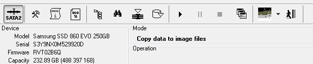

 Post subject: Can data be recovered from a Samsung 860 EVO

Hello, does anyone had any results with this drive? If yes PM me to solve this one too!
P.S As far as i know PC3K has no solution, and chip off solution cannot be done on this SSD because of its encryption.

 Post subject: Re: Can data be recovered from a Samsung 860 EVO
PostPosted: January 10th, 2024, 18:42
Posts: 191
Location: Switzerland
What is the problem ? You get an ID ? Capactity or it just stay BSY ?
If it stay busy the first things to try is to power it and doing nothing wait long time, 12-24 hours to see if it would get ready.
If is doesn't get ready after 12-24 hours you will need to try controller swap.

Posts: 160
I get Id after 5 minutes but when i try to read a sector does a software reset and goes to DRD again
PostPosted: January 13th, 2024, 15:09
Posts: 17256
Can you retrieve the SMART data after it IDs? This will read from the firmware area rather than the user area.
What about running the extended SMART self test? This will cause the drive to read each sector internally, without SATA I/O. I don't know if this is potentially dangerous, though.
PostPosted: January 22nd, 2024, 17:30
Posts: 191
I had a similar case end of 2023. Nothing worked. There's no access and no loader on recent Samsung SSD. Someone point out the crystal/quartz but it didn't help.
