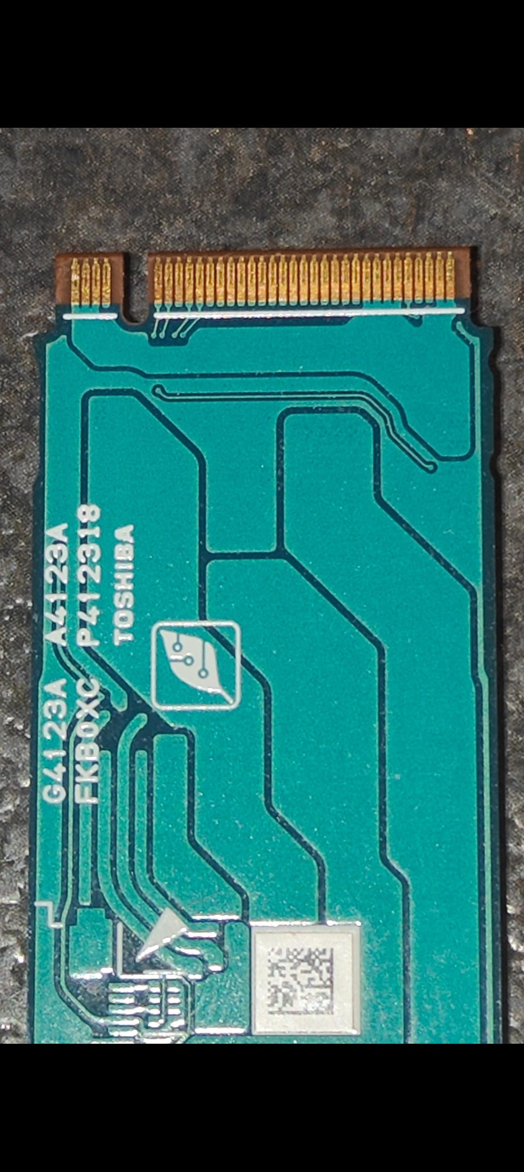

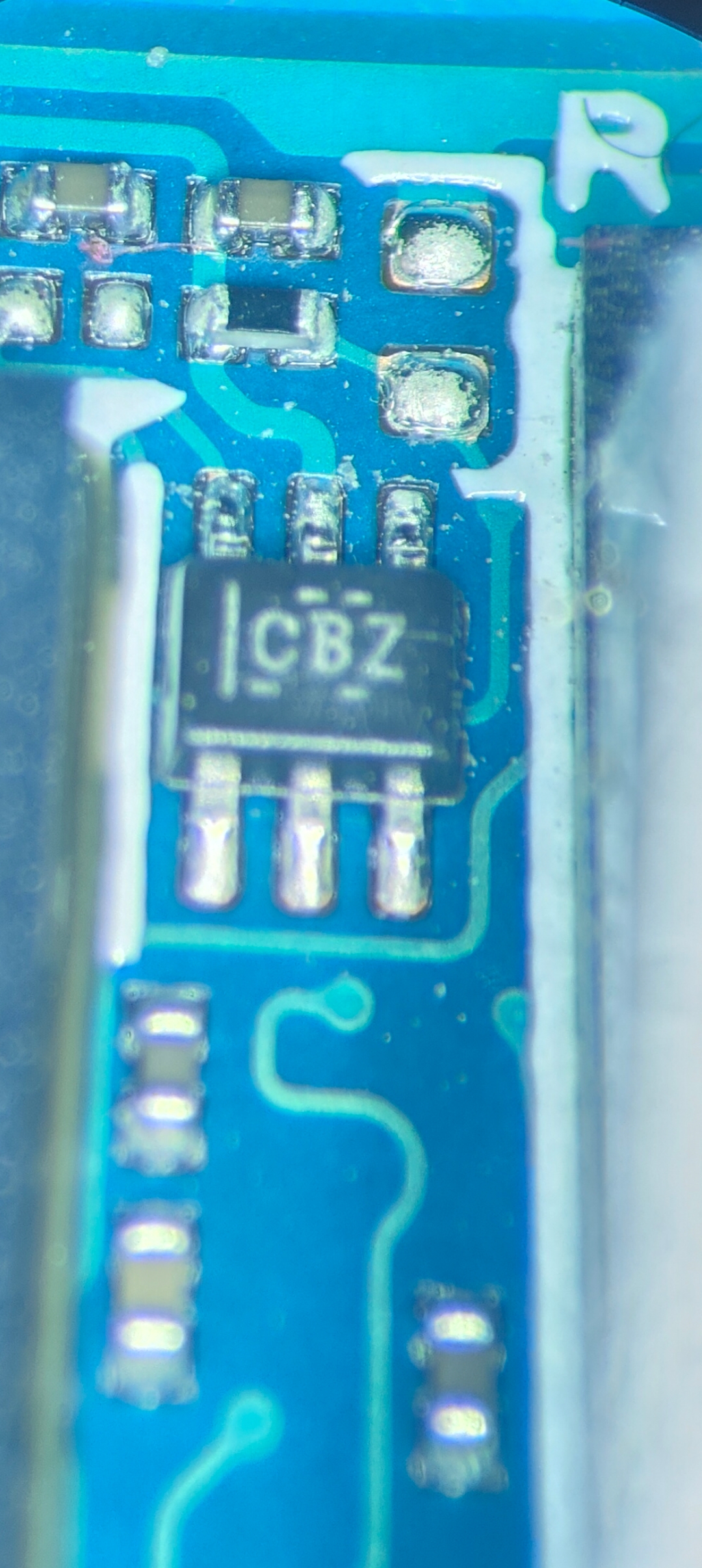

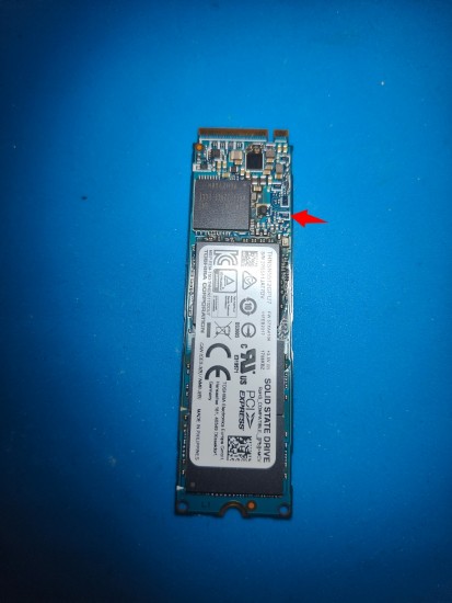

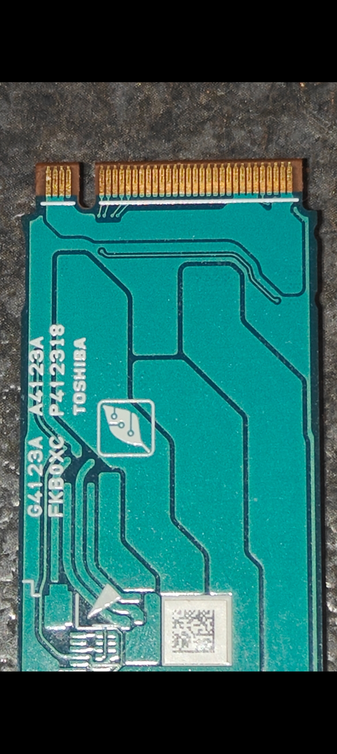

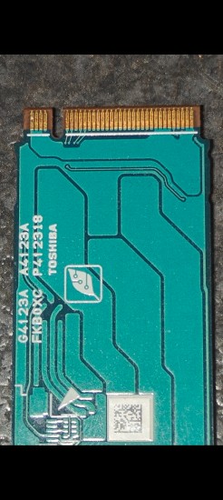

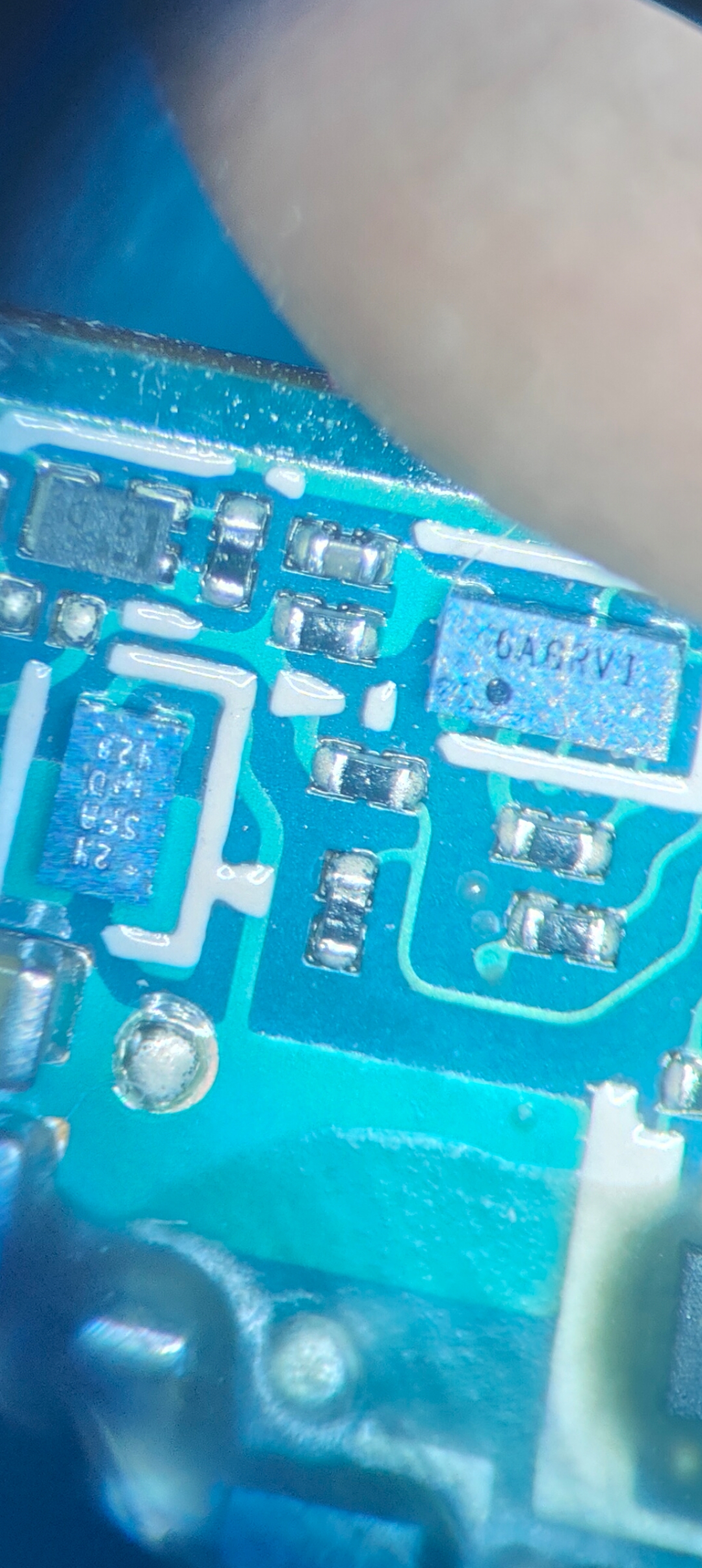

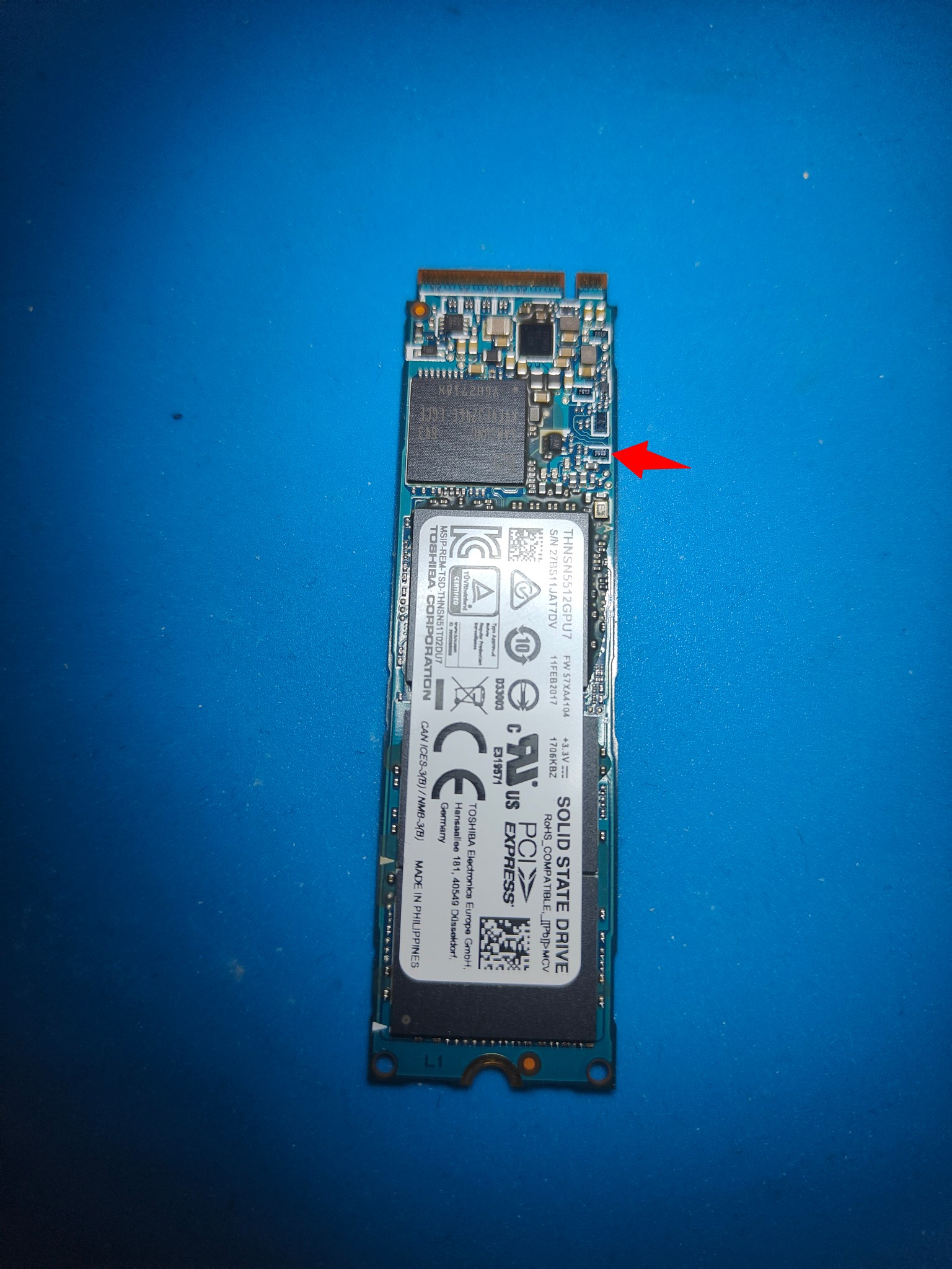

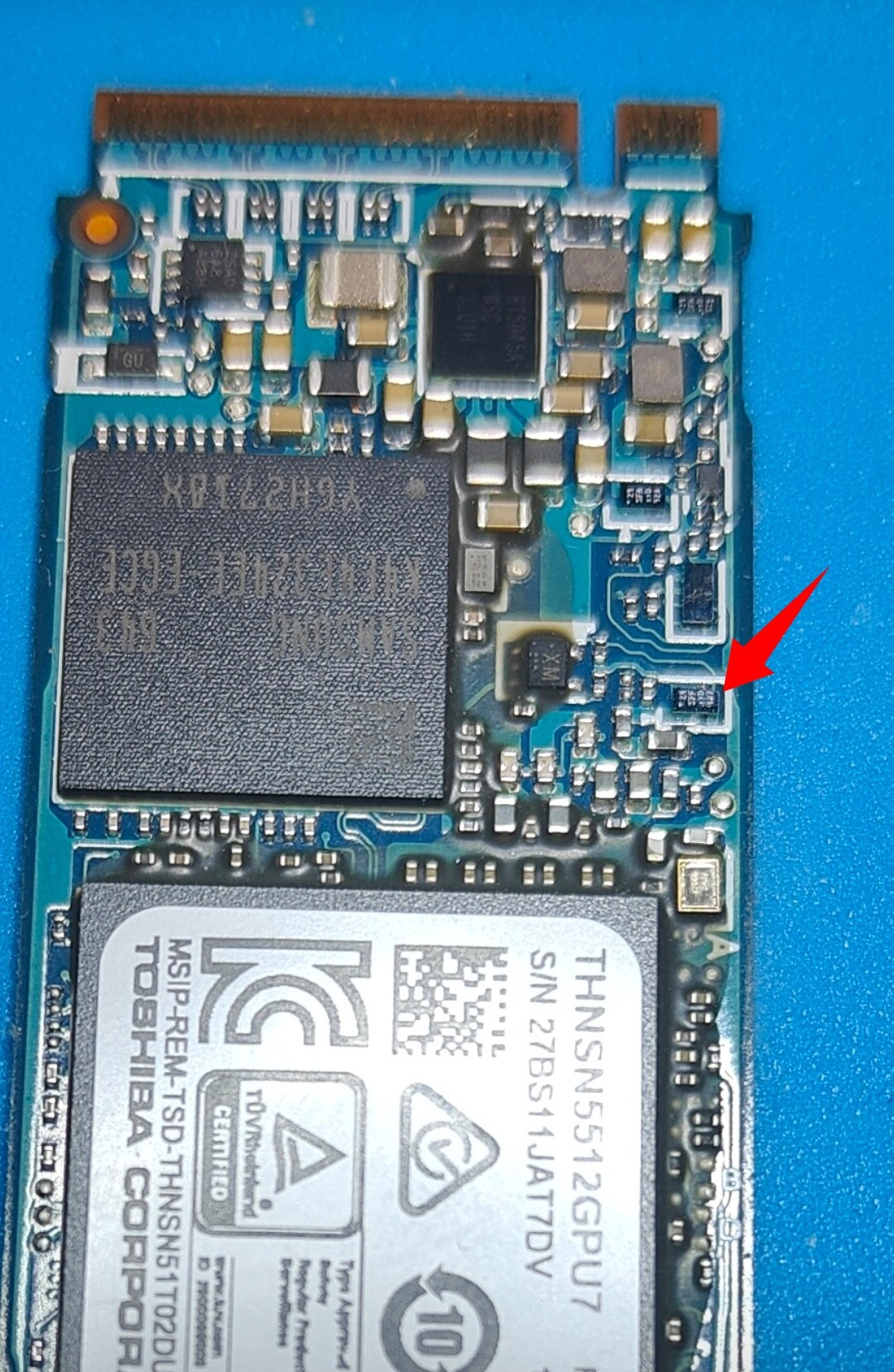

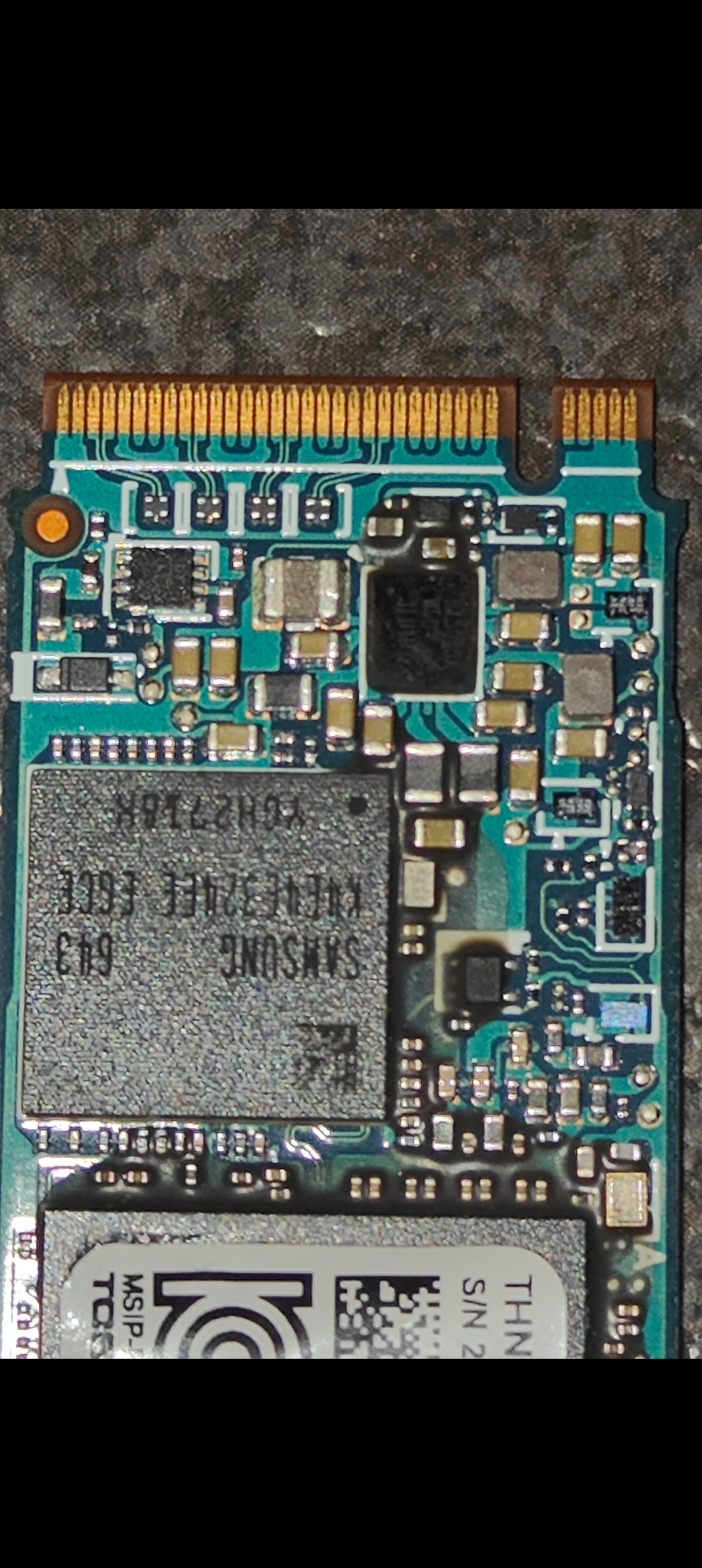

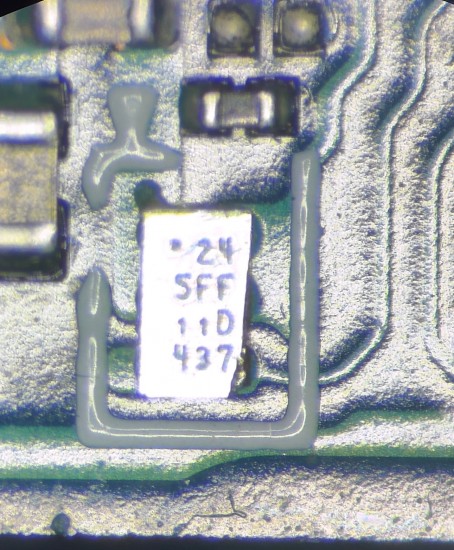

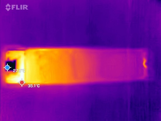

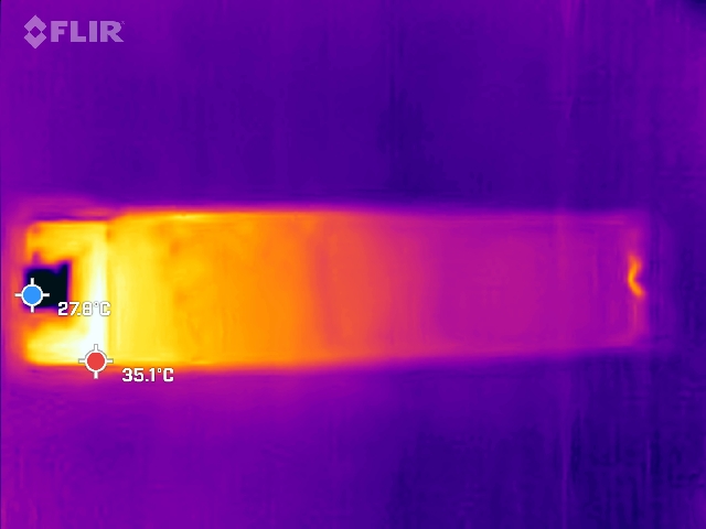

After laptop battery replacement, the ssd is not recognizeble by the bios.
I inserted the ssd drive in a m2 enclosure and nothing shows up.
I measured all the caps, nothing shorted. I found an small ic broken on the side. I also checked the disk with thermal camera and it looks like its dead. I cant measure any voltages at any point.

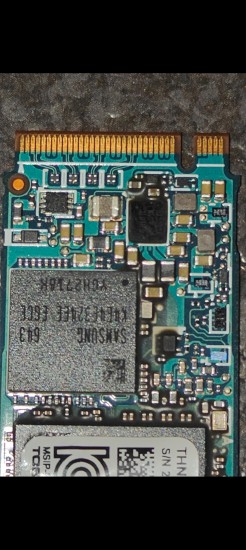

What are the voltages at the input and output of the e-fuse or current-limited load switch?
What are the voltages at each of the inductors adjacent to the PMIC?

Location: Denmark
I have m2 enclosure and testet all the voltages while it was connected to my pc, but i dont found any voltages. I dont understand why it doesnt get any voltages. If i take the m2 and insert my own harddrive kn enclosure, everything works

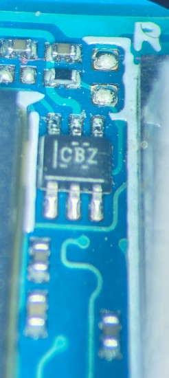

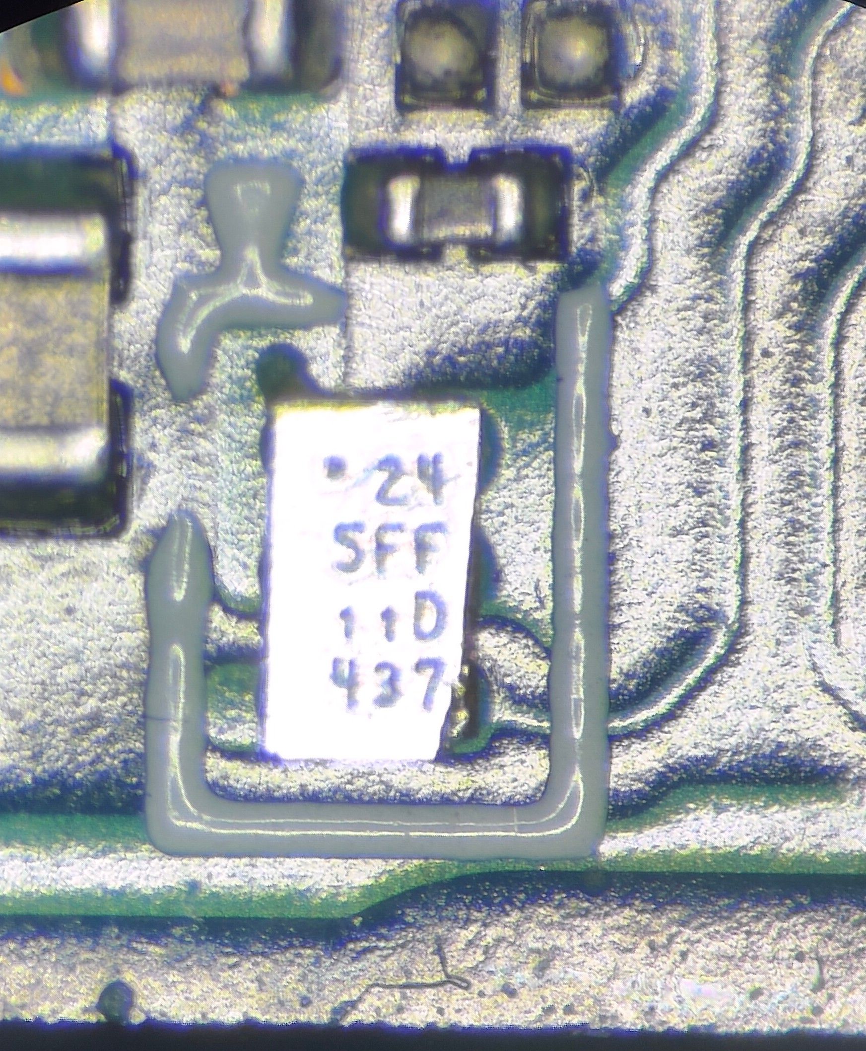

NX5P2924UK, NXP, Logic controlled high-side power switch, 0.8V - 5.5V, 2.5A, 1.2V control logic, marking 24, WLCSP6
https://www.nxp.com/docs/en/data-sheet/NX5P2924.pdf
So, is there are short between ground and the 3.3V input?
https://www.hddoracle.com/viewtopic.php?p=18130#p18130

So you found that broken ic? Wow how? That makes sense since i cant measure anything on components
 Post subject: Re: Toshiba m2 died
PostPosted: December 30th, 2023, 19:49
Posts: 17256
That broken IC probably has nothing to do with the root cause.
Is there a short between 3.3Vin and Ground?

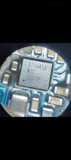

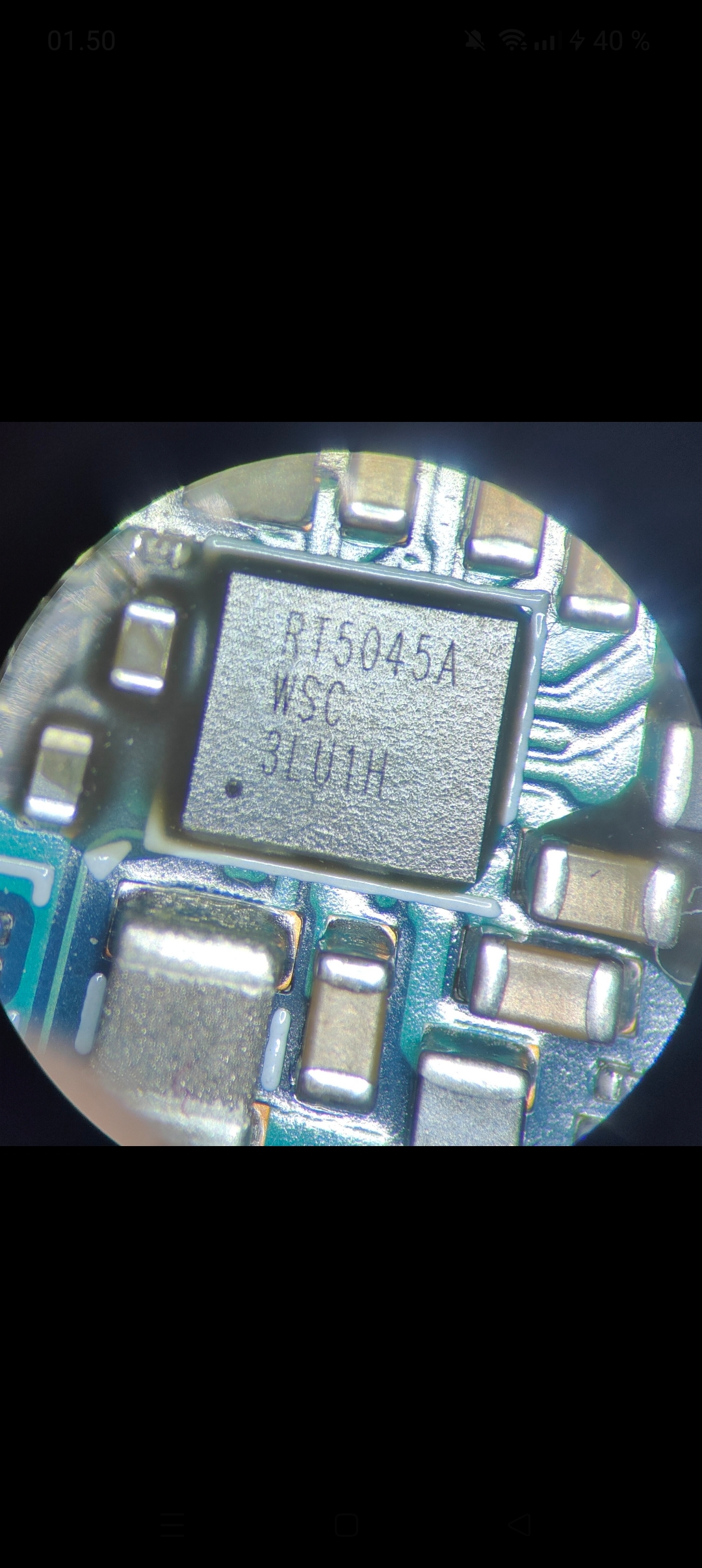

RT5045A, Richtek, Power Management Unit Total Power Solution for SSD, 6x step-down converters, 1x LDO, 2.9V - 5.5Vin, WL-CSP-52B:
https://www.richtek.com/assets/product_file/RT5045A/DS5045A-00.pdf

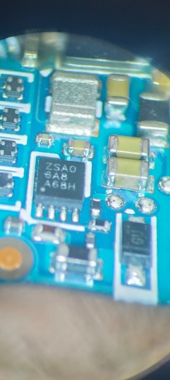

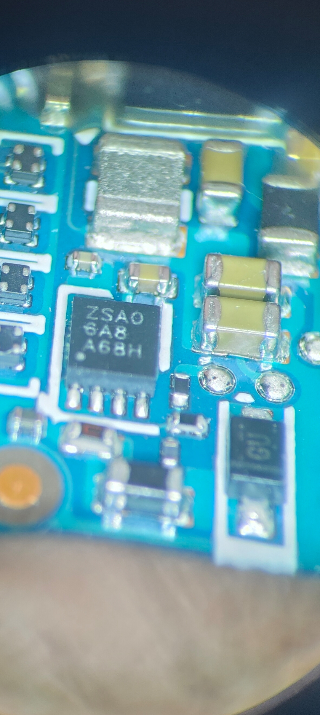

TPS22965, Texas Instruments, 5.7V, 6A, 16mO Load Switch With Adjustable Rise Time and Optional Quick Output Discharge, marking ZSA0, 8-pin:
http://www.ti.com/lit/ds/symlink/tps22965.pdf

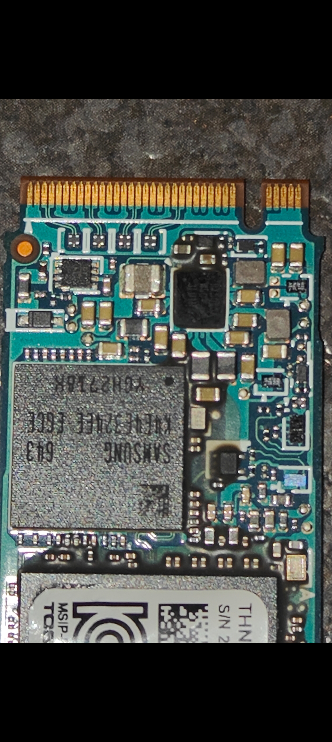

Here are some pic
Screenshot_2023-12-31-01-05-12-88_965bbf4d18d205f782c6b8409c5773a4.jpg [ 1.22 MiB | Viewed 78333 times ]

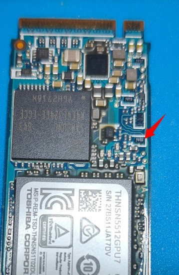

Backside
Screenshot_2023-12-31-01-04-35-25_965bbf4d18d205f782c6b8409c5773a4.jpg [ 1.24 MiB | Viewed 78333 times ]

Picture 1

Picture 2

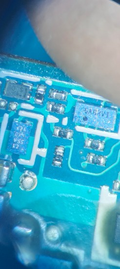

Picture 3

Picture 4
