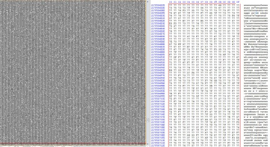

The explanation that pepe described can be nicely illustrated with an example. This is what it looks like in practice with a standard reading. More bit errors than real data.

I'm not surprised I didn't find ECC, if that's what it looks like on a new donor. Does the memory use one of the available RRs for Sandisk or some new ones?
You will get good plots on Sandisk v2 and Sandisk v5 (except last one). But it not help so much.
