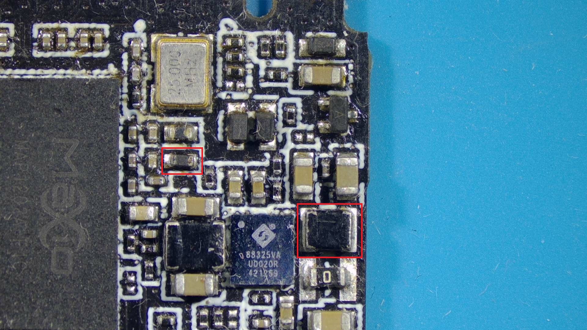

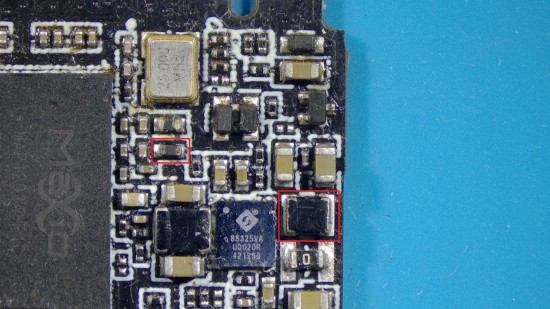

I work as an IT technician at a mid-sized state hospital. About three years ago, we replaced all HDDs with SSDs across our organization. Our systems range from Intel 3rd-generation to 9th-generation platforms, all running Windows 10 64-bit.
Initially, we purchased a number of 128GB TwinMOS SSDs, and they performed very well. Based on that experience, we later purchased over 150 units of the same brand in the 256GB capacity.
Interestingly, the 128GB models have been completely trouble-free, but we are experiencing a very unusual issue with the 256GB drives.
After installation, the SSDs perform normally. However, after approximately four months of use, their performance degrades dramatically—often becoming slower than the HDDs they replaced. The issue affects many systems with different hardware configurations, so I doubt it is related to chipset drivers or a specific platform. I also install all drivers manually rather than relying on Windows Update.
The drives do not show any signs of failure: no bad sectors, no file corruption, and SMART data appears normal. The only symptom is extremely poor performance.
The strange part is that if I perform a low-level wipe/secure erase using tools such as MiniTool Partition Wizard or KillDisk, the SSD immediately returns to its original performance level. After some time, however, the same slowdown eventually reappears.
Managing this issue on more than 100 computers has become a nightmare, and I am running out of ideas.
Has anyone encountered a similar problem with SSDs? Could this be related to firmware, TRIM, garbage collection, overprovisioning, or some other SSD-specific issue?
Any suggestions would be greatly appreciated.
File comment: Front view
File comment: Back view
