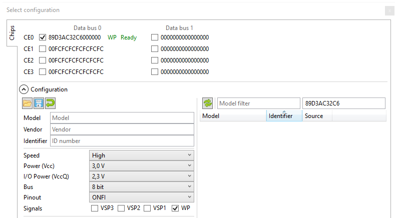

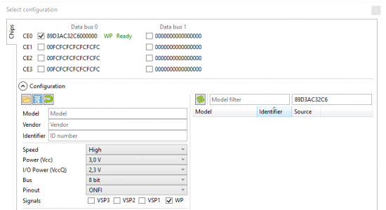

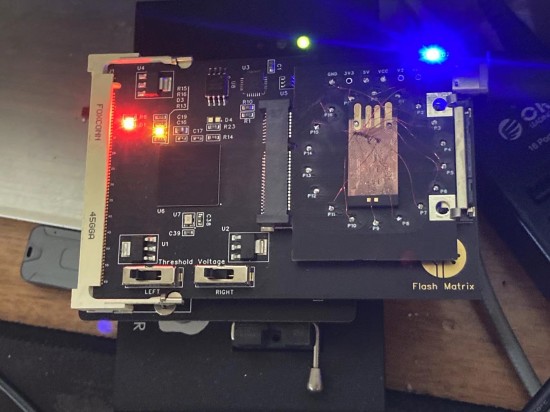

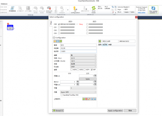

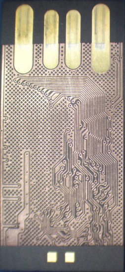

Using FE_NR and 3Kflash, I couldn't read the ID. I believe it's because the chip reading device can't detect the 1.2VCCQ voltage level signal. With VNR and my own developed flash matrix device, I can read the ID but not access the chip. It not only lacks support for 6-byte addressing but also falls short of reading the latest chips, even though VNR performs best in voltage threshold signal detection. I believe ACElab and rusolut should design a completely new reader according to the latest NAND flash industry standards. They have a product ecosystem and designing a new reader shouldn't be difficult for them. I don't have these prerequisites, and even if I were to design an excellent reader, there is no one willing or capable of adapting the data analysis program for the reader.
http://flash-matrix.com/

You have correct ID - that's cool! Do you synchronize reading ID with DQS signal? In normal mode this chip is reading as 32 89 D3 AC 32. Even if we get 6 byte page addressing in VNR and FE there is also a probability that the data reading will most likely need to be synchronized with the DQS signal.
I did not synchronize the reading process with DQS, and the reason I was able to obtain the correct ID number is that I provided the correct VCCQ 1.2 voltage and used a threshold judgment method on the flash matrix device with 1.7V as the high level and 0.9V as the low level. When I adjusted the voltage threshold to 2.5V for high and 1.7V for low, I obtained 32 89 D3 AC 32 as the ID.
Despite my numerous attempts, these efforts were unable to perfectly solve the existing issues with the current reader. Therefore, this is merely a research endeavor.

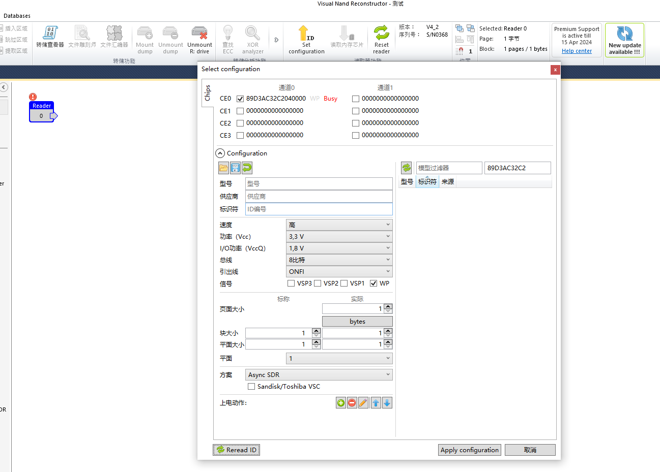

Can confirm this technique with shift of voltage threshold. Voltage measurements on the lines are 3.0V for VCC and 1.45 for VCCQ, so if I set low to 0.8V and high to 2.3V I get 1.5V on VCCQ (2.3V-0.8V=1.5V) and have correct ID. So waiting for 6 byte addressing. csava do you try this technique on P3K ? btw. working on identical UFD monolith chip as you have :)

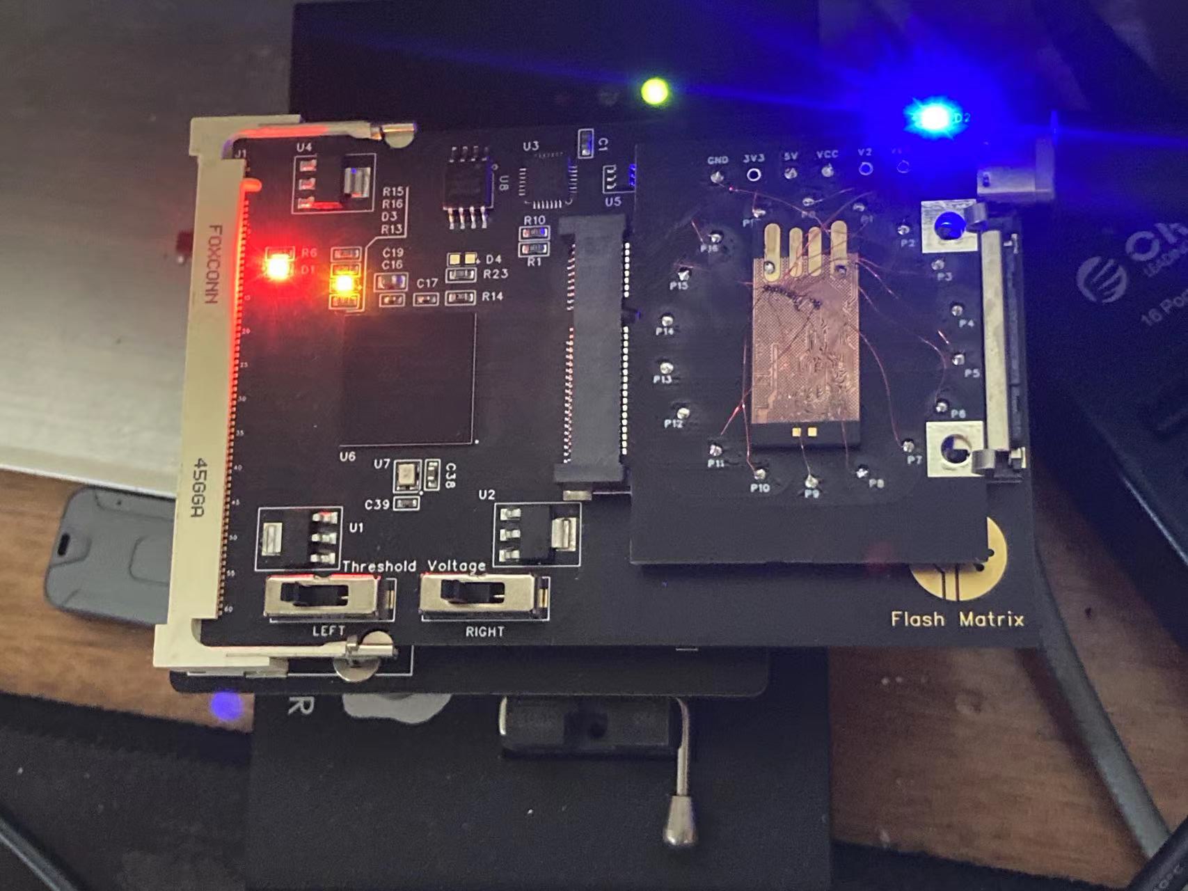

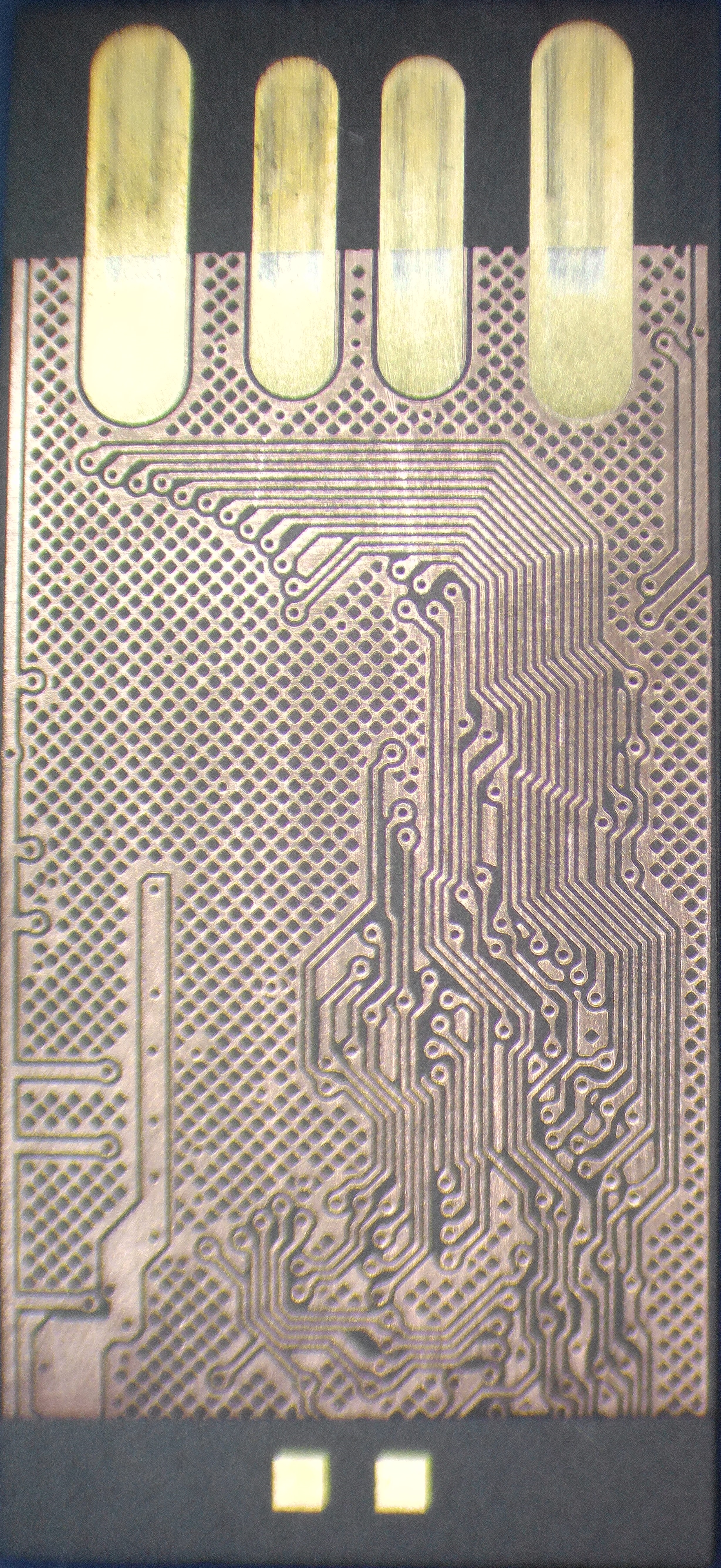

Hello! I used a monolith from my client for testing, and I have returned it. However, I have a similar BGA132 chip that I can test. I tried it on the 3K, but it couldn't return an ID. Research priority for the 3K is the lowest because I can't purchase connectors to make my own adapter; that darn DVI-60 connector has been discontinued. This forces me to connect my flash matrix to the back of a multiboard adapter, and the buffers on the adapter degrade the signal quality. I tried removing them and bridging with wires, which noticeably improved the read quality. Even though the 3K is currently capable of reading such chips, it's of no help.
Acelab hasn't added any read retry mode for over two years, which severely hampers the 3K's chip reading capabilities. They've been tirelessly updating their SanDisk assembler for the past five years, but the reality is that most of the SanDisk cases I encounter are handled by FE. It's a joke. I've made some progress with FE in reading such chips, and now I have three methods to read them on FE.
1: I improved the power adapter for FE, and it can now read monoliths. I produced them in small batches, but recently I scrapped them because I couldn't tolerate the drop in read quality after passing through this adapter.
2: Using the flash matrix I designed, but currently, users cannot use them as they haven't undergone final testing.
3: A new idea came to me a few nights ago before going to sleep, which doesn't require any additional converters; only a modification of a part of the original NR circuitry to enable reading of 3.3, 1.8, 1.2VCCQ chips without affecting the read quality. Just now, I cut the traces and modified them as I needed. It looks ugly now, as if a spider made a home on it, but it's working fine. Next, I plan to simplify the circuit modification and design a corresponding modified PCB. Once everything is ready, I will release it.

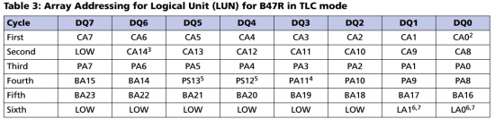

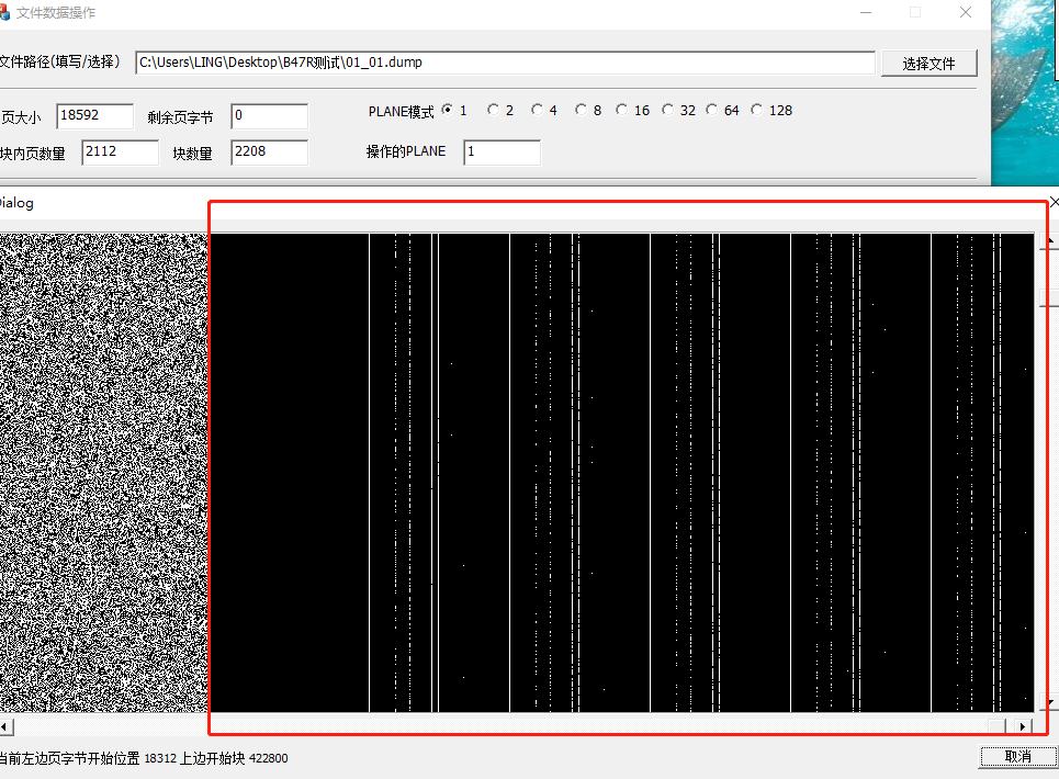

I am already capable of correctly reading chips with 6-byte addressing, such as B37/B47/N38/N48, as well as the latest YMTC chips (all of which utilize 6-byte addressing). The current challenge to address is the "Read Retry" issue. Because current readers operate in asynchronous mode and lack DQS pins, it is assumed that for the same chip, its Read Retry addresses remain consistent. However, due to different operation modes (asynchronous and synchronous), two distinct Read Retry modes are required. Flash memory chips used for manufacturing UFDs typically exhibit poor quality, with data within the write units degrading over a short period. When dealing with such novel storage chips, achieving the Read Retry mode is nearly an indispensable objective.
While testing the B47R chip, I stumbled upon a unique command: 3Bh, which appears to serve as a substitute for the older command DAh (enabling SLC mode).

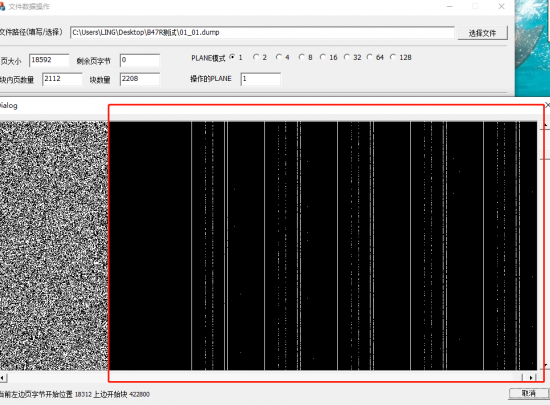

Yes, I have added support for 6-byte addressing to FlashMatrix. However, its operation is based on forwarding reader commands, addresses, and data, and it currently cannot achieve real-time translation. If the addressing method of the reader is not modified, FlashMatrix will still use the old addressing method.

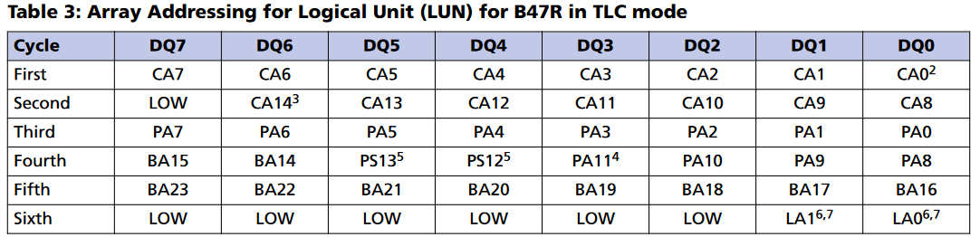

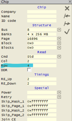

FE Reader support 6 bytes addressing (4 row) but in wrong way, I tested and data was read, but incorrect.
For chip 64GB to 256GB this fourth extra row (sixth in addressing cycle) is always set to LOW (not used) - according to B47R documentation
FE Reader probably shift row addressing to right not to left - when we set Row to 4, so first row address (third in addressing cycle) is always LOW, but LOW should be last one (sixth in addressing cycle).
So if I have some free time I'll try to do this with an FPGA, change the addressing order to get a real-time translation.

6 byte addressing can be implemented in NR, it's just not implemented by Sergey via the NR app.
One of NR's commands is a row counter (3 ALE) and then a jump instruction to increment the counter, simply send an extra ALE command with the row byte set to zero or one before the row counter (3 ALE) command and you have two columns and four rows.

Thanks @jeremyb it makes sense, everything is clear :) Your code add extra row as Row 0 (third in addressing cycle) so is i.e. it behaves like reconfiguring chip Row to 4 in NR. To support 6 byte page addressing just need add this extra row as Row 4 (sixth in addressing cycle) - I think.
it's simple but sad that Sergey won't add it anymore :( Unfortunately, everyone has to fend for themselves.
I think this could work:
   cpu->parse("Addr 0x00 0x00");      // Col 1, 2
   cpu->parse("Addr 0x00 0x00 0x00");   // Row 1, 2, 3
   cpu->parse("Addr 0x00");      // Row 4 - always LOW for chip with one LUN single-die, two-die, four-die package (64GB 128GB 256GB)
I didn't know that the NAND console has such a command as a "Row" or "Jump"
ps. what exactly does the "Row" command do?
