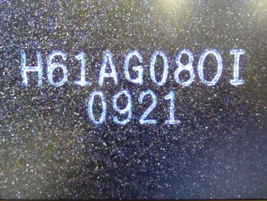

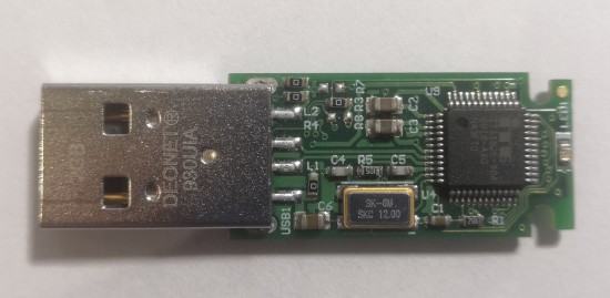

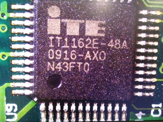

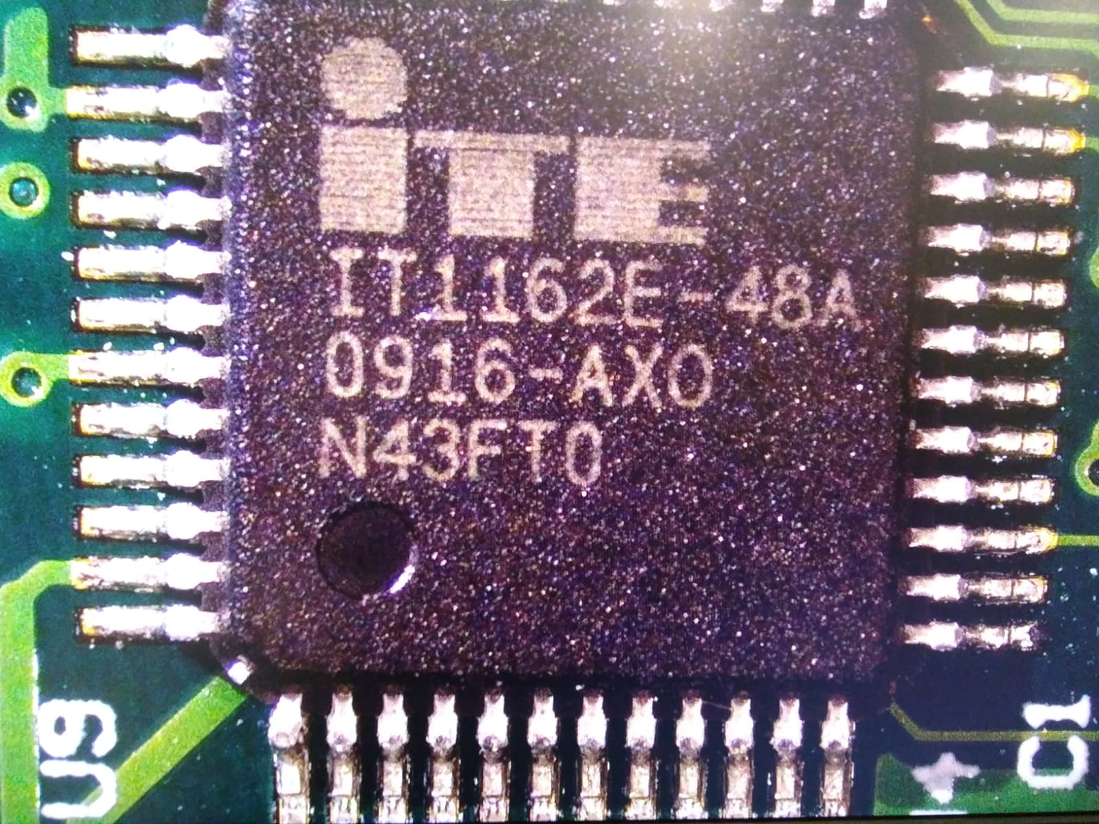

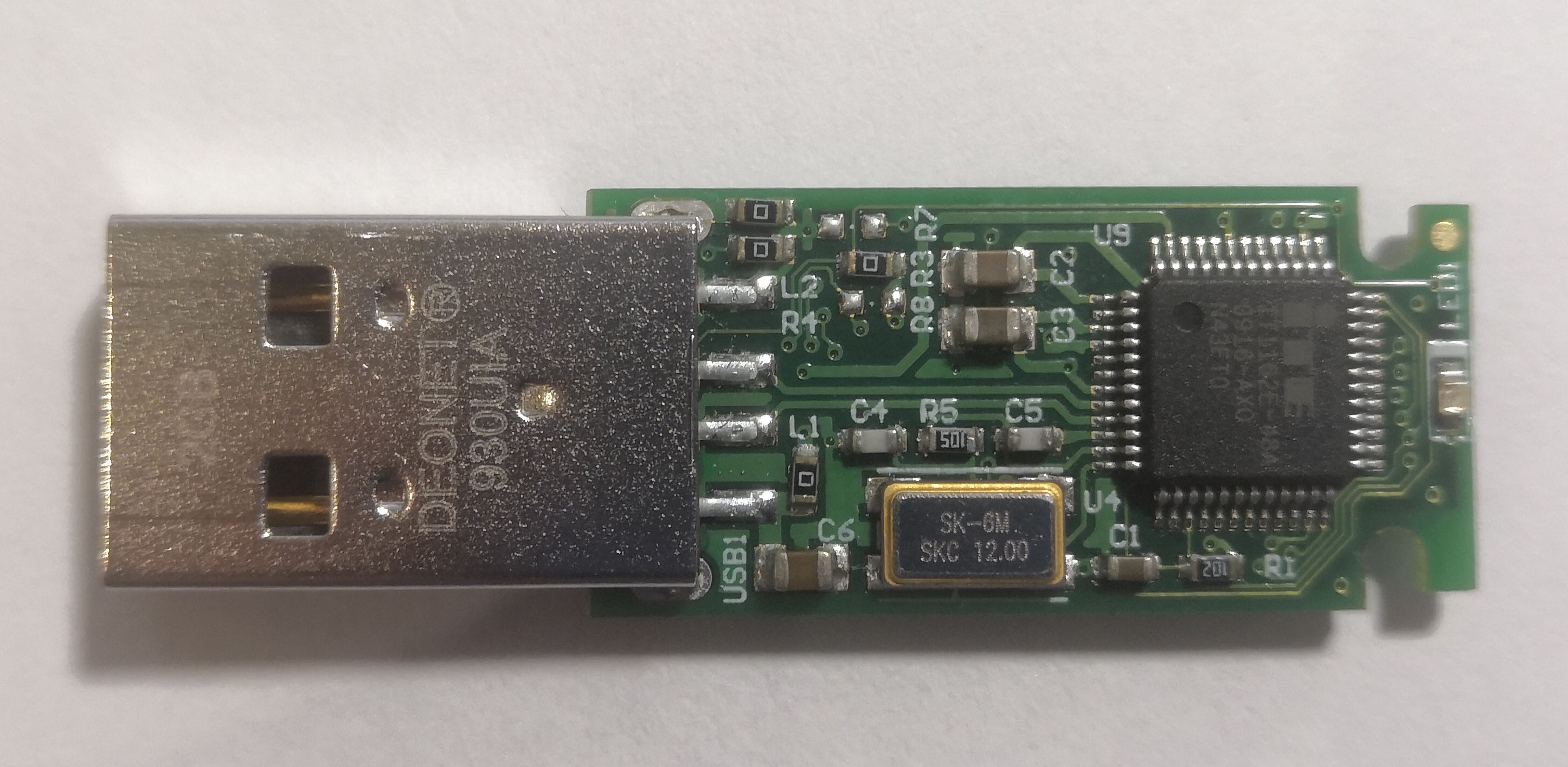

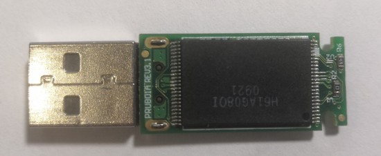

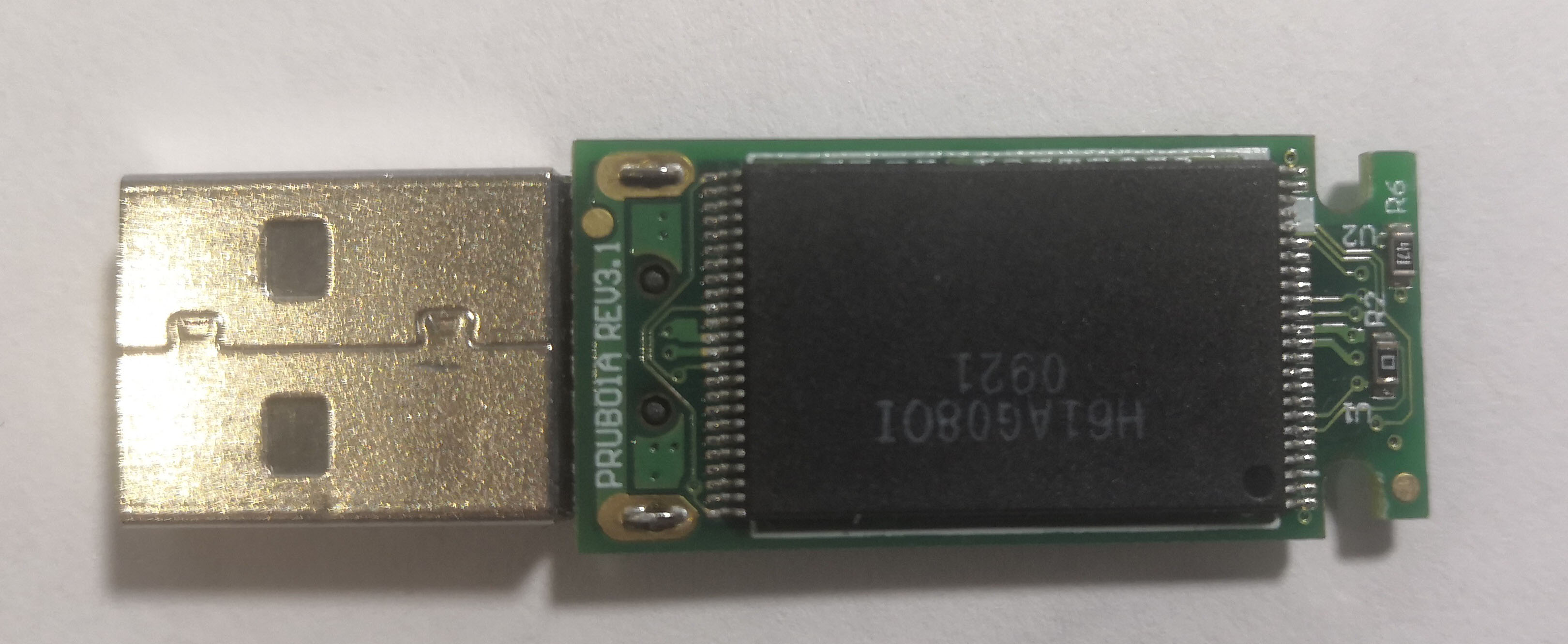

I want to get into data recovery and I have a faulty USB drive here that isn´t recognized by any computer.
It´s a no name drive with i guess 2 GB.
Controller: IT112E48A
NAND: H61AG080I
When the drive is plugged in, nothing happens (also no LED light on pcb). However, the controller gets hot and reaches a temperature of about 38 °C.
I didn´t find any unbond legs on the controller or nand. Also the other components look fine.
I have checked the caps for shorts.
On C3 i am measuring 3.3 V and on C2 1.75 V.
On the NAND i am measuring 3.3 V.
I didn´t find any schematics for the controller so I don´t know, which signal belongs to which pin.

Most likely the firmware has panicked.
Your NAND flash, H61AG08OI, has an ID of 98D5943276.
https://rusolut.com/software-update-23-october-2015/
This is associated with Toshiba 2GB MLC flash.
https://nand.gq/#/searchId?id=98D5943276

Th Flash is likely refurbished Toshiba. Likely only solution is to read nand and use data recovery software to put the image back together. Building a homebrew reader might be tricky, and I would suggest contacting a data recovery lab, it should be straightforward as long as data is on nand and no other issues. IMHO, without DR software, and reader, you will have a year of learning to knock up any kind of home solution, if at all. Unless you strike it lucky and find a fixable issue with PCB, but as voltages dont look to crazy, unlikely

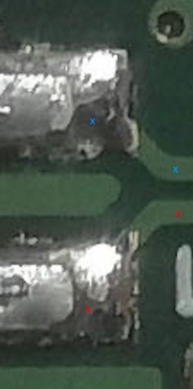

i dont get any signs of recognition on the computer.
Then I assume controller is dead or no connection to it. If you scrape these traces do you get continuity between x's? Can not really judge how this looks from the image. Or just use corresponding pins on controller
 Post subject: Re: USB drive - no power
PostPosted: November 27th, 2023, 18:47
Joined: November 24th, 2023, 14:23
Posts: 12
Location: Austria
Yes, I have continuity between the USB connector contacts and the corresponding controller pins.
