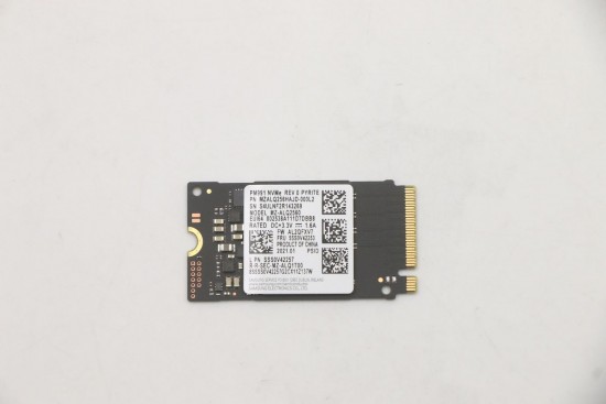

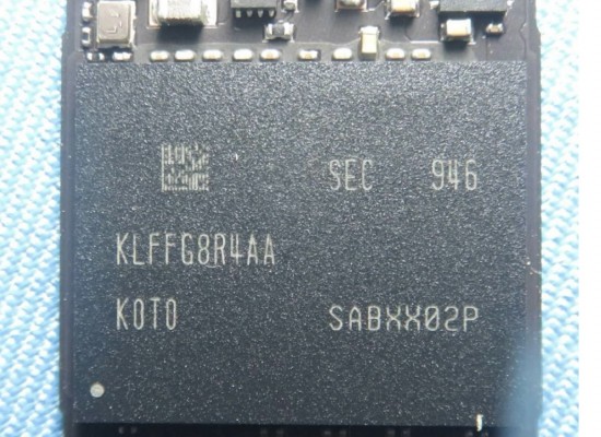

Would chip-off/swapping the NAND to a different board work for the Samsung PM991?
 Post subject: Re: Chip-off/board swap for PM991
PostPosted: February 19th, 2024, 17:22
Posts: 17356
Can you show us a photo of the SSD?
Samsung's photo of the PM991a suggests that this is an SSD-on-a-chip:
https://semiconductor.samsung.com/ssd/pc-ssd/pm991-pm991a/
PostPosted: February 19th, 2024, 17:30
Joined: February 19th, 2024, 12:15

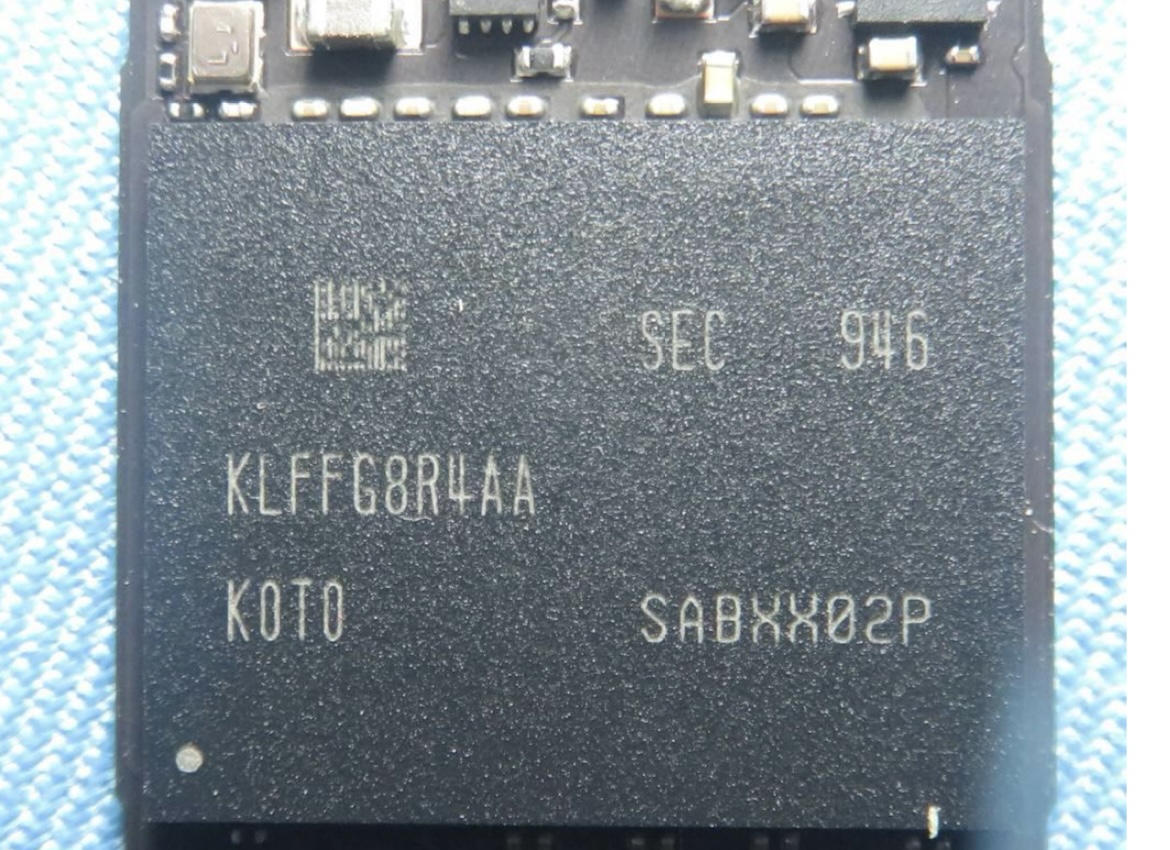

Yeah it’s NVME SSD with BGA Nand
PostPosted: February 19th, 2024, 17:37
Posts: 17356
The photo is unintelligible, but it is in fact a single-chip SSD. That main chip incorporates both NAND and controller, and possibly SDRAM. Transferring this chip to another PCB would achieve nothing, unless there was a fault in one of the external power chips.
If you have a multimeter, and a clearer photo, I could help you identify and measure the power supply test points.
PostPosted: February 19th, 2024, 17:51

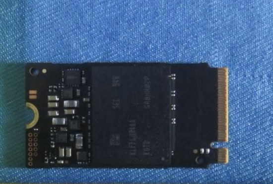

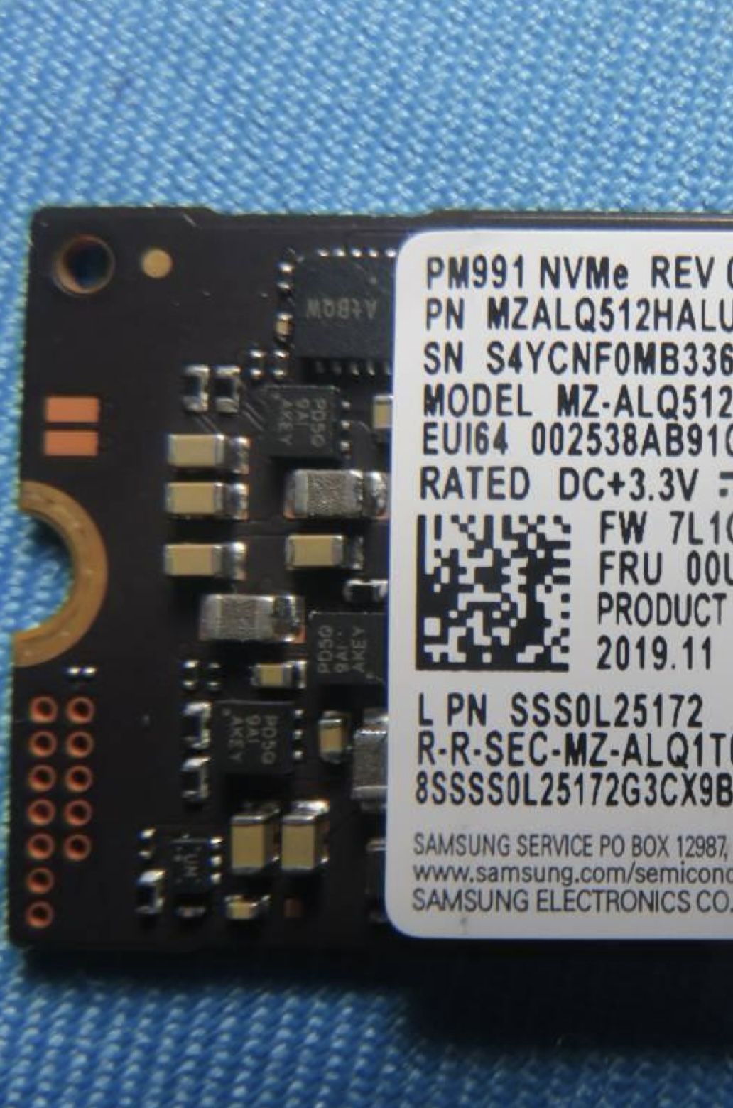

Apologies, don’t have the SSD with me at the moment, only got these photos.
Can you explain a little bit as to why a single-chip SSD doesn’t allow swapping PCBS? Sorry for the questions, just new to this stuff and wanting to learn
PostPosted: February 19th, 2024, 18:02
Posts: 925
For such cases the easiest way is fix PCB (of course if problem is not with FW - mostly it is). Swap is bad idea.
PostPosted: February 19th, 2024, 18:06
Posts: 17356
It would (should) be much easier and safer to repair the PCB, if the problem is external to the IC.
"AtBQW" is an e-fuse. It can be bypassed if it is faulty.
"PD5Q" are step-down converters which can be easily sourced from Mouser, Digikey, Farnell, RS Components, etc.
"UM" is a reset supervisor which can also be easily sourced.
Chip-off in this case is for those people who have zero troubleshooting skills, and there are plenty of those.
