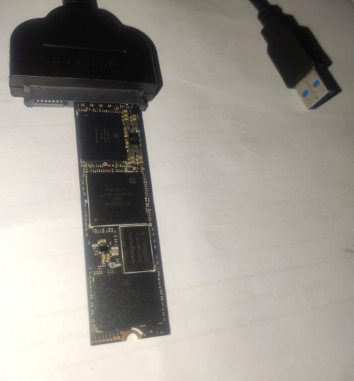

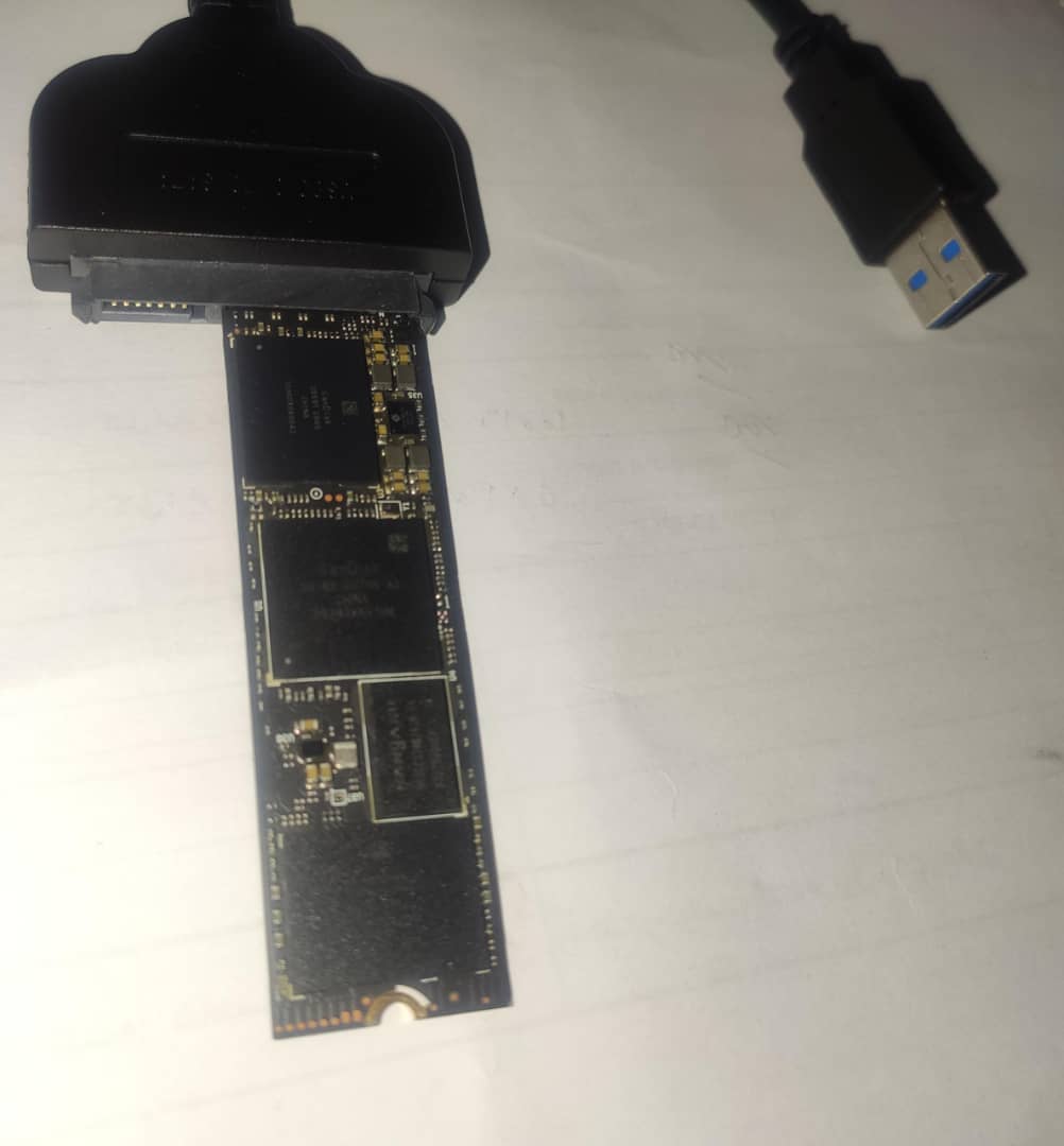

Here is the photo of what I did, of course the usb port was connected and a song of new device connection was heard from the speakers but no device or new storage was shown

You have connected your SSD to the 5V and 12V SATA power pins. :-(((
There are some voltage tests you could if you have a multimeter and proper m.2 adaptor.

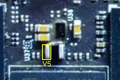

 Post subject: Re: WD Black M.2 SSD unditectable
PostPosted: February 29th, 2024, 12:01
Posts: 17256

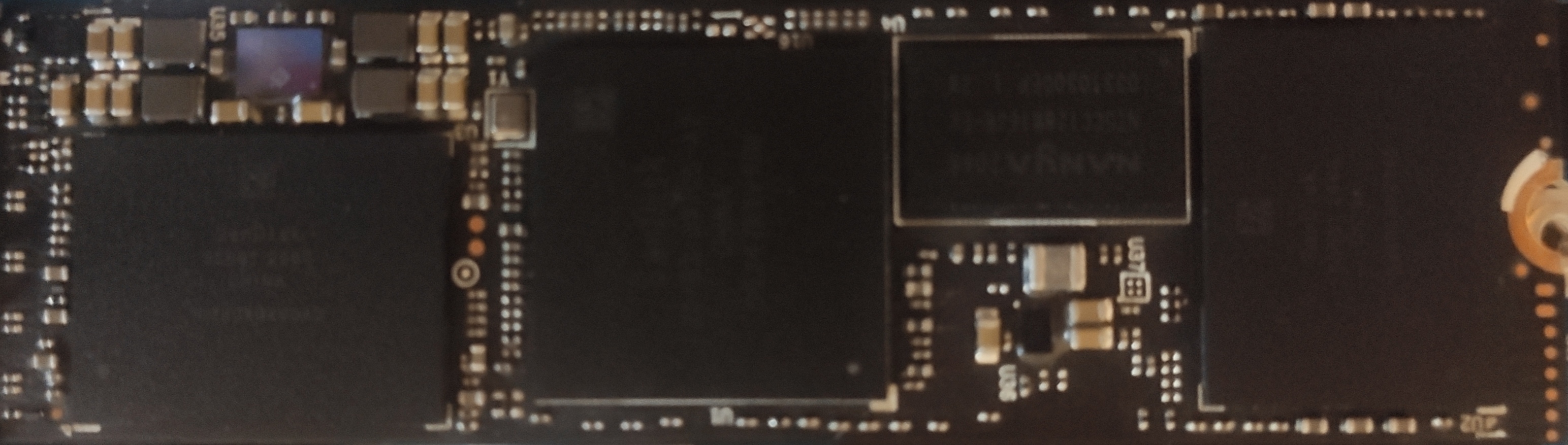

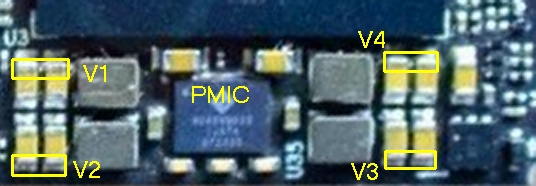

Measure the voltages at V1 - V5. (I don't have a circuit diagram for this SSD)

Here you can see the measured voltages and inductances.
It seems the large inductance is shorted.

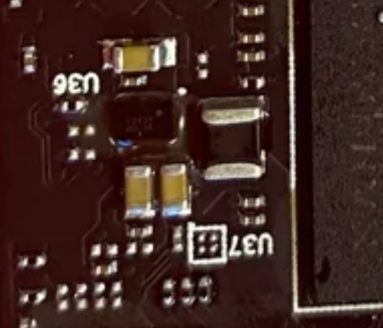

It appears that U36 is dead or not enabled. Also, most of those components you have identified as inductances are capacitors.

Thank you for checking the measurements, your instructive picture showing V1 to V5 was not loaded correctly for me and I saw just my sent pictures instead. After I found out your demanded voltage measurements I checked the voltages at required places and all the five voltages were zero.
PostPosted: March 8th, 2024, 12:15
Posts: 17256
Sorry, I think I may have identified the wrong end of each capacitor for the V1 - V4 supplies. Your measurements indicate that these voltages are OK. It's only V5 which is a problem.

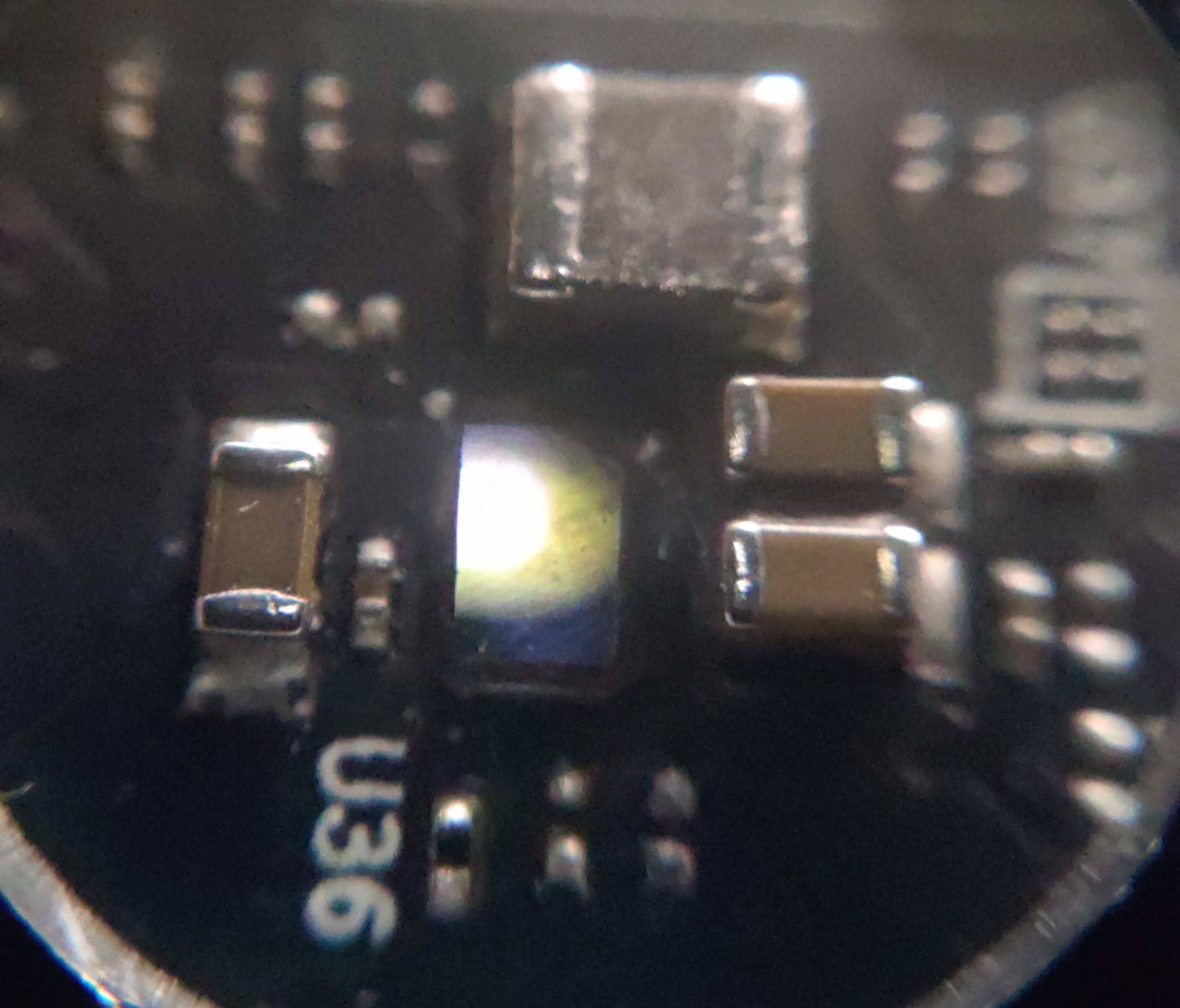

Posts: 17256
Cametolearn wrote:
And any hope to solve V5 problem?

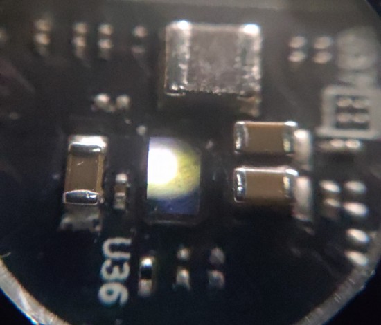

Can you identify the markings on U36? We need to determine whether the IC is faulty, or whether it is not being enabled.

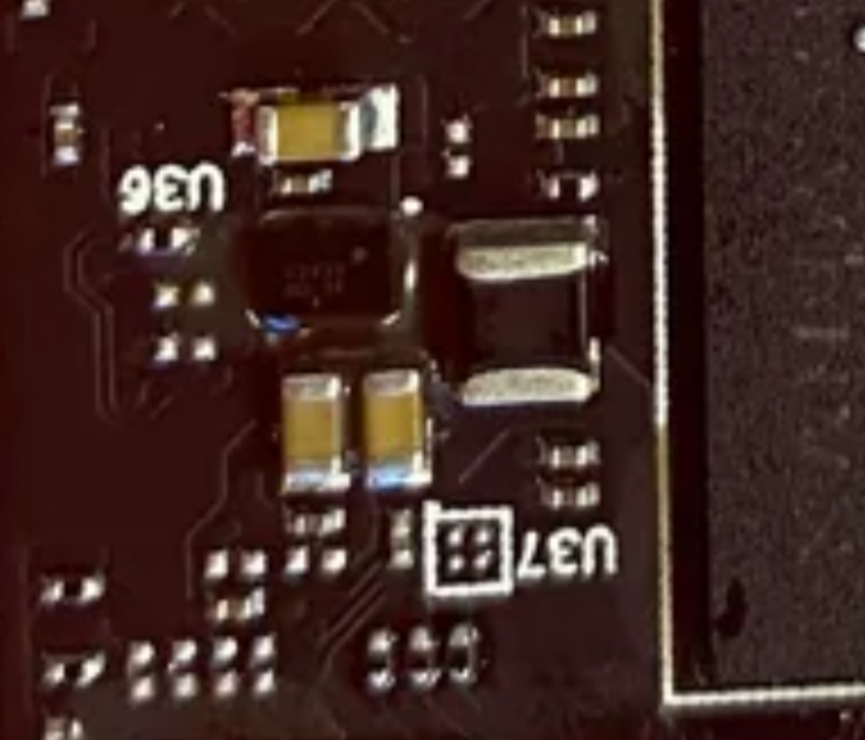

PostPosted: March 14th, 2024, 9:14
Joined: February 27th, 2024, 8:39
Posts: 10
Location: Dubai
The U36 was covered by a black coate which I thought it might be resin but I could remove it by nail scratches and the top of IC is like a mirror without any code or sign.
I attached the photo of this part and a document of SanDisk that may help.
pcsn730-pm.pdf [665.3 KiB]
Downloaded 443 times

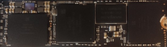

PostPosted: March 22nd, 2024, 16:39
Posts: 10
Location: Dubai
I got a photo of U36 chip marking but it is not clear for me, I Will share it with the hope that somebody can distinguish the chip model.
PostPosted: March 23rd, 2024, 0:27
Posts: 17256
Here are two photos of U36 on an SN750 PCB:
https://tpucdn.com/ssd-specs/images/c/53-front.jpg
https://blogfiles.pstatic.net/MjAxOTA0MDdfMjE4/MDAxNTU0NjExNzU1MjQw.yi9aOFgN78BihagLfhyleSqZlEBs7K1kKJ8yMIhMKOgg.idQ6XeLUM0exvC2npPIoXjhMDdzc7Fbczu9BhSV9gmIg.JPEG.goodboy0505/P1170060.jpg
The part markings are "IjA" and "IjL". This suggests that the last character is a batch code or similar.
Or the marking could be "ijx" or "1jx".
