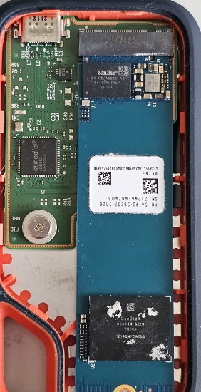

I often had this M2 SSD with the same problem.. its not getting recognized. I often could fix it because the was some optical damage.
But in this case i am not sure how to move on.. can anyone give me some advices?

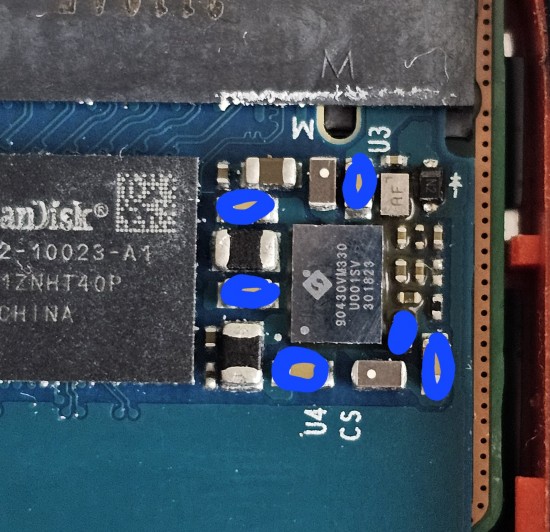

The blue marked caps have 1.89V.. the others dont get anything.
Thank you!
Greetings.

These have PMIC issues - replace it.
 Post subject: Re: M2 SSD not recognized
PostPosted: March 27th, 2024, 6:18
Joined: September 4th, 2019, 2:25
Posts: 64
Location: Germany
Lardman, in this case "90430VM.." right? Thank you!
PostPosted: March 27th, 2024, 6:35
Posts: 1317
Yes - and watch out for the underfill. I think Erkin put a video up on youtube, search his channel.
