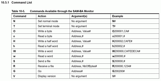

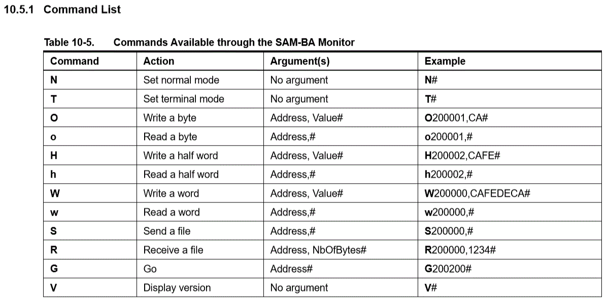

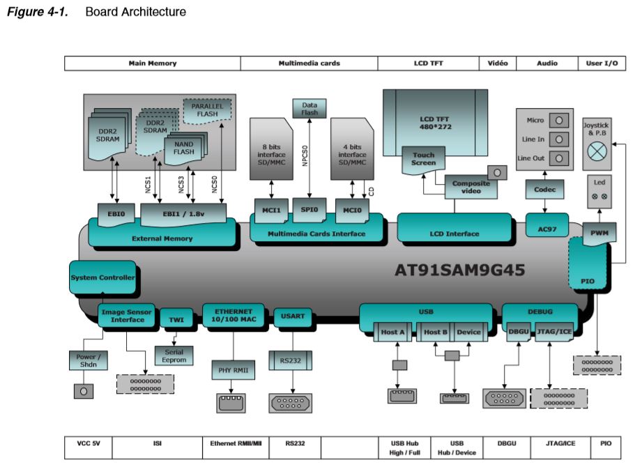

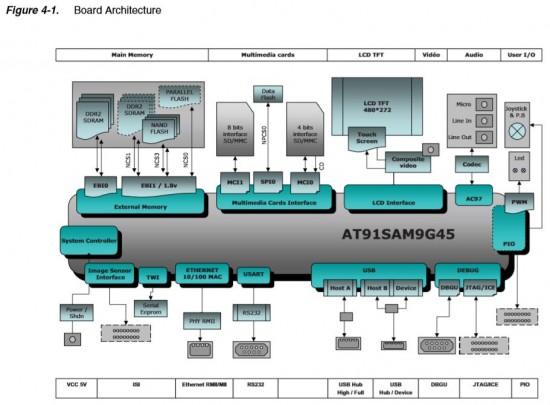

ISTM that a plausible approach would be to use the embedded (?) "SAM-BA Monitor" to dump the NAND flash addresses via the USB or Debug port (see section 10.5 of the SAM9G45 datasheet).
The software appears to be included in the AT91SAM9G45-EKES evaluation kit.
AFAICT, one way to invoke the SAM-BA monitor is to invalidate the NAND flash IC during the POST. A safe way to do this would be to short the NAND's R/B* pin to ground during this time.
WARNING: The monitor commands are Case Sensitive and therefore potentially destructive. For example, uppercase "W" is a Write Word command whereas lowercase "w" is Read Word. Crazy !!!

I don't think this can be done via the SAM-BA which allows to modify any contents in the NAND flash and to patch and inspect any memory location. I have no idea how it's possible to get access to the DDR and SD/SDHC via SAM-BA. May be I'm wrong - but right now I have no idea how to get this done.
Other ways to access the box may be to use the USART or ethernet port (telnet ?) if they are accessible and served by the running OS. I have no idea how to test whether this will work and how to connect.

AISI, this is the block diagram corresponding to the JamMan Stereo:
    2x 512Mbit           AT91SAM9G45 SoC
  2x NT5TU64M8DE-3C  .--------------------------.
      |SDRAM|--------|| 64KB RAM  |             |--|I/O devices|
  |JamMan code|      || 64KB ROM  |             |-----|SDHC|
  |           |------||SAM-BA code| |USB-RS232C||
  | Loop data |      |'-----------' '----------'|
  |       R/B*|---------.                |
                        |                | SAM-BA traffic
4Gbit NAND flash       ===               |
                       GND               |
MT29F4G16ABBDAHC:D                   .--------.  CDC driver
                     temporarily     |USB host|  VID 0x03EB
                     ground R/B*     '--------'  PID 0x6124
                     pin during          |
                     POST to        .-----------.
                     invoke SAM-BA  |  Windows  |
                     monitor        |SAM-BA tool|
The Soc has a mask ROM which enables it to POST and set up the USB port. It also contains the code for the SAM-BA monitor. At the time of manufacture, the NAND flash is vacant
During the post, the SoC looks for boot devices. If it doesn't find any, it invokes its SAM-BA monitor and waits for commands from the USB-serial device. The designer then uploads his application code (eg JamMan) into block #0 of the NAND flash memory using an appropriate SAM-BA tool. He could alternatively use the SAM-BA commands directly, but the tool makes this a lot easier and safer. Block #0 is guaranteed to be good by the NAND manufacturer. The remainder of the NAND is used to stored the guitar loops.
AISI, you need to temporarily ground the NAND's Ready/Busy* pin during the POST in order to invalidate it. The SoC is then unable to find a boot device, which then causes it to invoke its SAM-BA monitor. AFAICT, you should be able to confirm that SAM-BA is active by typing "V" (Display Version) via a terminal program such as PuTTY or HyperTerminal.
If you get this far, then you should be able to read and write to NAND flash. You may need to configure the address spaces first, though.
As for the OS, ISTM that this is transparent and therefore irrelevant.
I should add that R/B* should only be grounded until the monitor is active. It should then be released from ground.
Once again, I think that the AT91 forum is a much better place for support. I would at least ask for confirmation from one of their engineers before proceeding with my suggestions.
