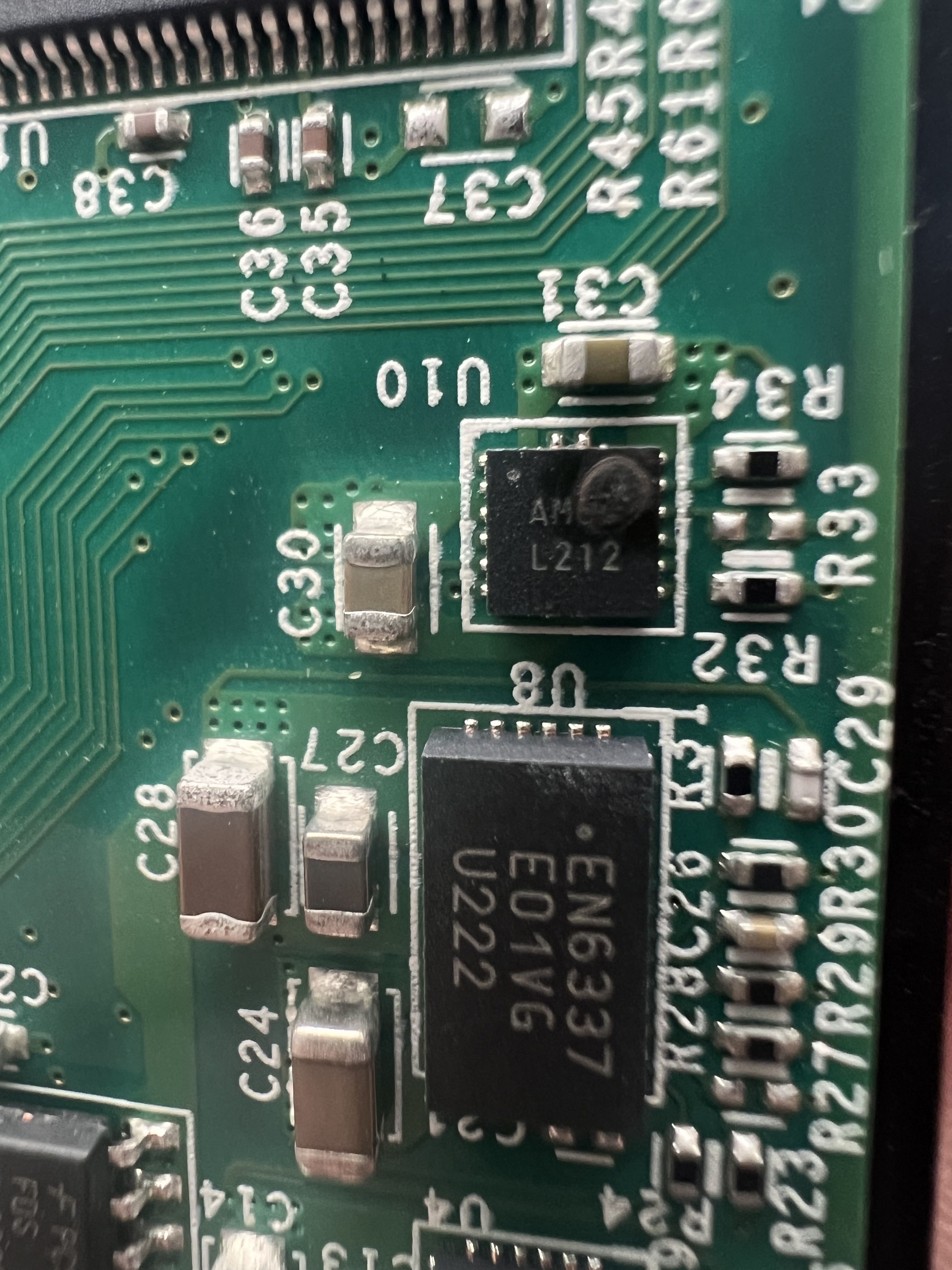

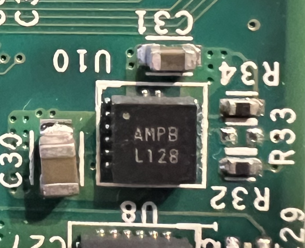

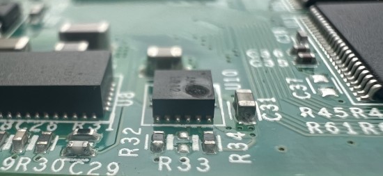

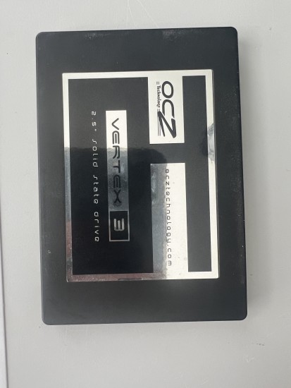

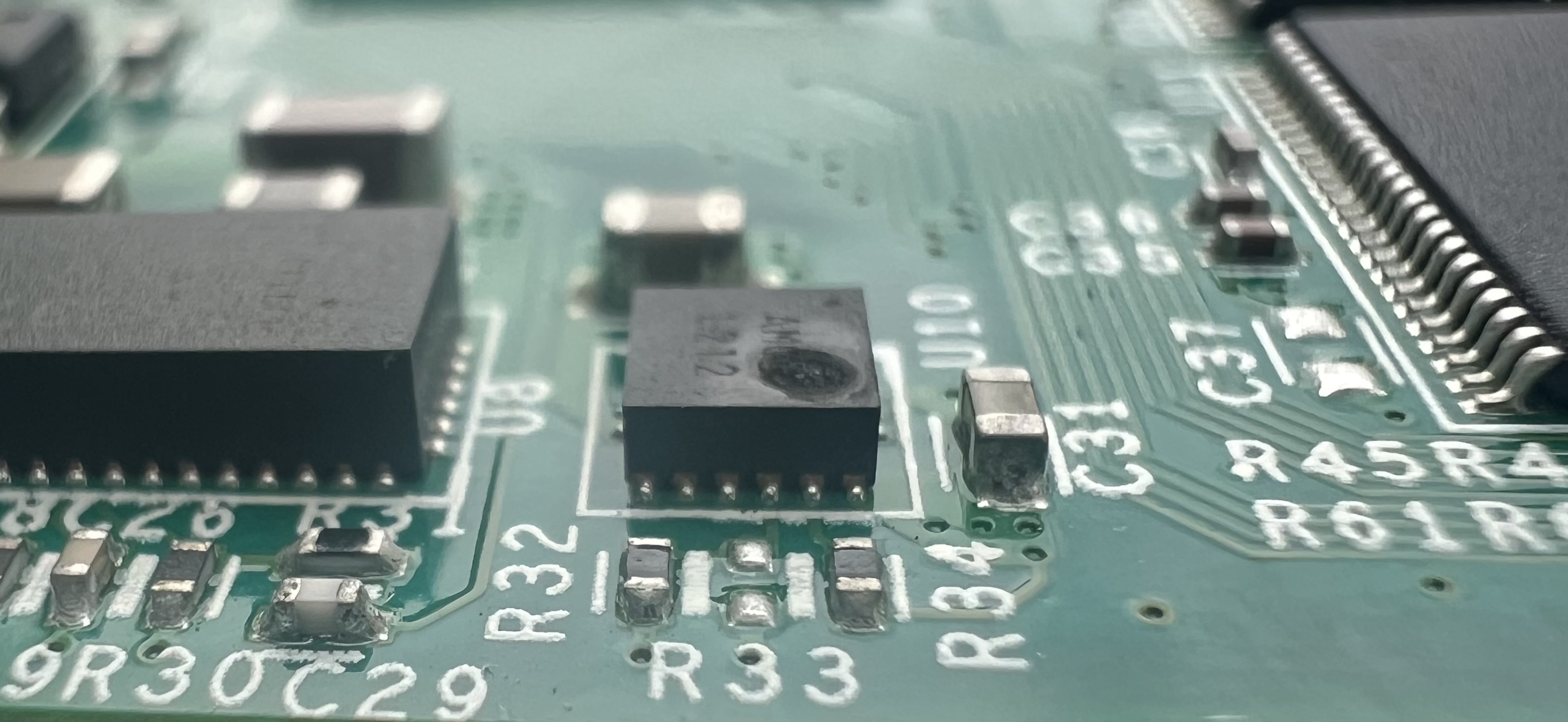

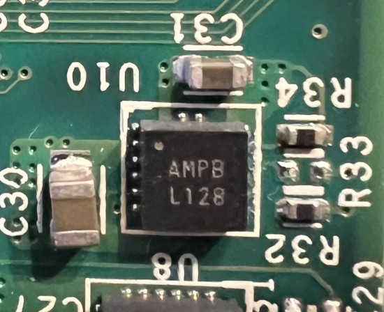

I'm currently trying to diagnose several HDDs and SSDs that experienced a power surge in the same PC. Physical inspection shows an obvious issue, the chip in the U10 spot (labeled AMPB L128) is dead with a hole in the top. Inspection under a thermal camera shows the chip heating up fast when power is supplied. I've also purchased an identical drive for comparison/harvesting, the same chip on the good drive does not get hot like the bad chip. My questions are:
1. Does anyone know what the U10 chip is/contains (or have a diagram of this SSD with details on the chip)?
2. Can I swap in the good chip?
I scoured the internet for info on the U10 AMPB L128 chip but have not found anything useful so far.
I've attached images of the donor drive and the U10 chip for reference.
Thanks in advance for any help.
File comment: Donor Drive PCB U10 Chip
File comment: Donor Drive PCB Image

"128" would most likely be a YWW date code, ie week 28 of 2011.
If you measure the voltages on C30 and C31 on your donor PCB, that should help us to identify the function of U10. For example, they could be the filter caps for Vin (5V) and Vout. That would then suggest that the part is a converter, either linear or switchmode (with on-chip inductor).
 Post subject: Re: OCZ Vertex 3 120GB SSD Repair - U10 Chip Burnt Out
PostPosted: March 31st, 2024, 3:07
Posts: 17256
EP53A8HQI, Enpirion, Synchronous Buck Regulator with Integrated Inductor, 1A, 2.4V - 5.5Vin, marking AMxx, QFN-16:
https://www.farnell.com/datasheets/1525815.pdf
PostPosted: March 31st, 2024, 4:31

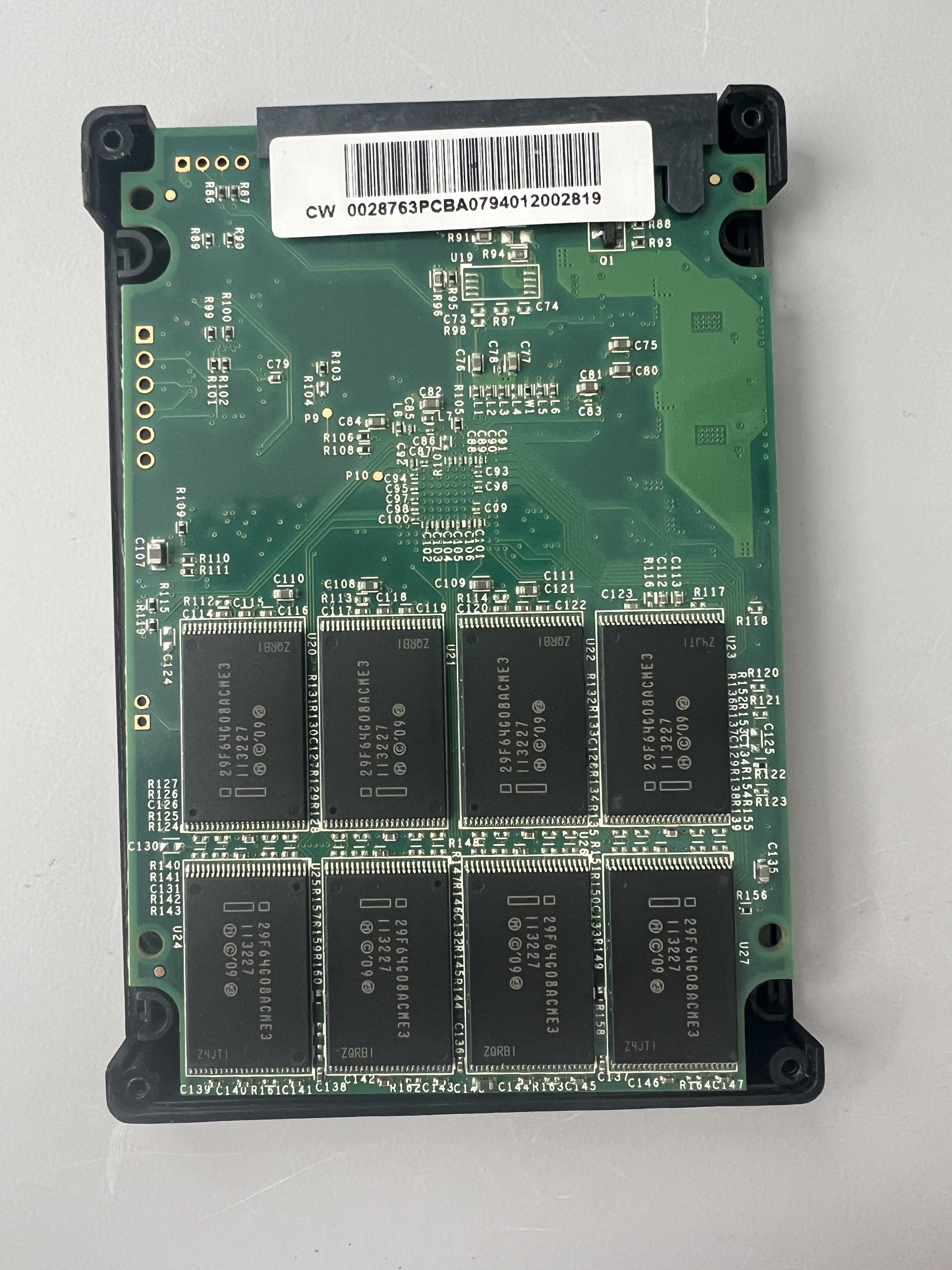

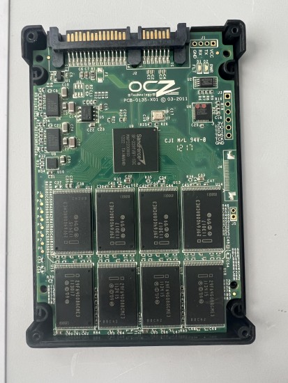

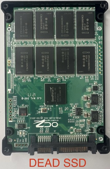

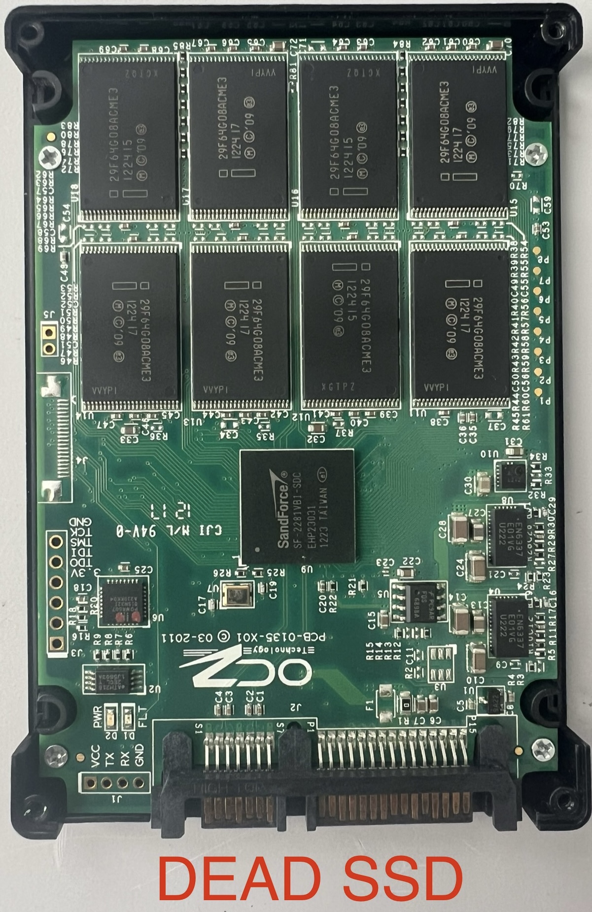

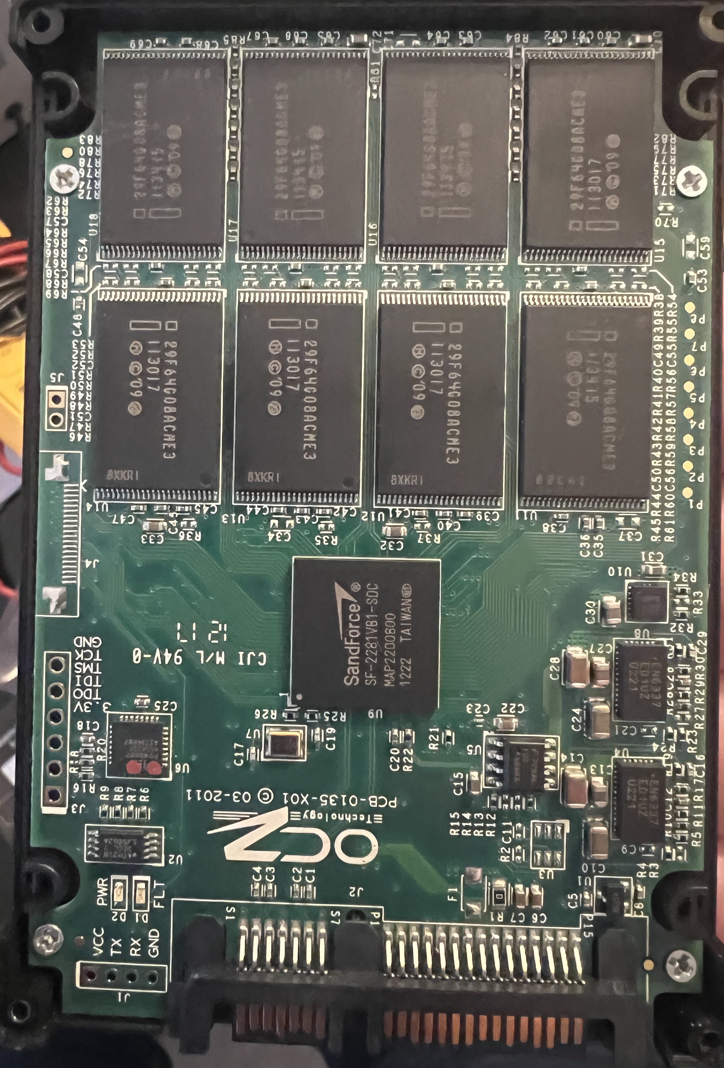

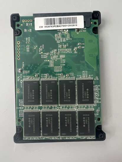

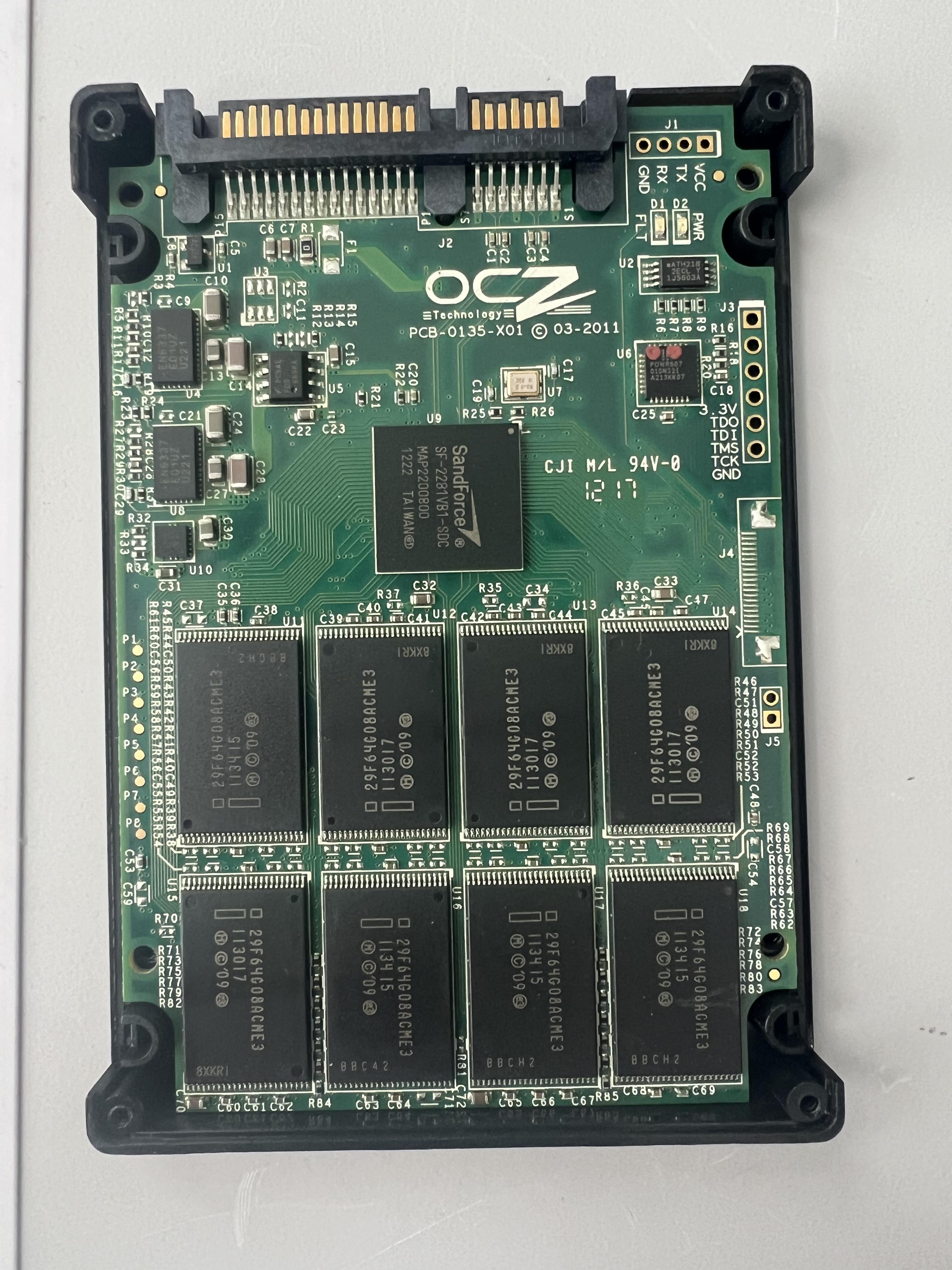

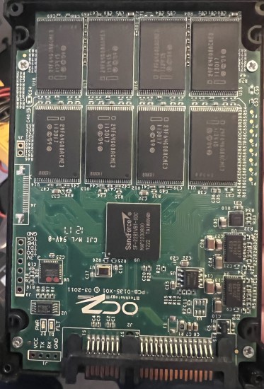

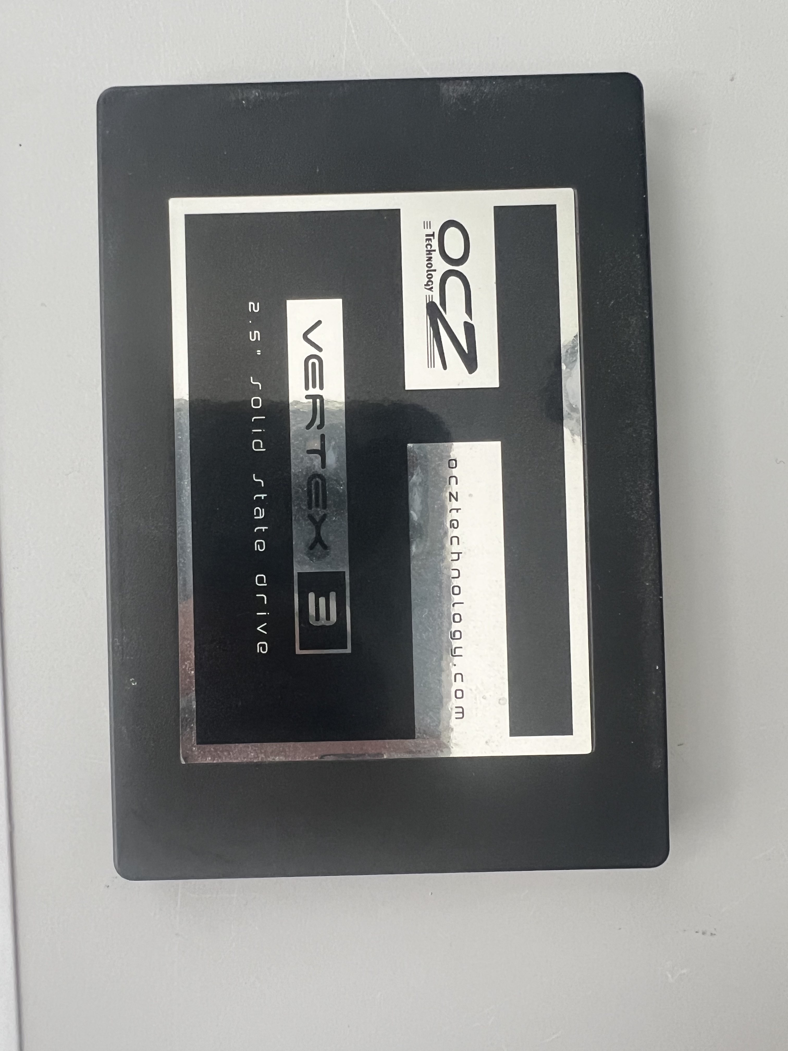

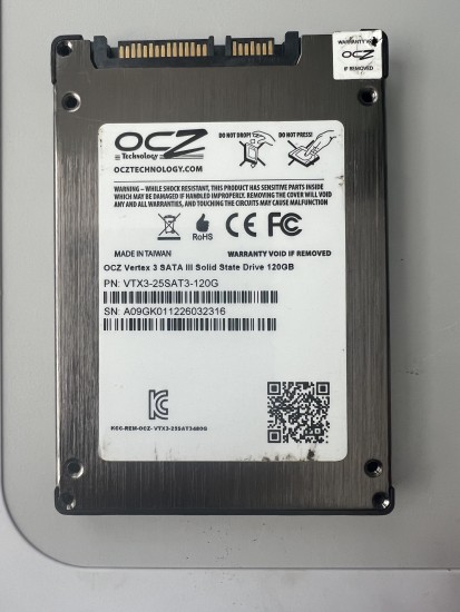

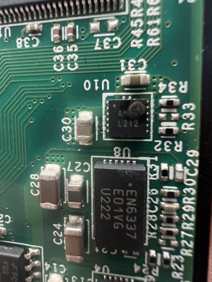

Sorry about that I will attach additional images...
I think I have so info now to start testing. Admittedly I am a novice in terms of diagnosing/testing...are there any specific tests you guys recommend I try first (outside of any already mentioned above)?
File comment: Donor SSD Front Cover
File comment: Donor SSD Back Cover
File comment: Donor PCB Front
File comment: Donor PCB Back
File comment: Dead SSD

This is my go-to resource for smd part markings:
http://markingcodes.com/
I unsuccessfully tried several variations -- AMPB, AMP, AMPx, AM, AMxx.
An alternative is Google's advance search:
https://www.google.com/advanced_search
I tried the same variations, without results:
https://www.google.com/search?q=filetype%3Adoc+OR+filetype%3Apdf+%22absolute+maximum%22+converter+qfn-16+%22AMPB%22
I use "absolute maximum" to filter out spammy part suppliers.
I examined the nearby components to see whether their context could provide a clue:
https://www.mouser.com/datasheet/2/612/en6337qi_05800-1843177.pdf (EN6337 datasheet)
The EN6337 is a "Step-Down DC-DC Switching Converter with Integrated Inductor". I wondered whether the mystery IC might be a similar component, so I tried a more specific search.
https://ipv4.google.com/search?q=filetype%3Adoc+OR+filetype%3Apdf+%22absolute+maximum%22+converter+qfn-16+%22integrated+inductor%22
This time I saw several Enpirion candidates.
This one (EP5368QI) appeared to have a pinout that matched the OP's photo clip:
https://docs.rs-online.com/68ce/0900766b8126c889.pdf
The part marking on page 2 matched the layout on the OP's IC (AAxx + LYWW).
For visual confirmation, I examined the images at Aliexpress and Google:
https://pl.aliexpress.com/w/wholesale-EP5368QI.html (EP5368QI, AAxx)
https://www.google.com/search?q=EP5388QI&tbs=isz%3Am%2Citp%3Aphoto&tbm=isch (EP5388QI, ABxx)
I noticed that Enpirion's datasheets described the converter as having an "integrated inductor" and a "16-pin QFN" package, so I now refined my Google search:
https://www.google.com/search?q=filetype%3Adoc+OR+filetype%3Apdf+%22absolute+maximum%22+converter+%2216-pin+QFN%22+%22integrated+inductor%22+%22enpirion%22
It was now just a matter of examining each candidate for the desired marking code, AMXX.
Google Images and Aliexpress confirmed the part markings.
In this case I couldn't use "AMxx" as a search term because it appears as a graphic rather than text in Enpirion's datasheets.
After you have removed U10, measure the supply voltages produced by the other Enpirion ICs (U4 and U8). These will be present on the associated capacitors. Use a screw hole as your ground reference.
U5 (FDS6898A) is a dual MOSFET. It is probably used as a load switch, in which case there would be equal voltages at each of its drain and source pins.
https://www.mouser.com/datasheet/2/149/FDS6898A-1008367.pdf
Once you have replaced all the faulty ICs, you can monitor the UART port (J1, TX, RX) for diagnostic messages. You would need a USB-TTL RS232 adaptor.

Just a quick update before any solder work, continuity testing of the C30 and C31:
Good drive:
C30 - .737
C31 - .864
Bad drive:
C30 - .000 shorted
C31 - .611
Assuming removing that fried chip will eliminate the short…
PostPosted: April 5th, 2024, 16:31
Posts: 17256
C30 is the output of U10. I would desolder that chip and retest for shorts. If the short persists, then one of the main ICs is probably damaged. Otherwise there could be a shorted capacitor on that rail, but this would be an unlikely consequence of a "power surge".
