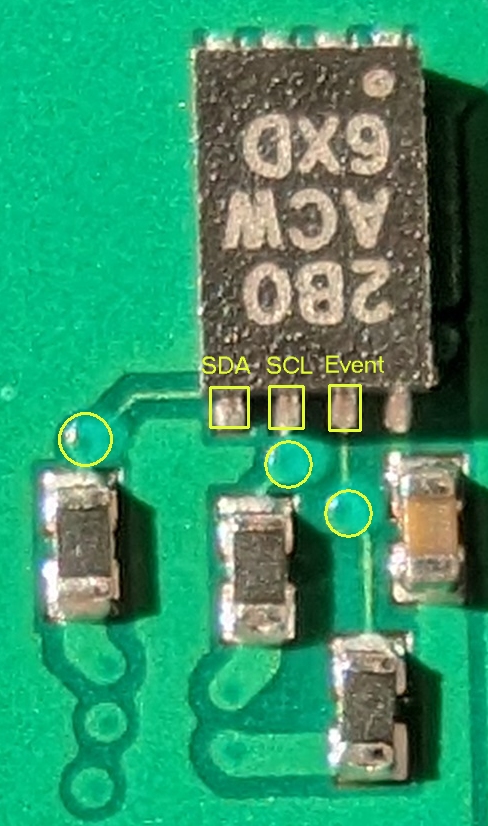

Posts: 17324
I have a couple of ideas to try to provoke the firmware into entering an ERROMOD state. These involve disabling the temperature sensor or the power loss data protection circuitry.
If you can upload a detailed photo of the PCB, I can show you what to do.

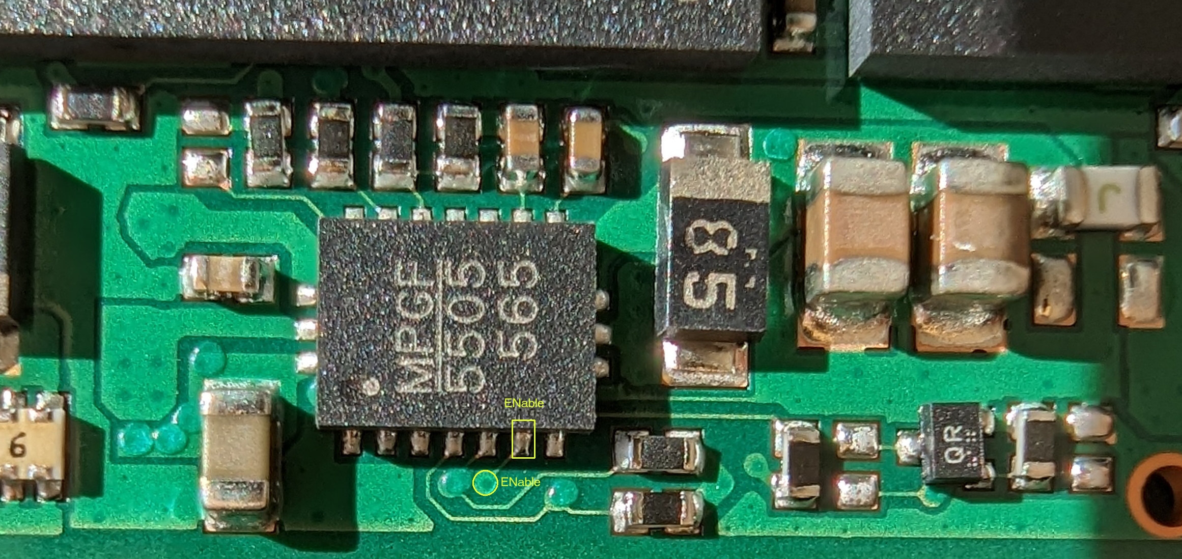

Referring to this photo ...
https://i.imgur.com/fPozb1R.jpeg

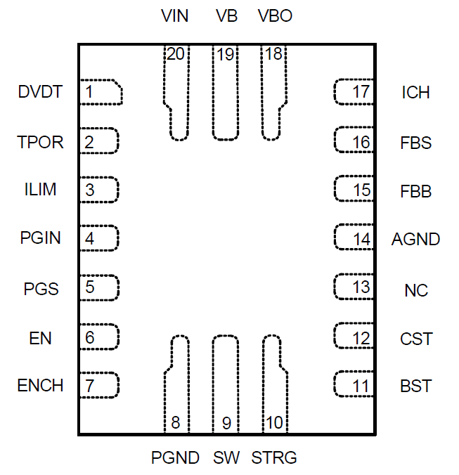

... there is an 8-pin IC in the centre of the PCB, immediately to the left of the NAND array. That's the temperature sensor. Also, there is a larger 20-pin chip below the NAND array (MP5505). That's the chip that controls the power loss protection circuitry.
Can you provide a close-up shot of each chip?
Power Loss Protection:
http://www.hddoracle.com/viewtopic.php?p=21248#p21248
If the EN pin of the MP5505 is not strapped directly to Vcc, ie if it is tied up to Vcc via a pullup resistor, then you can short this pin to ground while powering up the SSD, and then release the short after the SSD identifies itself. Hopefully this will induce ERRORMOD.
I updated the imgur link with more photos taken in daylight, including close-up shots of those two chips. :)
 Post subject: Re: Unlocking ATA Password of PM863a SSD possible?
PostPosted: April 16th, 2023, 5:08
Posts: 1319
I suspect that the pinout of the temperature sensor may be similar to this IC:
http://ww1.microchip.com/downloads/en/DeviceDoc/20005192B.pdf
If so, then you could short SCL or SDA to ground during power-on and then release the short.
If it is, you may well find them on the i/o holes far bottom right.
PostPosted: April 16th, 2023, 13:51
Posts: 17324
I would try shorting SCL (temp sensor) or EN (MP5505) to ground, as explained previously.
