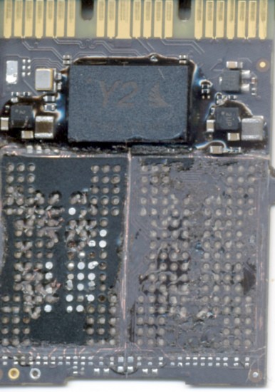

Hi to everybody. I have the case in object
Broken controller marked Y2
Chipoff-->
NandChip are 2 x bga132
Tryied to read each one via pc3k flash but ID is always 0x00000000 .
Power used 1,8 to 2,3
I haven't found any info neither on controller nor on nand.
Has someone experienced with these devices/controllers/nand?
Thanks in advance

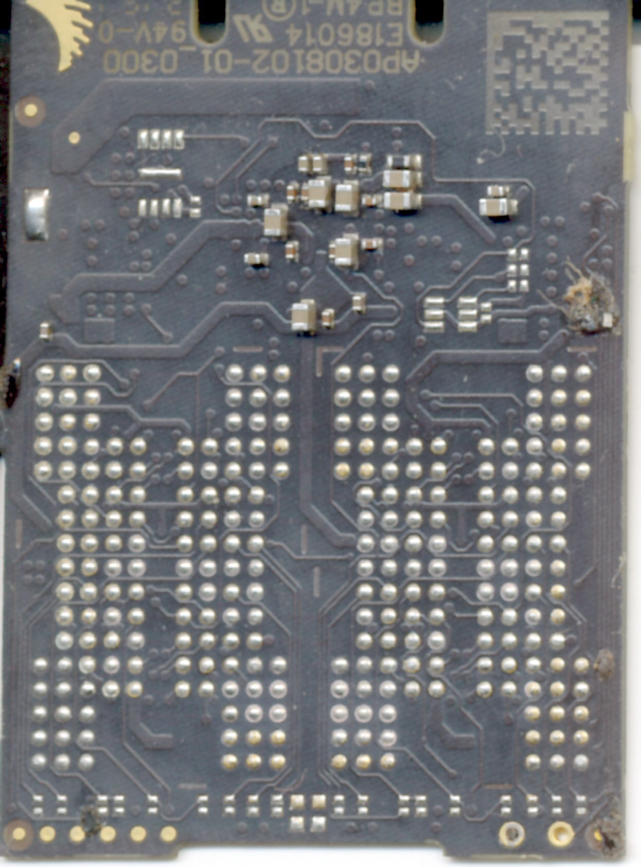

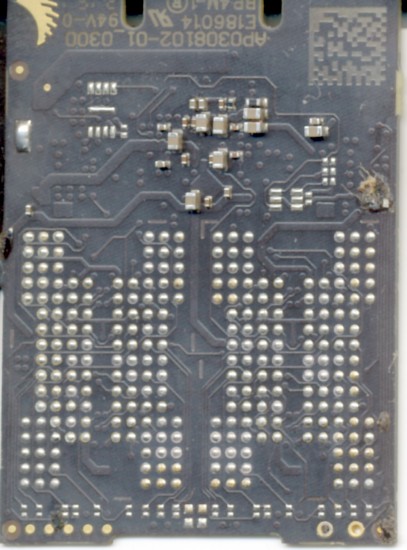

 Post subject: Re: CFexpress cards 512 GB Type B branded Angel bird with br
PostPosted: June 8th, 2024, 20:37
Joined: March 21st, 2009, 14:53
Posts: 59
Location: Malta

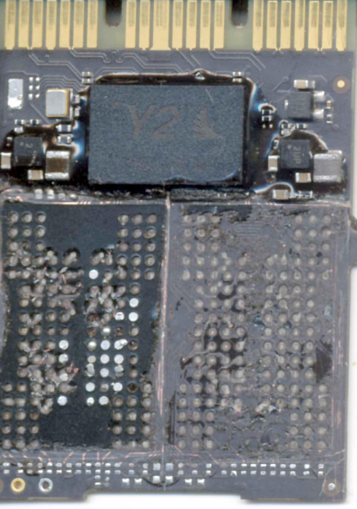

Double side PCB Photos. You can see residual resin still laying over controller. Glue (you can still see too) was placed also under each nand.
Desoldering these was hard. None of under-chip 132 pads were damaged
PostPosted: June 8th, 2024, 21:11
Posts: 17256
Now that you have removed the NANDs, does the controller identify itself?
PostPosted: June 9th, 2024, 3:37
Posts: 922
Chip could use low power, so you have problem recognize ID at reader.
I have feeleings that this controller use LDPC.

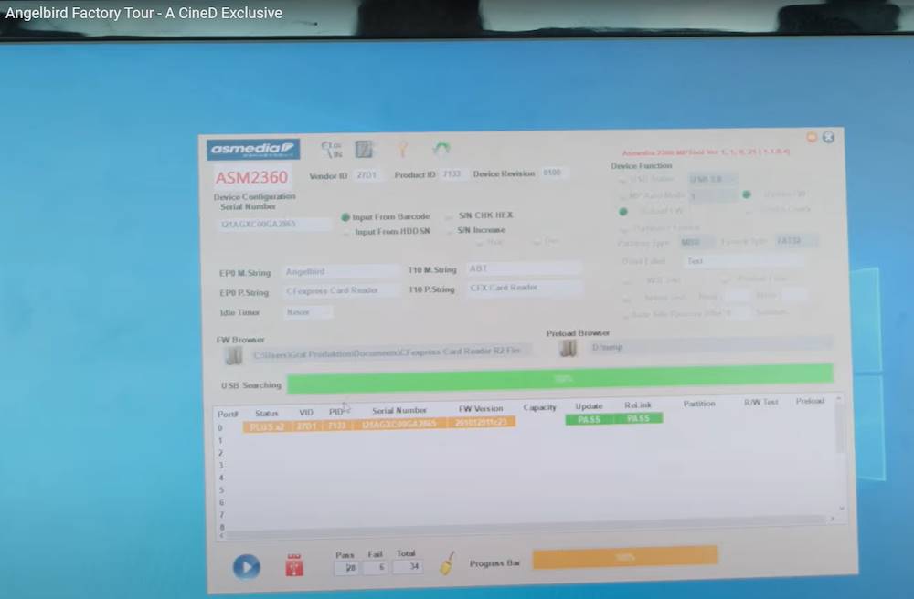

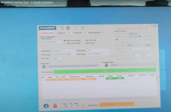

PostPosted: June 9th, 2024, 18:04
Joined: May 13th, 2019, 7:50
Posts: 1209
Location: Nederland
This appears to be an MPtool they use to configure CFExpress card ..
