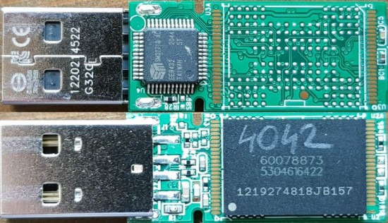

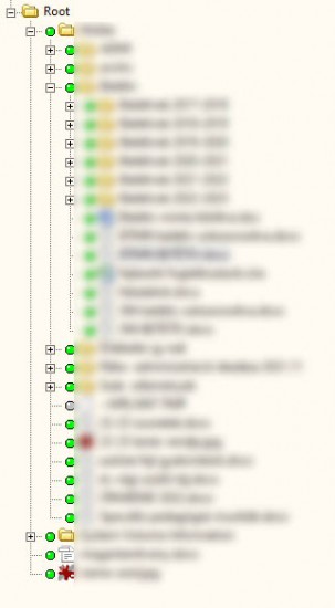

i remember a case (SM3271Q, same xor sig) where i had to build xor taking shifts into account on one plane. At first i was told by Arvika it is a simple case and to use FE to do it. First i read it on pc3k. and tried to build FS which largely failed due to the badly deXORed pages, but by using FE and VNR i got precisely same results. He could not do it simply either, so i was left with building shifted xor. Or something like that. After that the recovery was perfect.
 Post subject: Re: Question about Silicon Motion XOR modified by Bad bytes?
PostPosted: June 9th, 2024, 18:51
Posts: 925
@pepe Case was solved very fast. Dump quality was not so good, you not uploaded better dumps, as I asked. After several days (or weeks, not noted this) you solve it. Just for clerance ;)
PostPosted: June 9th, 2024, 18:55
Posts: 4854
dump was almost perfect, corrected, the problem was the xor, if we are talking about the same case. There was no quick solution. It looked like it was done after assembly, but the FS was corrupt in many ways. After the new xor it was perfect.
yeah, after several days i wrote some sw that built the full xor out of the pieces, that fixed the whole thing.
PostPosted: June 9th, 2024, 19:05
Posts: 925
As I see there is no model. I will add tomorrow to Flash Killer DB.

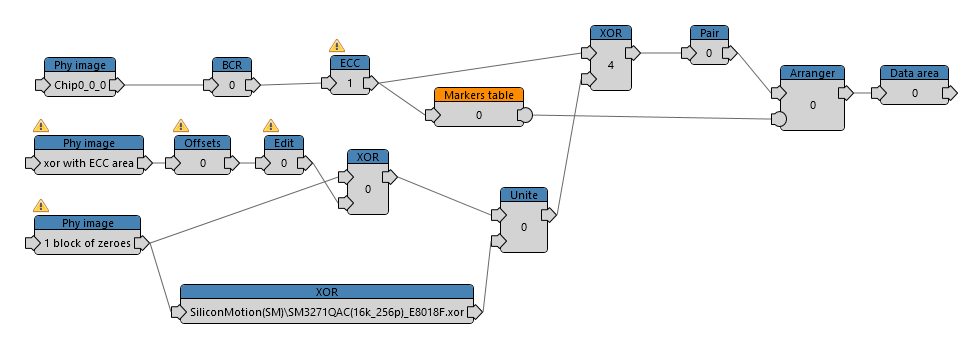

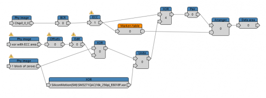

i had to create a full block of xor for data AND ecc area and cut the bb-s (the offset element), then pair with the orig xor for the other plane and xor the orig dump with that.
I could not find a prebuilt xor for data + ECC, so i had to build it.
It's not that the ecc was xored, but by cutting bbs from data area, these bytes caused shifting the last bytes of the sectors to be shifted from the ecc, which was not present in the orig xor file. Of course it xored the ecc in the orig dump but it was irrelevant, coz i applied it after ecc correction.
In fact, now that i re-think this project, the 2 elements on the bottom was probably unnecessary, i could have connect the 'xor with ecc area' right to the bottom input of Unite...
PostPosted: June 11th, 2024, 11:53
Joined: September 23rd, 2019, 2:55
Posts: 112
OK, everything is clear to me, I understand, I did the same, but I filled the ECC area with zeros, but you probably used some XOR in the ECC area - which one?
I have a problem with the XOR that you placed in the ECC area, standard XOR does not fit for me.
If I had the correct XOR and put it into the ECC area, the solution you presented would work.
Now I am manually rebuilding this XOR - I have 2 blocks with MBR/FAT with have partially clean XOR for this missing area. I think I will find the rest of the pages in the dump.
Thanks pepe for your answer.
