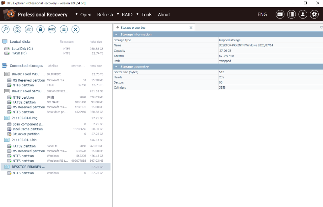

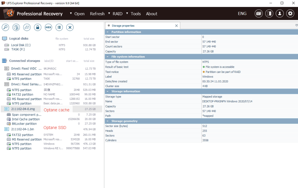

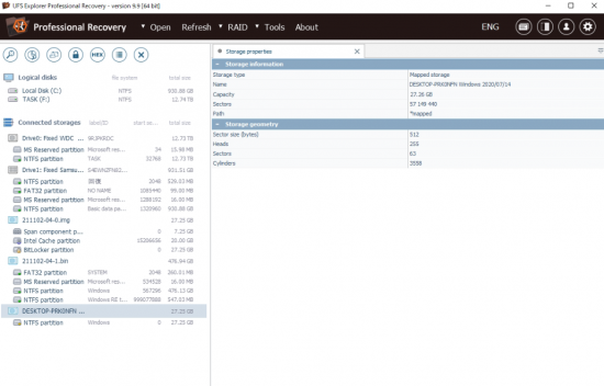

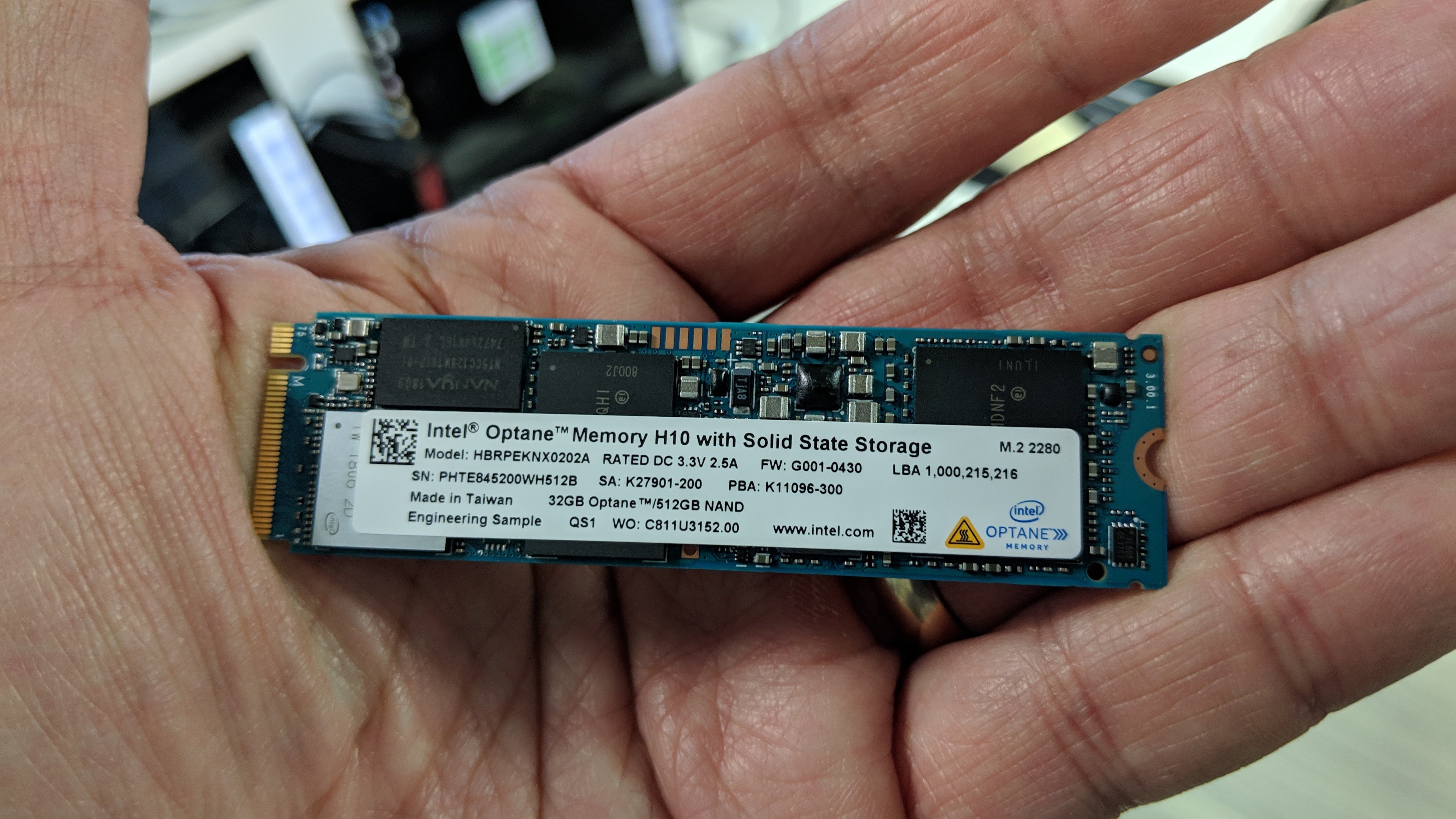

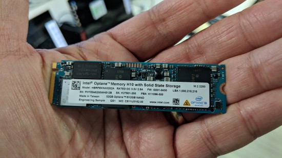

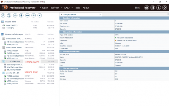

Trying to build intel cached optane storage in UFS Explorer. Managed to create images of both cache chip and memory chip.
But this time there is a bitlocker partition on cache side.
Without bitlocker, storage build-up is a one-click option, which was successful every time.
Bitlocker is known and after recovery key is input, there is another NTFS partition.
So at this moment there is no any intel cache partition can be found even after scan.
Any thoughts? or maybe anyone had similar case?
