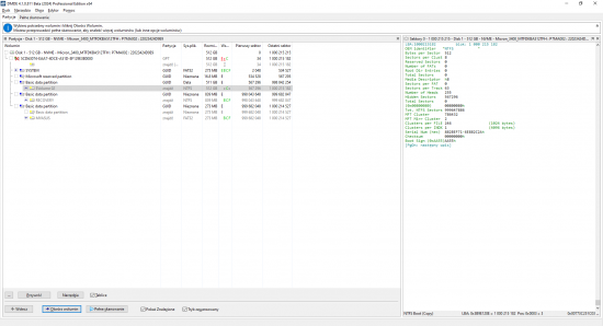

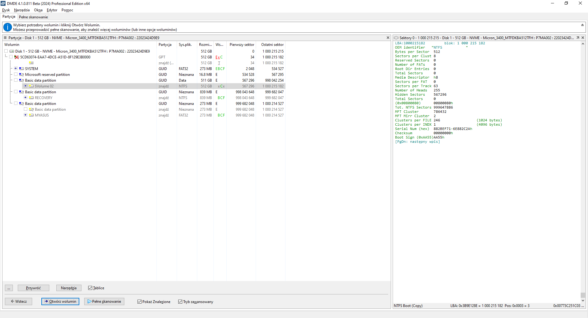

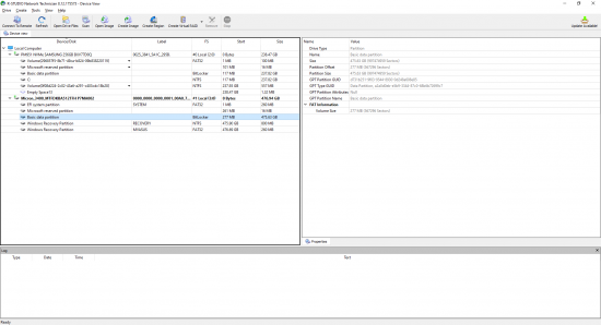

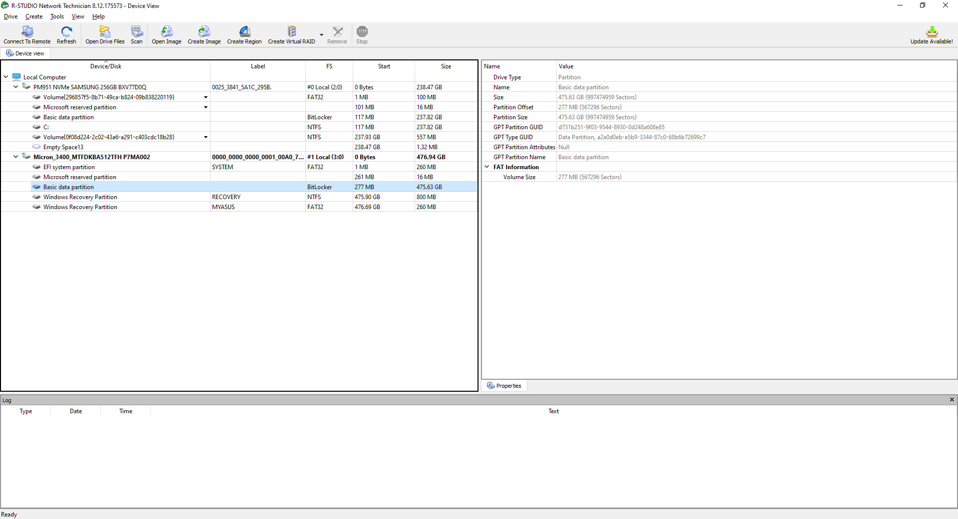

Hello guys
I have Micron_3400_MTFDKBA512TFH P7MA002 SSD drive taken out of my Asus laptop. Yesterday it worked fine but today I can't boot up Windows. When I connected M.2 SSD drive to PC it shows as uninitialized. When I open R-studio partition with data shows it is bitlocked. I have recovery key for bitlocker key.
I don't know how to put recovery key in R-studio or DMDE.

No bitlocker support in DMDE and probably not in that ancient version of r-studio technician either.
