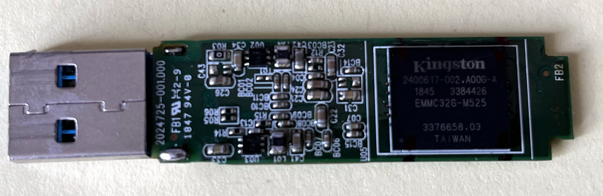

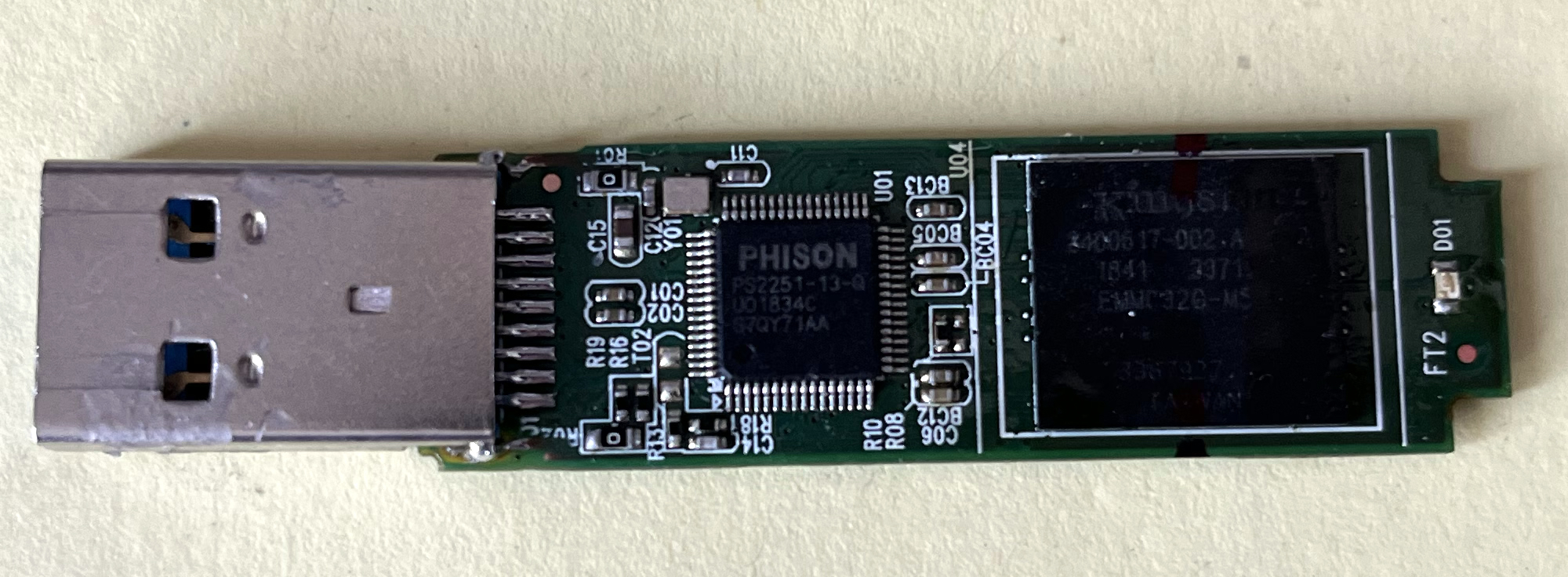

i got this USB Stick from a customer, with just broken USB connection, all pads are there, new USB connector set perfect.
and it still does not work.
there are 2x emmc connected to PS2251 - so i would say, i can't read them through reader.
V1 and V2 is 1,8 and 3,45V - looks legit to me :D
any idea what else could be damaged? - maybe when connector broke there was a short? thermal camera tells me controller starts up, emmcs are getting voltage - everything in normal temp area 35-45 degrees.

Be careful. Not all USB 3.0 connectors have the same pinout.
https://forum.hddguru.com/viewtopic.php?f=10&t=36891&p=260036#p260036
Also, is R02 (zero-ohm link) grounded?

thx - yes both Zero ohms are grounded.
i first tried of course with original Connector, and behaviour is exactly the same. it goes to 0,07-0,1A - when i try to read ID via PC3k Portable - it goes up to 0,15A and just show me some Kingston info in ID field - but no serial/size and so on.

A quick google shows it to be a problematic combo. Think I'd start by either breaking the voltage to the emmc or pulling the chips to prove the controller.

Yes this PS2251-13-Q is used in secure / encrypted USB Flash drive with EMMC chips.
Here more info: https://www.cl.cam.ac.uk/~sps32/HWIO_IRONKEY.pdf

Case has been solved. Problem with soldering of those chips. And it was encrypted by Datatraveler Vault.

Hotair + microscope + flux + tin + tweezers + soldering iron + Windows + DMDE
