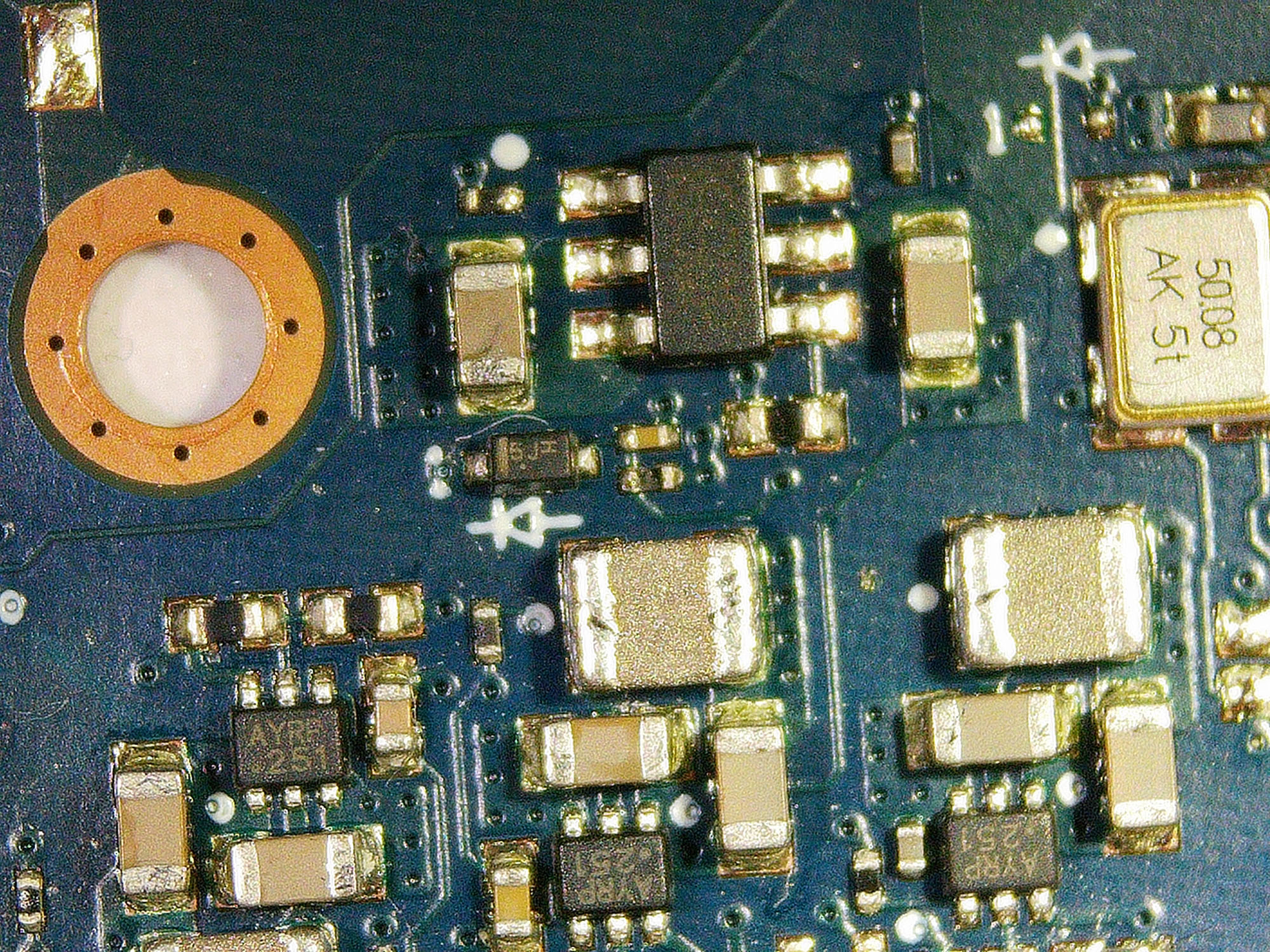

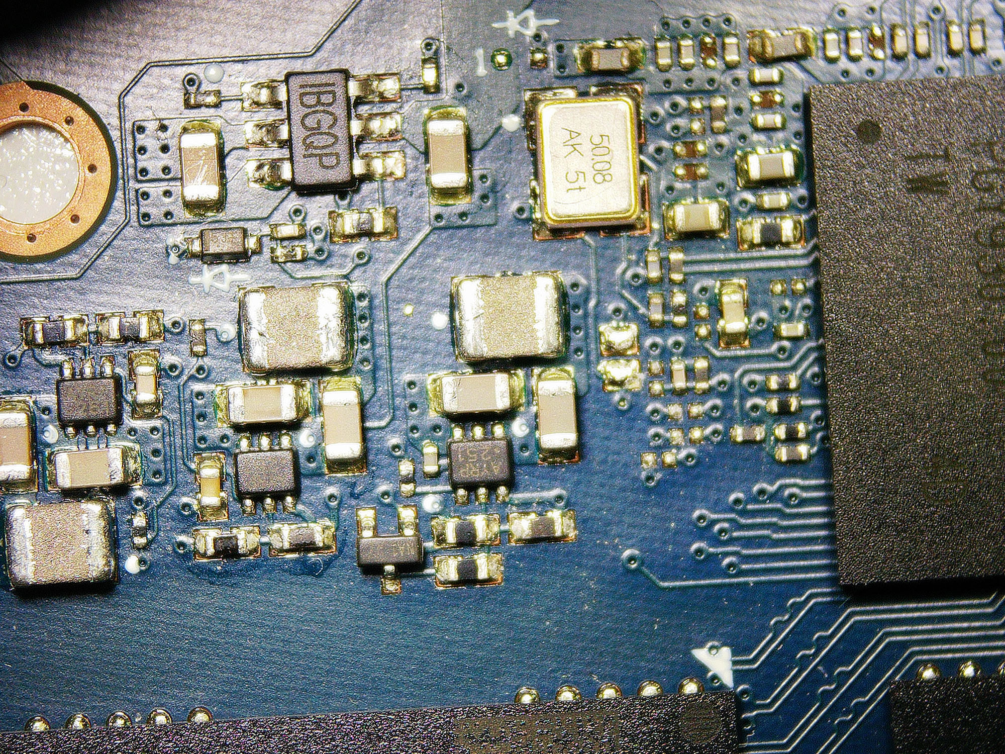

Can anyone please identify the components of the 6 Pin IC BGQP and the 5J dot I diode under the IC?
It is on Corsair MX500 1TB SSD.
Thank you very much.
File comment: Diode 5J dot I
File comment: 6 Pin IC BGQP

Franc will correct me if Im wrong no doubt but Id say MP5036A is what you're after.
 Post subject: Re: Identifying Corsair MX500 components
PostPosted: August 5th, 2024, 16:57
Posts: 17230
One possibility for the diode:
https://ae-pic-a1.aliexpress-media.com/kf/Sd73bd14903f345e5ad2a6556ee320713C.jpg (photo of LRB520S-30T1G)
https://www.lcsc.com/datasheet/lcsc_datasheet_1810010324_LRC-LRB520S-30T1G_C83680.pdf
If necessary, you can bypass the MP5036A by connecting Vin to Source.
