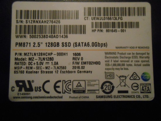

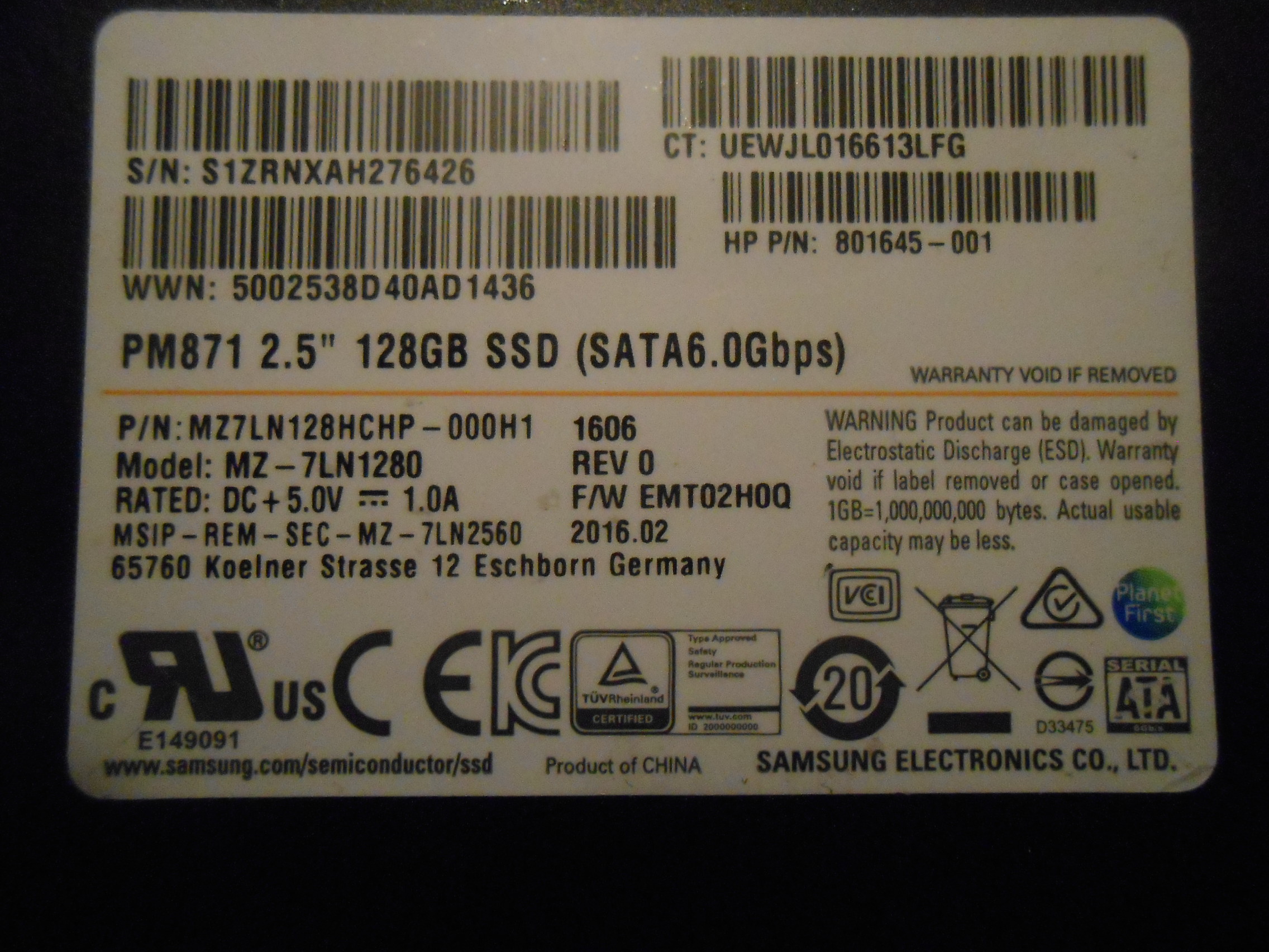

So JTAG doesn't seem to be the right way, but maybe the PSID. Is there more information about finding the PSID (or MSID) for OEM drives?
There are 4 barcodes printed on the label, are they useful or just the same as the values under them (S/N, WWN, CT and HP P/N)?

I would suggest that you post screenshots of the problems or status, and photos of the labels. (And perhaps dmesg, hdparm and smartctl output if you have Linux)

So here is the info from hdparm, smartctl and the label. Got the data from PartedMagic, SSD connected via USB-Sata bridge (JMS578 chipset, with that bridge I can get smart data from other good drives).
Smart data cannot be read. In Windows the SSD cannot be initialized (crc-error).
Secure erase or Sanitize in PartedMagic is not successful (frozen state). PSID revert may work, but I have no valid PSID on the drive. Is there something like the ATA master passwords in the good old days? PSIDs are unique, but is this true for oem drives?
If PSID revert doesn't work, I think firmware-update/repair could be worth a try. But where to get one? Can a Samsung or Lenovo firmware put on that drive? Can the firmware read from other good drive? Can a firmware be flashed to a frozen drive?
Can other (security-)software bring a drive to always frozen state (WinMagic or similar)?
