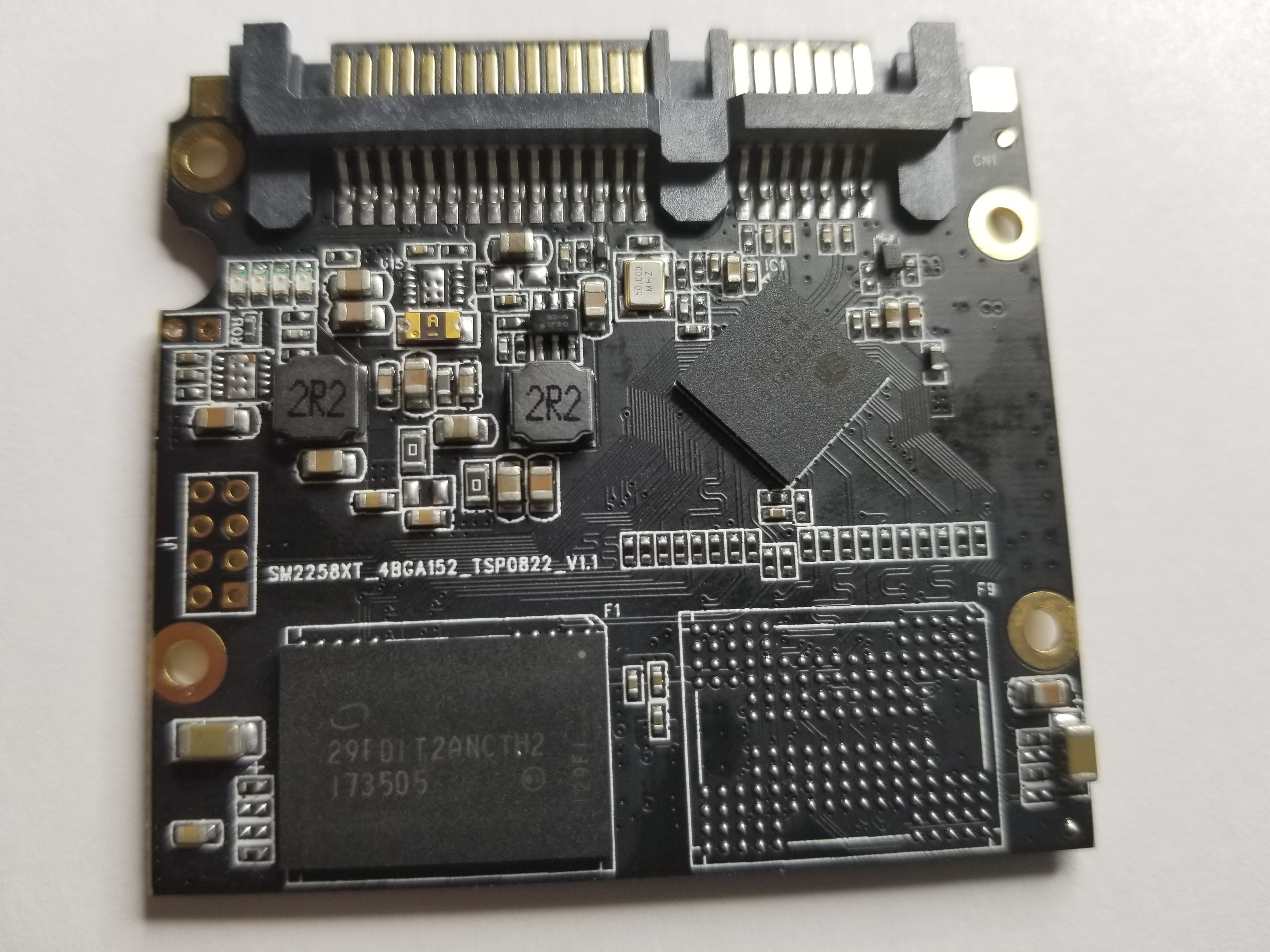

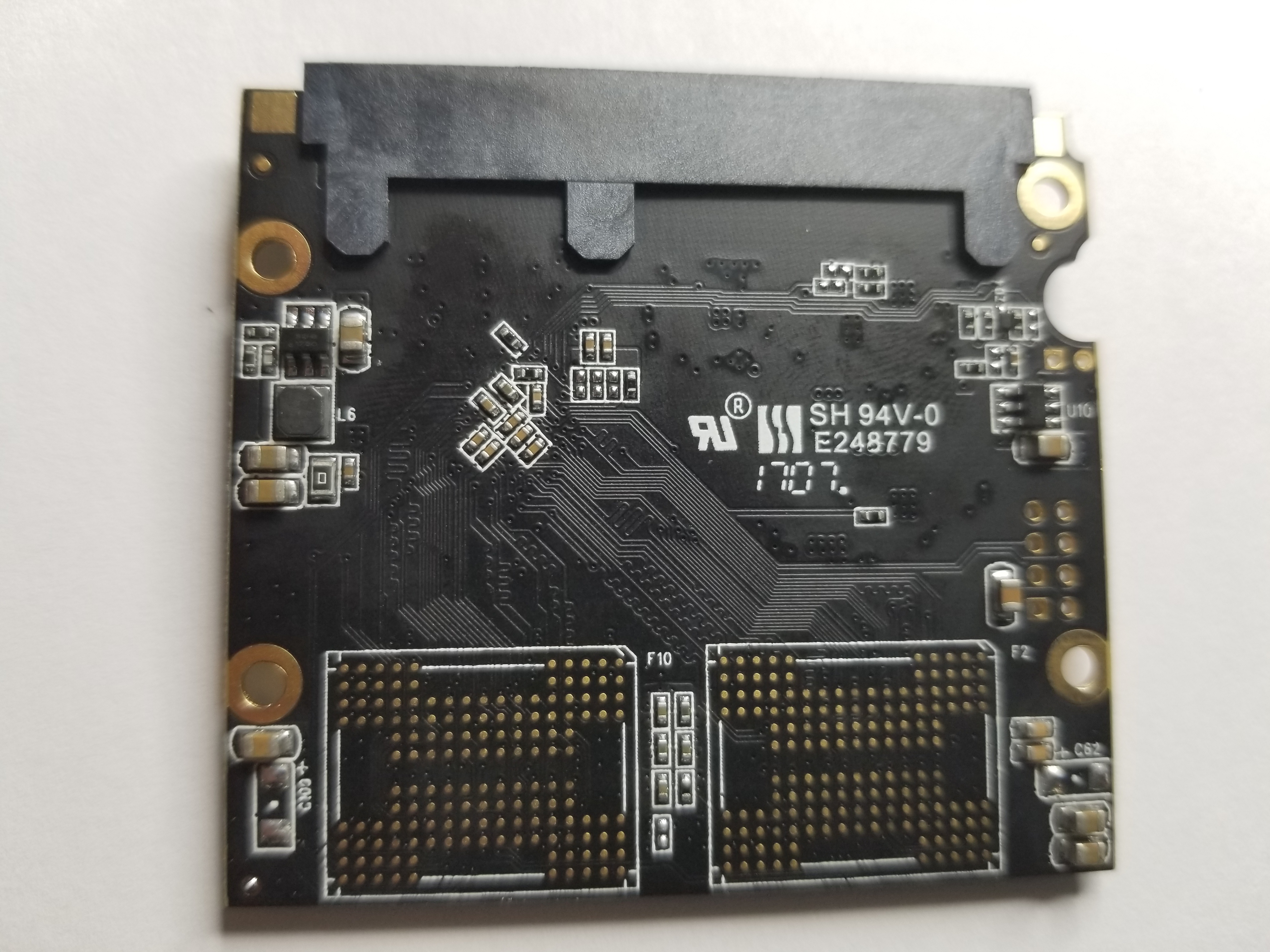

Anyone had experience with these SSD's. Pretty sure its FW as it goes BSY trying to read a sector.
Drive does ID with full volume.
I am able to get it into Safe mode, but as its not supported by PC3000.
IDs as a Seagate, but not sure it is as it has no com port like the other Seagate SSD's.
Controller is SM2258XT, but after Safe mode activated IDs as SM2258SB.

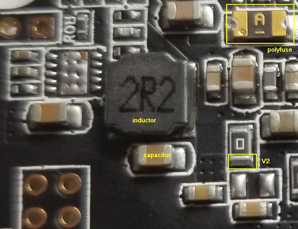

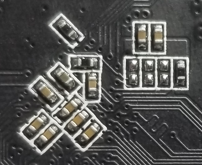

The good thing about this PCB is that all 3 supply voltages have zero-ohm links between the Vouts and their respective loads. One would only need to identify the NAND supplies (by measuring the voltages at the zero-ohm links), then remove the appropriate link and connect a variable external supply to the load side of the link.

I'm wondering whether you could use the variable voltage feature of your flash tool(s) to generate the external voltage for your PCB's single NAND chip. I think there should be no problem with the current draw.

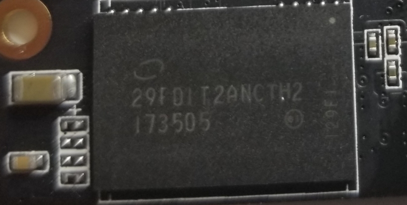

The Silicon Power SSD in our thread has a capacity of120GB, yet all my searching suggests that its single NAND flash IC (29F01T2ANCMG2) has a capacity of 192GiB. Normally this would imply that there is a great deal of overprovisioned space. Instead it would appear that much of this extra space may be used as a "dynamic SLC cache" to compensate for the absence of DRAM.
Lets give this a go if you are still keen.
Let me know what you want me to check and where to get us started.

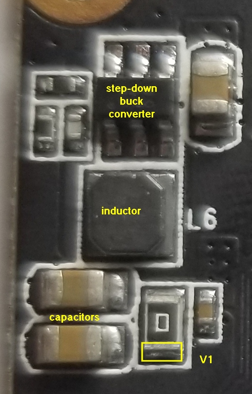

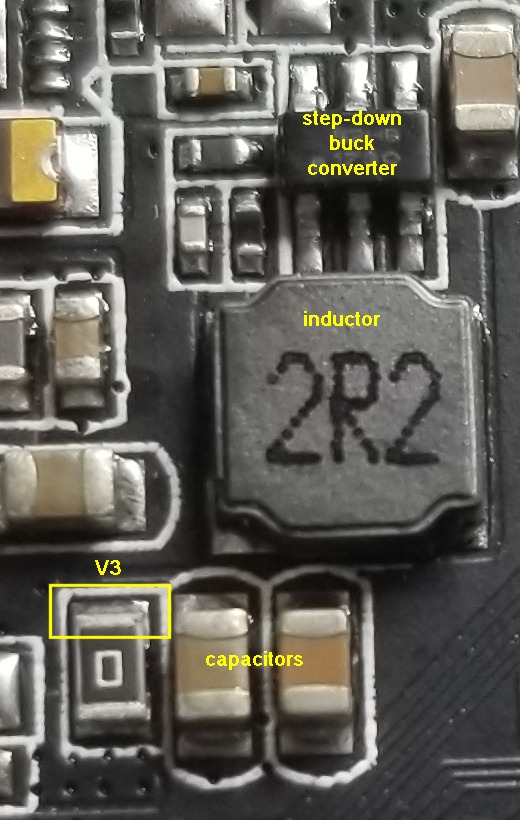

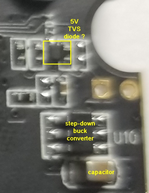

I would measure the voltages at V1, V2 and V3.
After you determine which of these is the NAND Vcc supply, remove its corresponding zero-ohm link and confirm whether on not Vcc now appears on any of the nearby capacitors, including those that I have not identified.

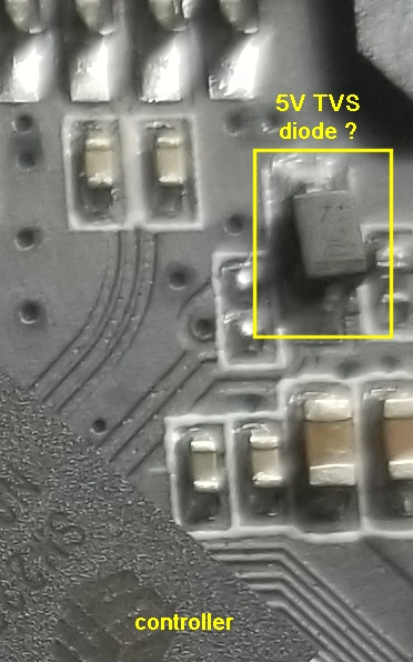

Could you also identify the markings on the buck converter ICs?

TVS 1 - 4.7v
TVS 2 - 3.3v
V3 - 1.8v
V2 - 3.3v
V1 - 2.1v (seems strange)

You could determine which of these voltages are required by the MCU and NAND by measuring the voltages on their bypass capacitors.
ZD4 could be the flywheel diode for the nearby regulator. If you could identify the regulator and diode markings, I could confirm this.

ZD4 is hard to see, but looks like
ZF with a 7 on its side ie ZF 7
The ZF has one dot under it. The 7 on its side has two.
(hope that makes sense)
Regulator - S2HB 1730
MCU voltage seems like 2.1v, with the NAND at 3.3v

The "ZF" marking is used by zener diodes with conflicting voltage ratings (10V, 12V, 7.5V, etc). Searching for S2HB produces no lilkely candidates. :-(
I don't understand why current controllers would be running off 2.1V (I would have thought 1V to be more likely), but maybe this is a red herring?
Anyway, V2 appears to be our target. I would remove the associated zero-ohm link and confirm that 3.3V is no longer present at the NAND. Then I would connect your VNR adapter's variable Vcc supply to the NAND side of the zero-ohm resistor (ie the side that now measures 0V), and connect the adapter's Gnd to SATA power ground. Then you should be good to go.
