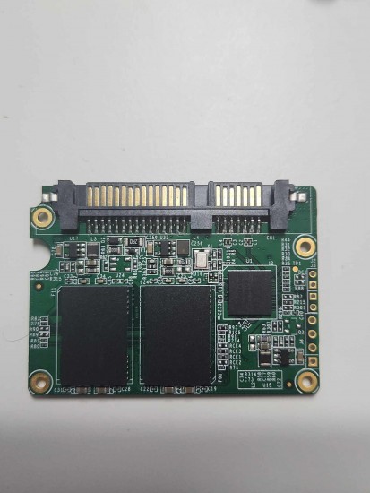

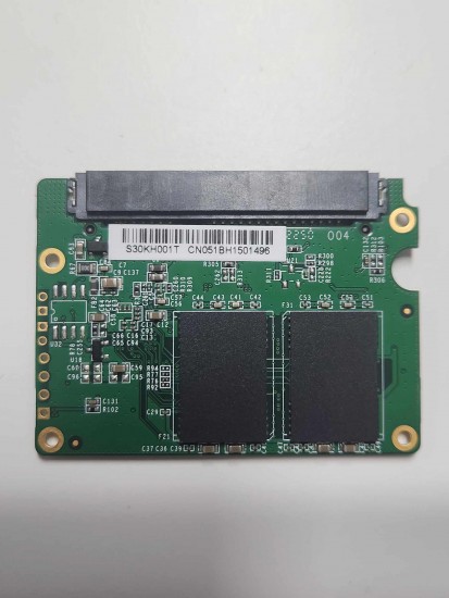

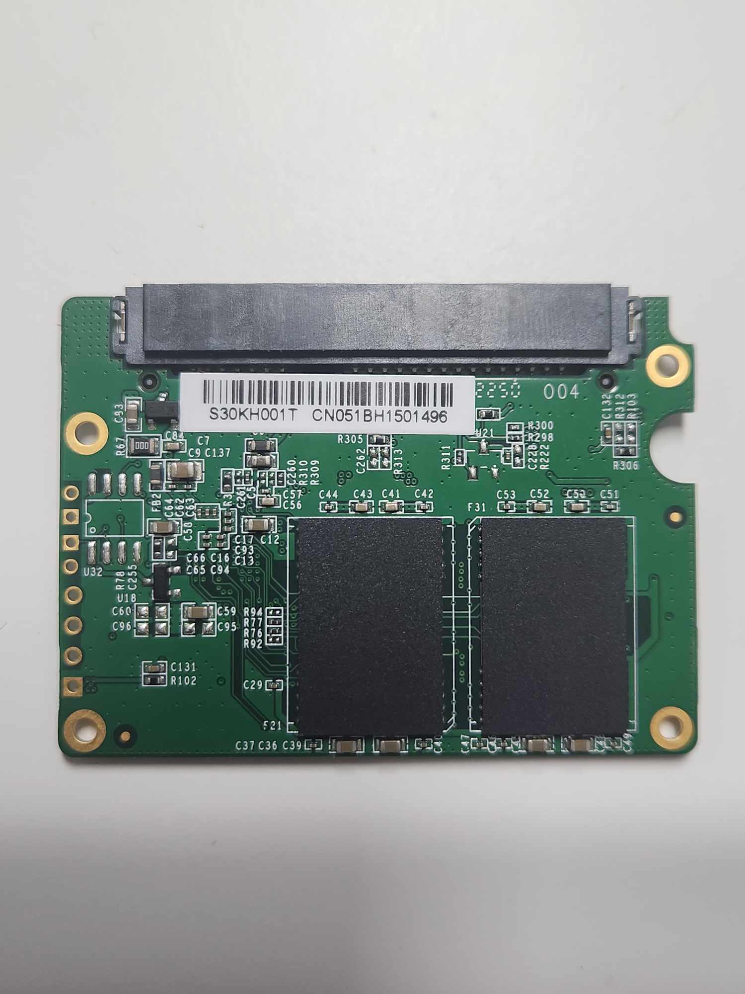

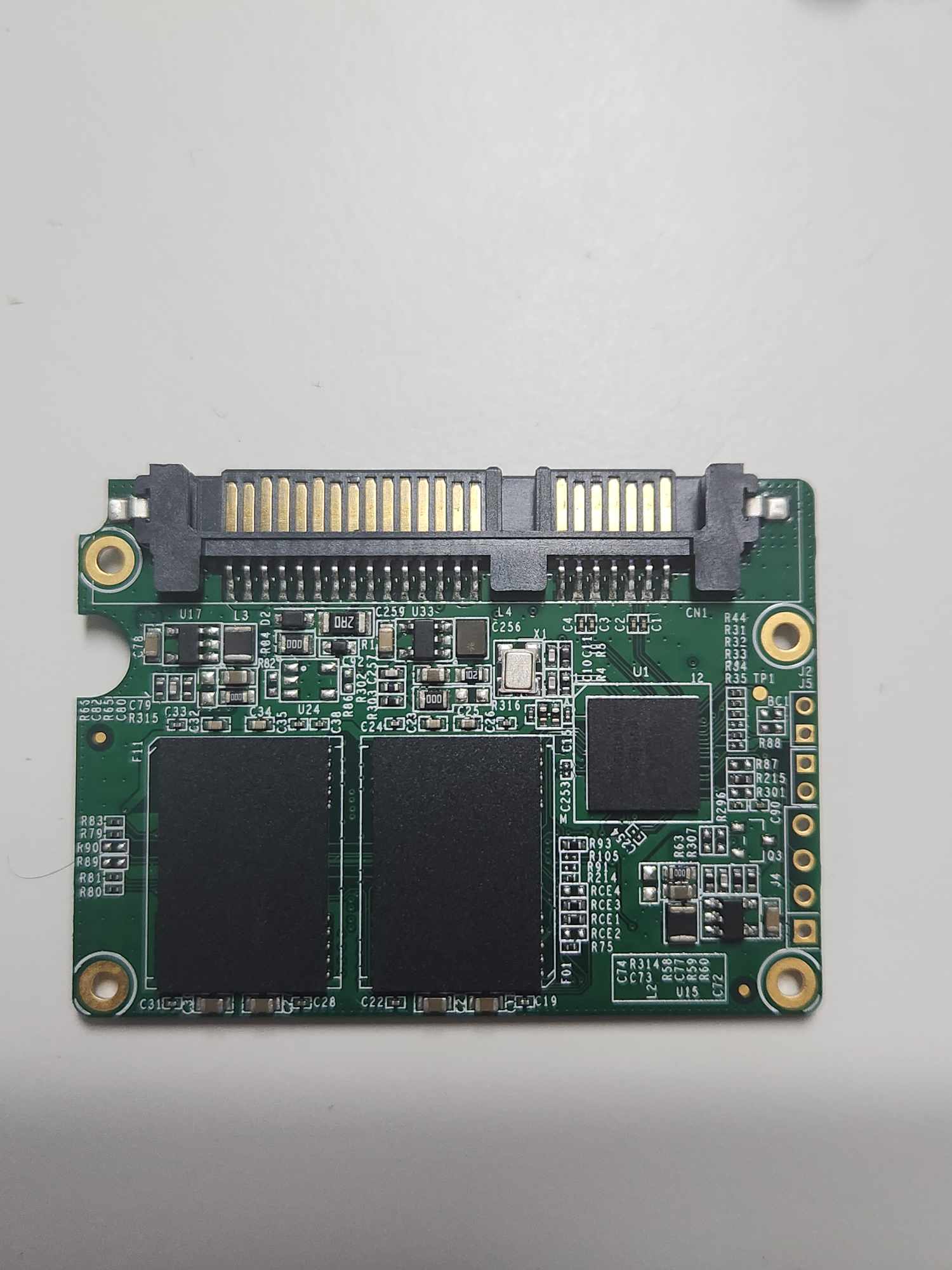

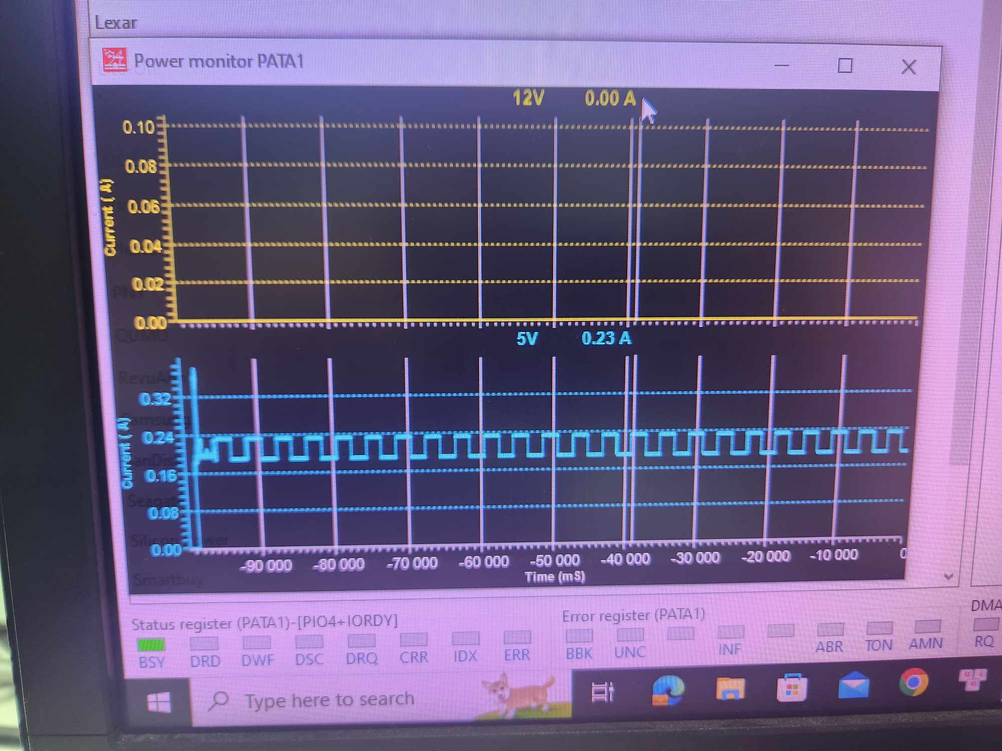

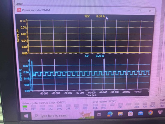

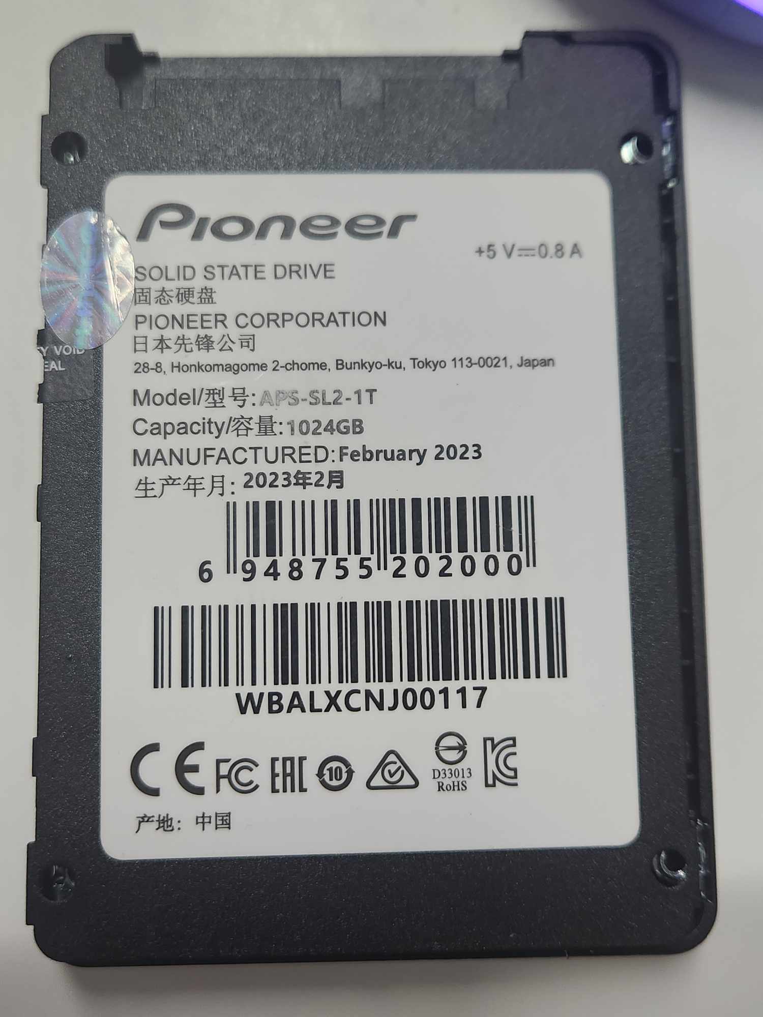

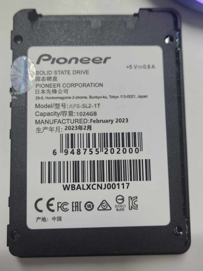

So i have this 1TB Pioneer SSD
Upon turning on it stays BSY and shows Square Waves jumping from 0.19A to 0.23A
Anyone knows the what can be the problem of this SSD
I tried shorting ROM pins which readied the drive. However shows only 00000 information in ID
What i think it can either be FW or bad components??
Thanks for any help!
456473201_891768616132512_2252840039237521143_n.jpg [ 257.46 KiB | Viewed 6893 times ]
File comment: Back
456141636_3888349451397571_5426193373291306935_n.jpg [ 162.6 KiB | Viewed 6893 times ]
File comment: Front
File comment: SSD

Typical Lexar SSD
 Post subject: Re: Pioneer 1TB SSD Maxio MAS1102B controller
PostPosted: August 26th, 2024, 22:53
Posts: 267
Location: Vietnam
einstein9 wrote:
Typical Lexar SSD
Yep. its the same exact Layout, PCB from LEXAR NS100 drives
