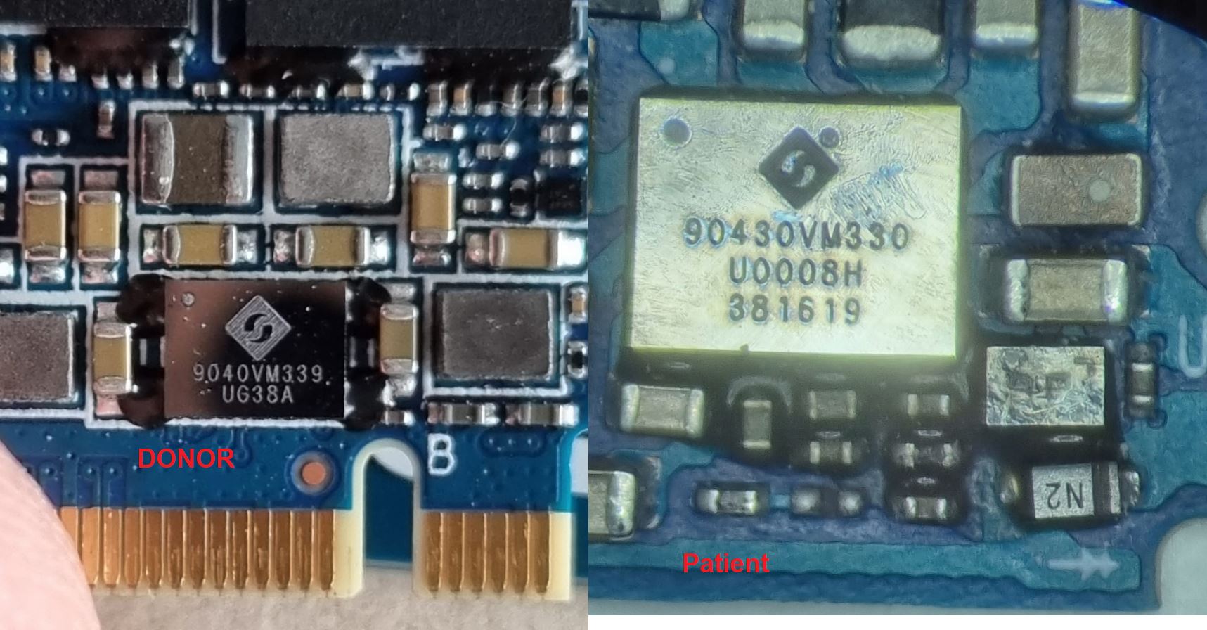

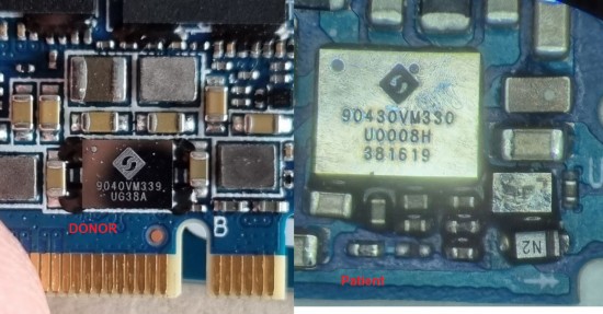

i got this Sandisk SSD with a PMIC issue. There's no output voltage. Diode is ok, caps ok. It takes 0.1 amp and drive is not detected at all, not BSY.. just not detected.
I can't find replacement part or datasheet for that IC, google point to WD XBOX SSD but there's no good info. I have another Sandisk I could use for donor but PMIC is 9040VM339. For this chip, I can find datasheet.
Anyone knows if they are compatible ?
Can you upload it?

Active Semiconductor was the original maker, but they were acquired by Qorvo. Even if you were able to match the ACT90430VM part of the name, the last 3 digits define a custom voltage profile and power-up sequence. In other words, even if the pinouts are a match, it could be that the voltages and power sequences are different.

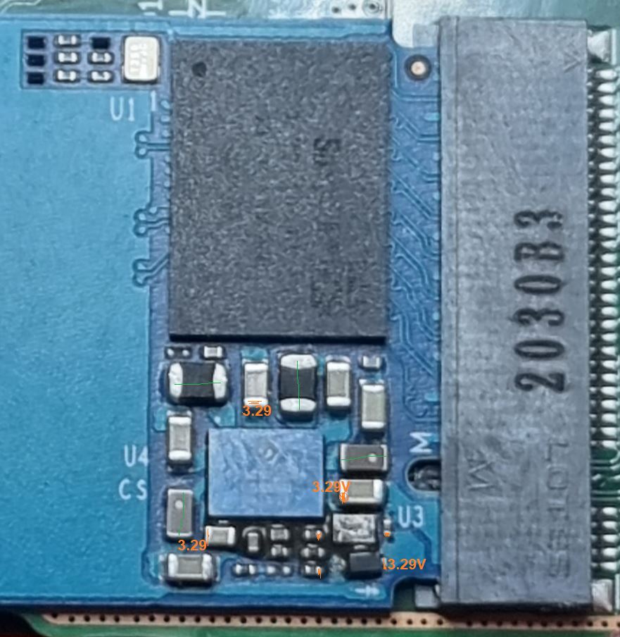

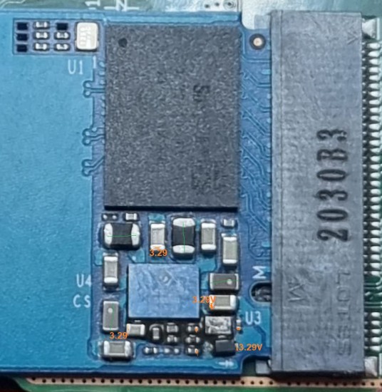

Thansk for the input, it could be Mosfet as well. All pads marked in Orange have 3.29V and the filter with green line means they "bip" if I put probe on each side.
It's not easy to test without removing components. Do you beleive I should try to remove the Mosfet (marked AF) and then try to inject voltage on the output ?

suricate.ch, I get everywere 3.42V.. even on the diode

Since you are getting 3.3V around the PMIC, the MOSFET must be OK.
