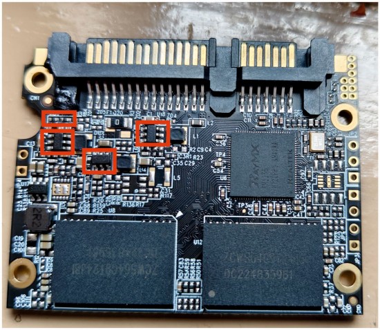

Hello There,
I have one ssd Model Number ZEB-SD26 Sata 2.5". It comes with no power. When I check than i found that 2 capesitor and 6 pin voltage regulator damage which i mark in the image. I have same donor ssd and change the faulty parts. when i plugged it to computer, in device manager ssd showing "REALTEK_RL6643 an in disc management it show only 1 MB. Data is important. seeking help from your side. I haven't any MRT, PC3000 like tools.
Thanks In Advance.

It's in safe mode - check you have voltage to the nand.

How to check power supply to nand?

No it is not in safe mode

Measure the voltages at the inductors.

No?

Yes, it is.

@fzabkar all inductor voltage is 3.3v

How to recover data id it is in safe mode?

That makes no sense.

Thank you all to help me. But customer is in hurry. Return back ssd to customer.
