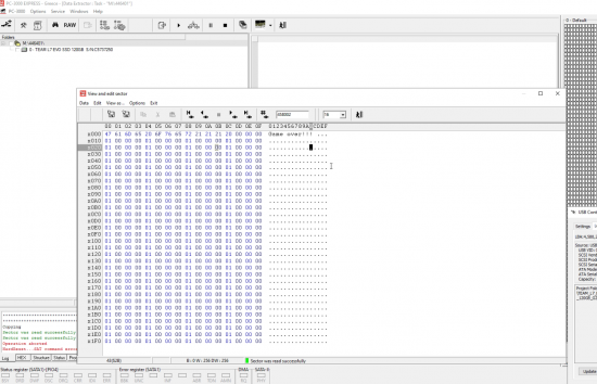

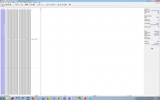

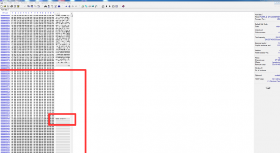

Hi all,
Maybe someone has seen this?
This is the 4th drive we get with the same behavior. The first one we saw in 2017, then we got 3 more until today.
All 4 drives are TeamGroup branded and model is L7 EVO.
They would read green sectors and append a "Game Over!!!" signature in a loop.
All other sectors are zeroed.
The controller seems to work (I've tried changing one byte and changes were saved successfully).
The first drive we got in 2017 would have an intact MBR and then nothing. The other 3 drives were simply zeroed with this signature (no MBR or other meta).
It's very, very strange to me.

I would suggest to dump the firmware and grep for "Game Over", perhaps it's a way for the firmware to signal a bad sector read.

That's a Marvell 88NV1120 ssd controller inside with a failed translator module. That's how it behaves when the translator is gone. Unfortunately no commercial tool is able to work with this controller (correct me if I'm wrong).
There is a tool that can repair the ssd, by rebuilding the translator, but of course, you'll loose all the data in the process.

Thanks everyone for your feedback.
I dug a little into the fw as suggested by sourcerer.
ccc is right, signature comes from drive's fw when translator is gone.
