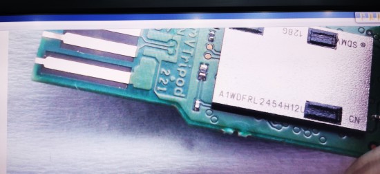

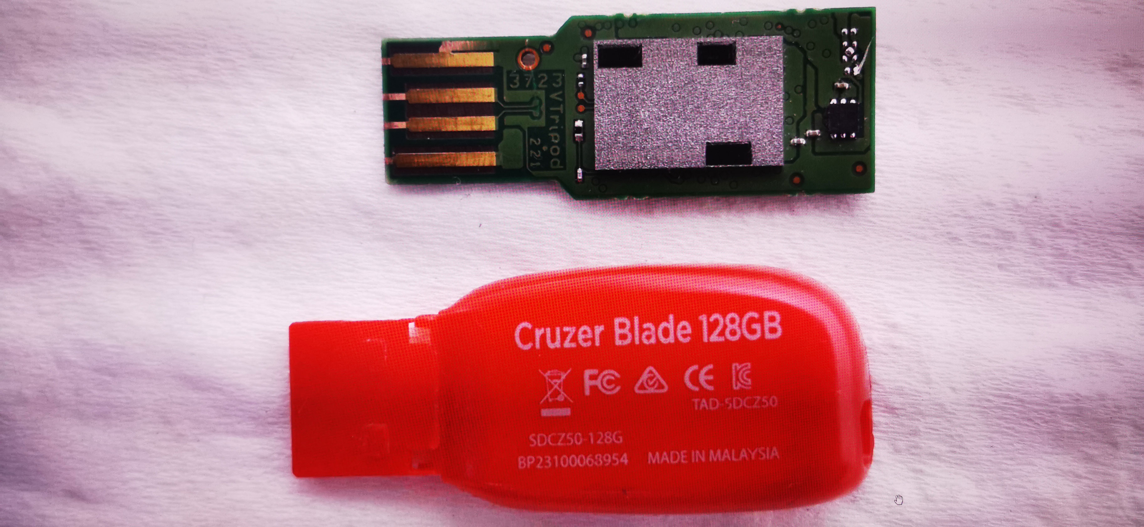

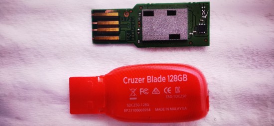

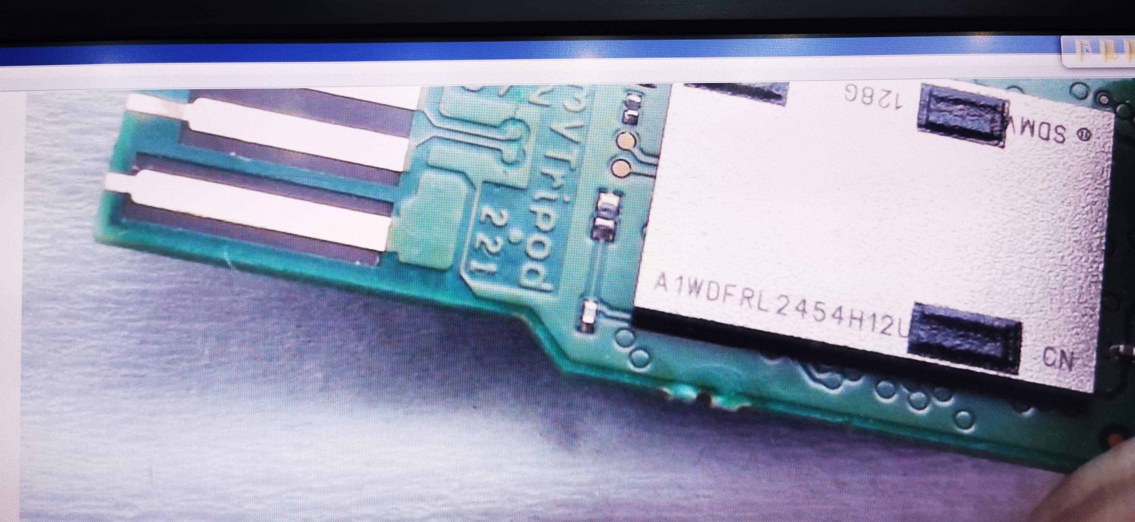

Hello guys,,
Anyone have an idea if there is a way to read this nand?
Full dump i mean..
BGA315
Thnx

I've no idea how to read it, but I heard also this SanDisk uses LDPC ECC and adaptive XOR... So data recovery may be a really pain in *ss.

Is there a controller on the other side of PCB or is it a FLASH with integrated USB controller?
 Post subject: Re: Sandisk BGA315
PostPosted: October 20th, 2024, 19:40
Joined: July 8th, 2019, 12:27
Posts: 162
Location: 中国大陆浙江省湖州市
I did some research on it, but currently I can only read 1CE/1LUN. This type of flash memory typically contains multiple LUNs. However, I cannot find the second physical CE. Changing the address range doesn't help either. So I can only read 1/2 or 1/4 of the chip's capacity.
