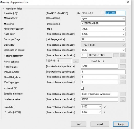

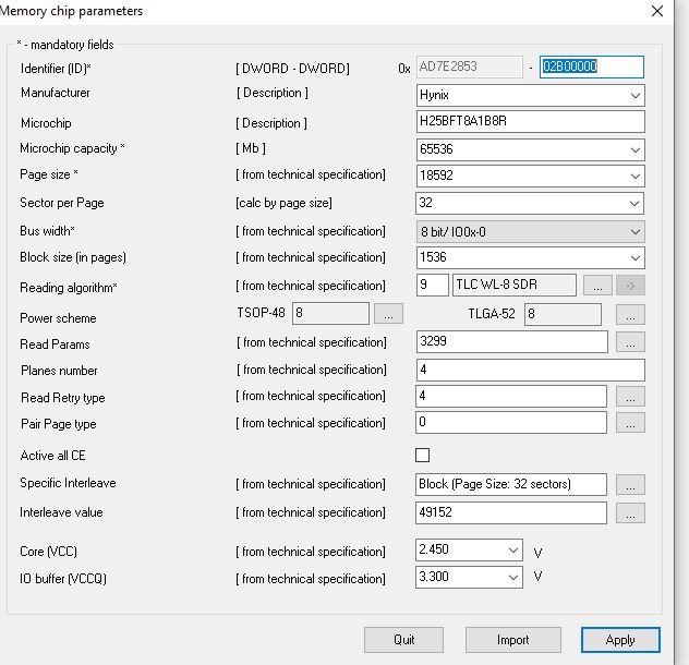

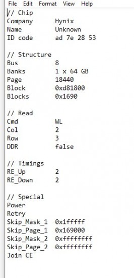

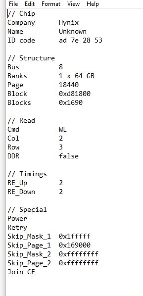

Im still working on this pair of AD7E2853 . FE appears to have the better read/ecc/reread on them. When I come to import the dumps into PC3K it errors as the page size is different. FE 18440 and PC3K 18592.
I was going to add a new chip to PC3K to mirror the settings from FE's chips.txt but trying to add a chip gives a "floating point division by zero" error. Can anyone give me a quick explanation as to why there's a discrepancy between the 2 chip profiles and how I can interpret the settings so I can use the dumps interchangeable.

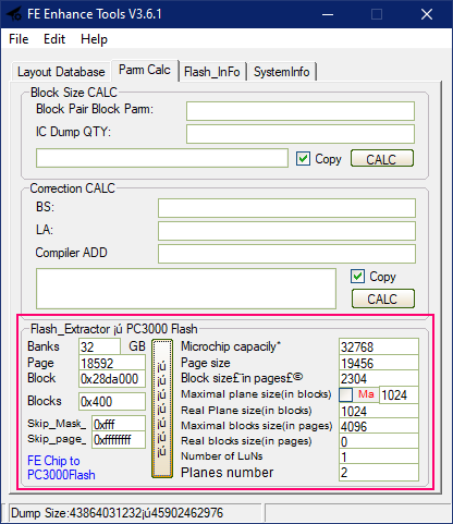

You wanna try this? ..

The chips are 64GB each but yes that appears to be the sort of thing I need.

The structure it produces is vastly different from that of the original pc3K entry. I was able to avoid the runtime error in pc3K by exporting the original, importing and then editing the import.
Looking at the bitmap it has produced the imports don't look to be viable though.
FE and PC3K original parameters attached. Currently scanning for ECC on the new import just in case but nothing found so far.
