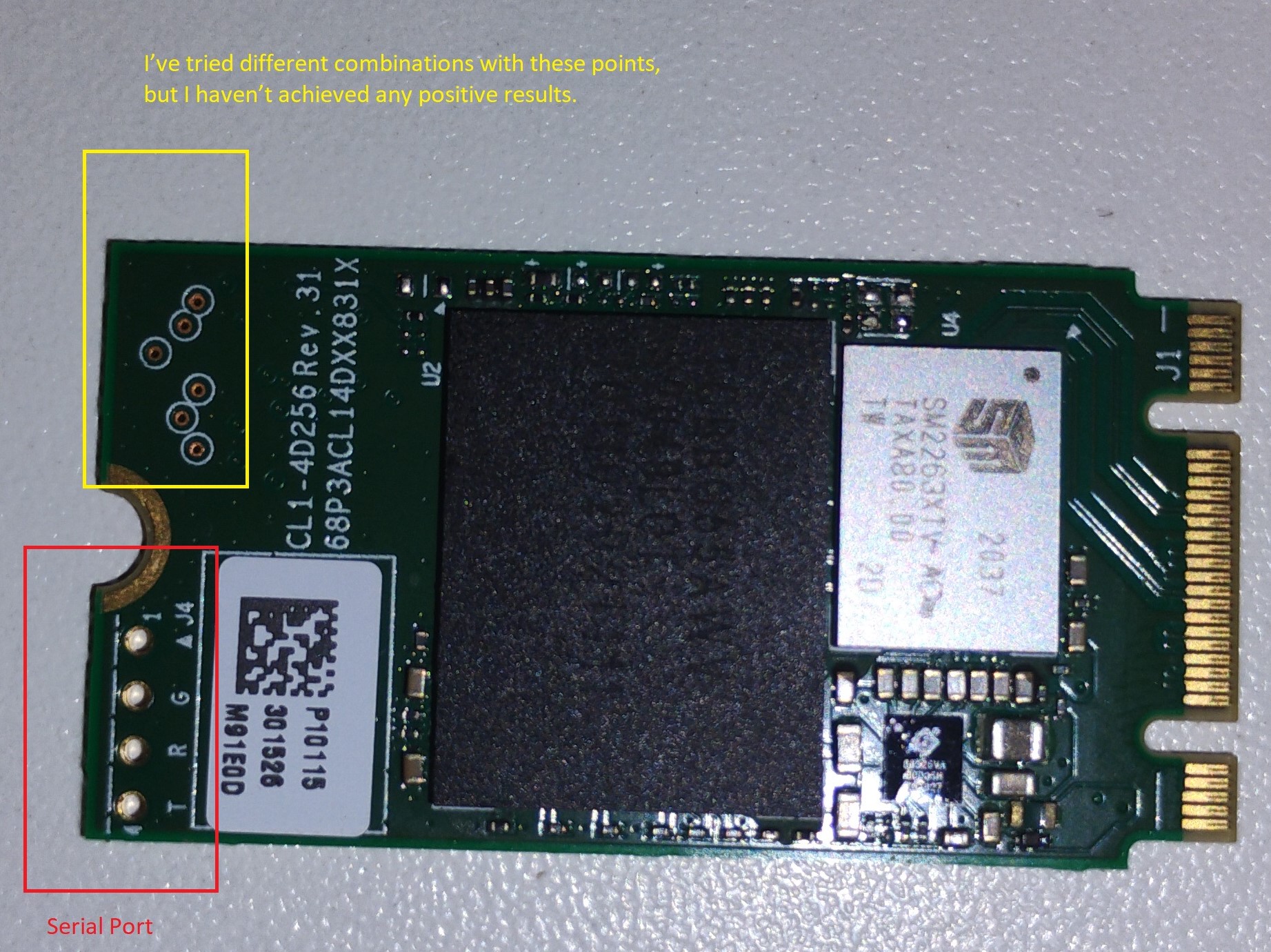

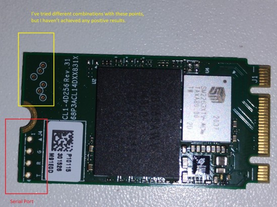

Hello everyone, how are you?
I’m writing because I’ve received an SSD, model CL1-4D256-D22, whose controller is supported by SM2263XT on the PC3K. However, I’m unable to locate the short circuit point. If anyone has worked with a similar disk and can guide me, I would greatly appreciate it.
I’ll be attaching images of the disk for better clarity.
Thanks very much and my best regards

Safe mode 1 + G
