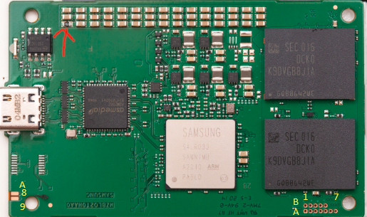

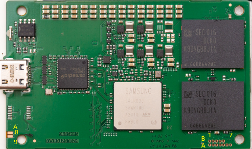

hello,
I have a T7 and when I try to use it, it fails :(
so I decided to open it !
please find enclosed PCB picture . there are a line A ( 7 pins) , a line B ( 5 pins) on the right and 2 pins on the left.
I took value from GND to a pin :
A1 - GND
A2 - 2.3V
A3 - 3.28V
A4 - 0
A5 - 3.28V
A6 - 0
A7 - 0
A8 - 3.28V
A9 - 3.28V
B1 - 0
B2 - 3.28V
B3 - 2.3V
B4 - 1.8V
B line looks to be voltage part
i tried to short pin A6 and A7 during boot. After that, I used a jtagulator to find a JTAG or uart port with without success :( maybe it is an issue with the controller
do you know if safe mode pins are on the A8/A9 ? if someone has pinout for this ssd, I'll be happy to test !
KR

This looks strange, could it be shorted? You can safely remove it and make sure that it doesn't short anymore, there are enough capacitors nearby

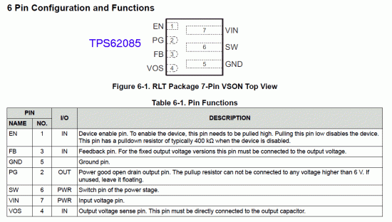

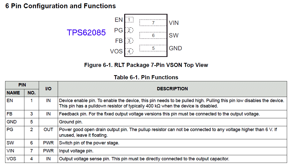

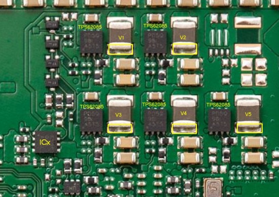

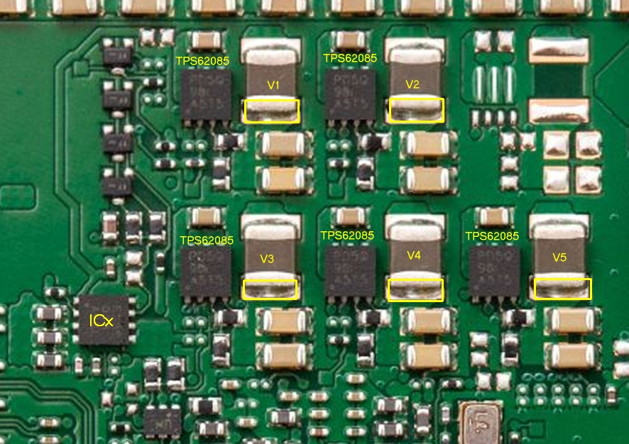

Measure the voltages at V1 - V5.
Can you tell us the markings on "ICx"?
Also check for shorts at the ESD protection diodes:
https://www.hddoracle.com/viewtopic.php?f=100&t=1615&p=24636#p24636
TPS62085, Texas Instruments, adjustable 3A Step-Down Converter with DCS-Control and Hiccup Short Circuit Protection, 2x2 HotRod Package, marking PD5Q, 7-pin:
https://www.ti.com/lit/ds/symlink/tps62085.pdf

I think ICx is an e-fuse. Compare the Vin and Vout voltages.
TPS259535DSG, Texas Instruments, 2.7V - 18V, 4A, 34mOhm eFuse With Fast Overvoltage Protection, 5.7V clamp, Auto-retry, marking ES35, WSON-8:
https://www.ti.com/lit/gpn/tps2595

please find below values from V1 to V5
V1 : 3.28
V2 : 2.53
V3 : 1.04
V4 : 1.81
V5 : 0.89
ICx looks to be a ES35 188 A3RL but I didn't find the datasheet. Btw i took voltage on pin 4 (Vin?) et 5 (Vout) and both are 5.1 V
