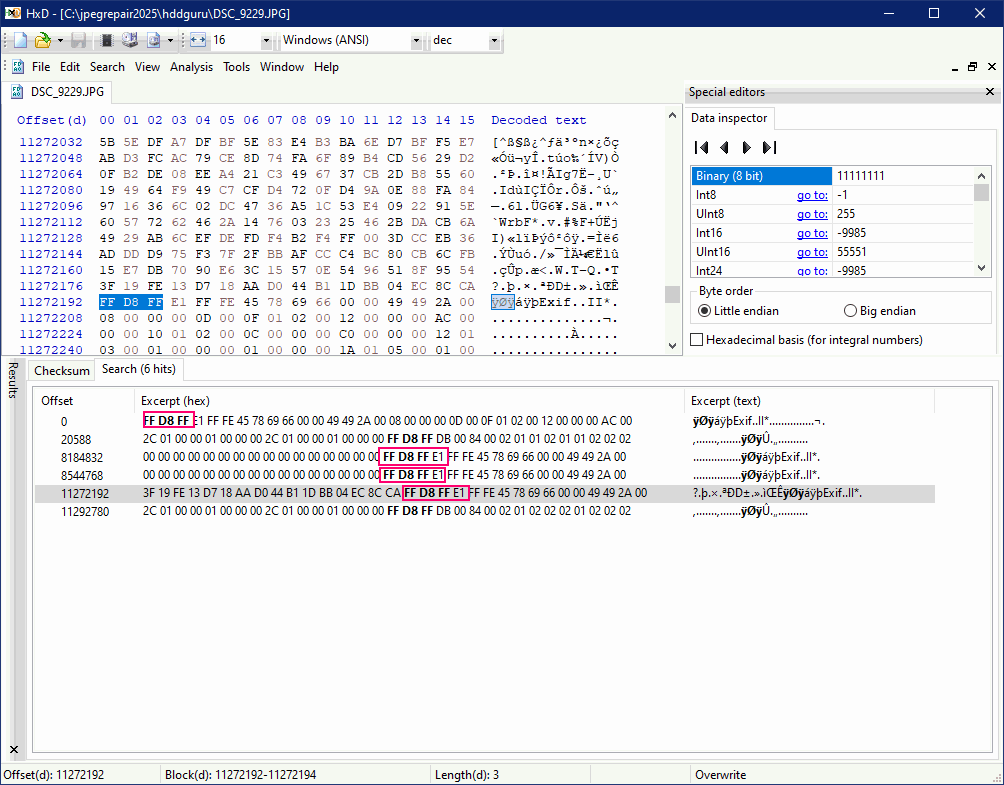

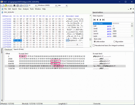

File is a mess, contains 4 JPEG starts.
So you want software to do what exactly? Were they recovered FS based or signature based?

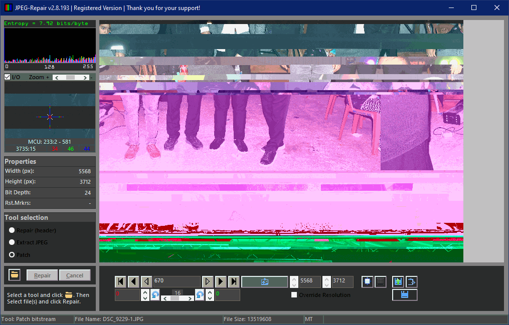

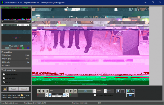

If you decode all parts, you get a mess too ..
