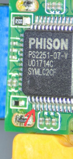

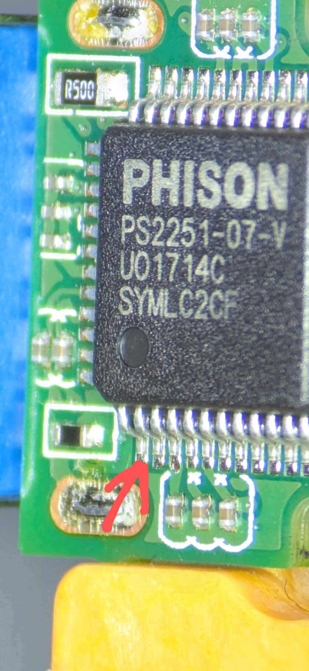

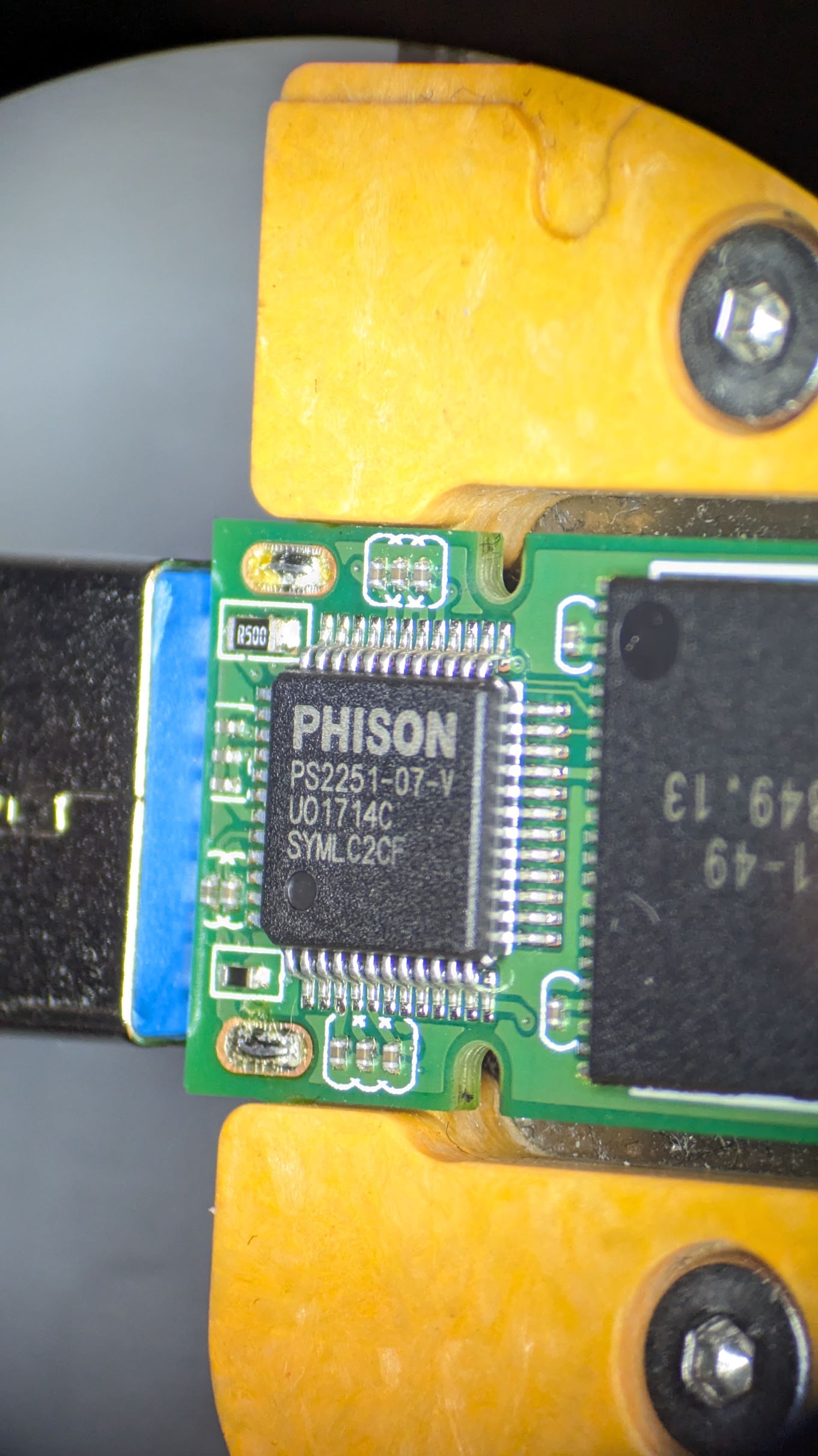

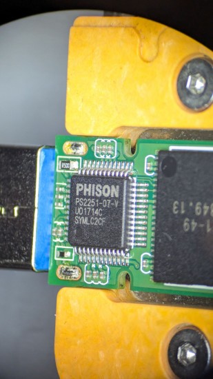

I would like to use this opportunity to ask about USB flash drive data recovery.
I hate to be a "please bro" but I also hate to be misinformed.
Kingston 100 G3 USB 3.0 DataTraveler 64GB:
1. Not detected in windows or R-Studio
2. Voltages present, but I can find proper data sheet or schematics/boardview. This is the first time I attempt something like this
3. It gives a chime when connected but then I get "USB device not recognized" error
4. Nothing is getting warm, checked under a thermal cam
I managed to find this:
http://flash-extractor.com/library/PS/PS2251/PS2251-07-V/PS2251-07-V__2c_84_64_54__2x2
But I don't know what I'm looking at.
Also those:
https://www.usbdev.ru/cics/icphison/
https://monitor.espec.ws/files/ps2251-33_datasheet_700.pdf
I did some basic measurements and there is a short on pin 1 (marked on the picture)
My questions are:
1. Can I get 100% identical flash drive and transplant both chips to the working one?
2. Can I get an adapter and read contents of those chips without expensive tools or software?
If yes then could someone point me in the right direction?

In one of the ssd drives I found a line that has 12V and goes under the NAND, so that one if fried I assume. Power IC failure?
I usually work on macs, and there is always a schematic and a boardview. When it comes to ssds I am kinda lost, cant even find datasheets for most of the chips.
Enterprise SSDs sometimes use the SATA 12V supply, but consumer SSDs are 5V-only. Some consumer SSDs will generate a 12V supply from the 5V supply via a boost converter within the PMIC. This supply is used by the NAND during writing (and some other purposes which I don't understand).
I have a database of SSD/HDD datasheets at hddoracle.com.

- It was heating up significantly and was consuming roughly 3x times the power of almost identical working SSD
That should be an easy enough short to find then. Check the resistance on each of the power rails. If you don't know where they are follow VCC from the connector.
Data Traveller - that's not shorted, it looks to be PO_FLH_REB0 active low.
It's more than likely the dive has failing nand rather than anything else and will need chip off recovery. You have already found FE, VNR or PC3000 Flash are also options but will dent your wallet around 4-5K, it's far more cost effective to sub the odd flash drive out than do them in house. As the issue is with the nand not the controller or pcb moving them to another stick is likely just to move the problem.

My questions are:
Some times yes, sometimes no. https://youtu.be/HkLxV6q7Yww
No, these tend to be expensive. Even if you dump the data, it will be a binary blob. Not a neat scannable file system.
