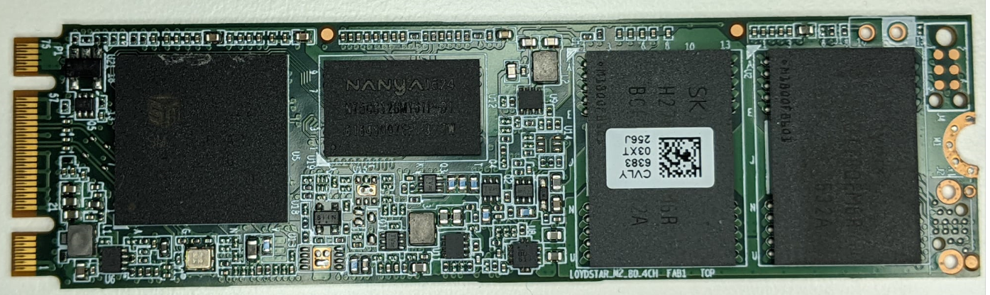

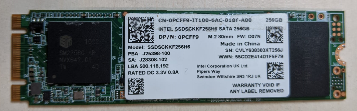

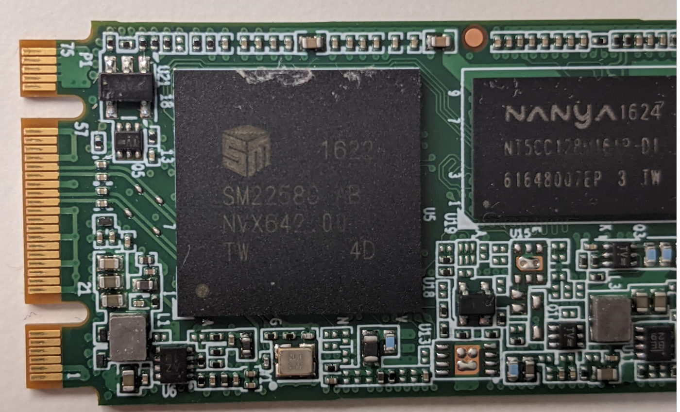

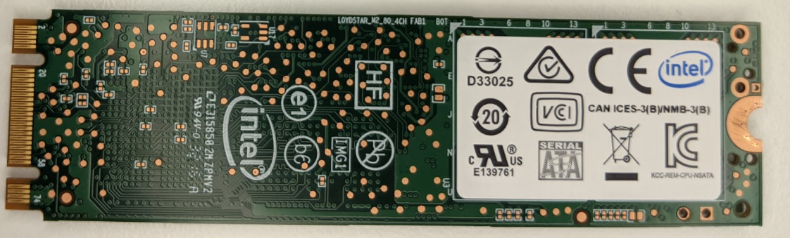

Hello everyone,
I got this Intel M2 yesterday from a member of my family. SM controller 2258G. I search on this forum for those reference, no luck.
None of the chips get really hot, Sata to controller capacitor are ok.
does anyone know if there's a terminal access on those M2 ? ( I missing conventional drives :? )
I tried to mount it using USB to M2 adatper, nothing (If I connect CX1-GB512 M2, it mount directly).
I tried on PC3K but goes BSY, I don't think this model is supported however I am not sure exactly how Intel define model... PC 3K support (Postville 320 & 710 series and X25 & X18) and one Intel Marvell 510 series.
DP/N 0PCFF9
FW D07N
Model SSDSCKKF256H6
PBA J25398-100
SA J28308-102

The print on the PCB suggests that it is designed for the "Loyd Star" codename.
Wikipedia's references to this family identify the controller as Silicon Motion SM2256 ???
https://en.wikipedia.org/wiki/List_of_Intel_SSDs

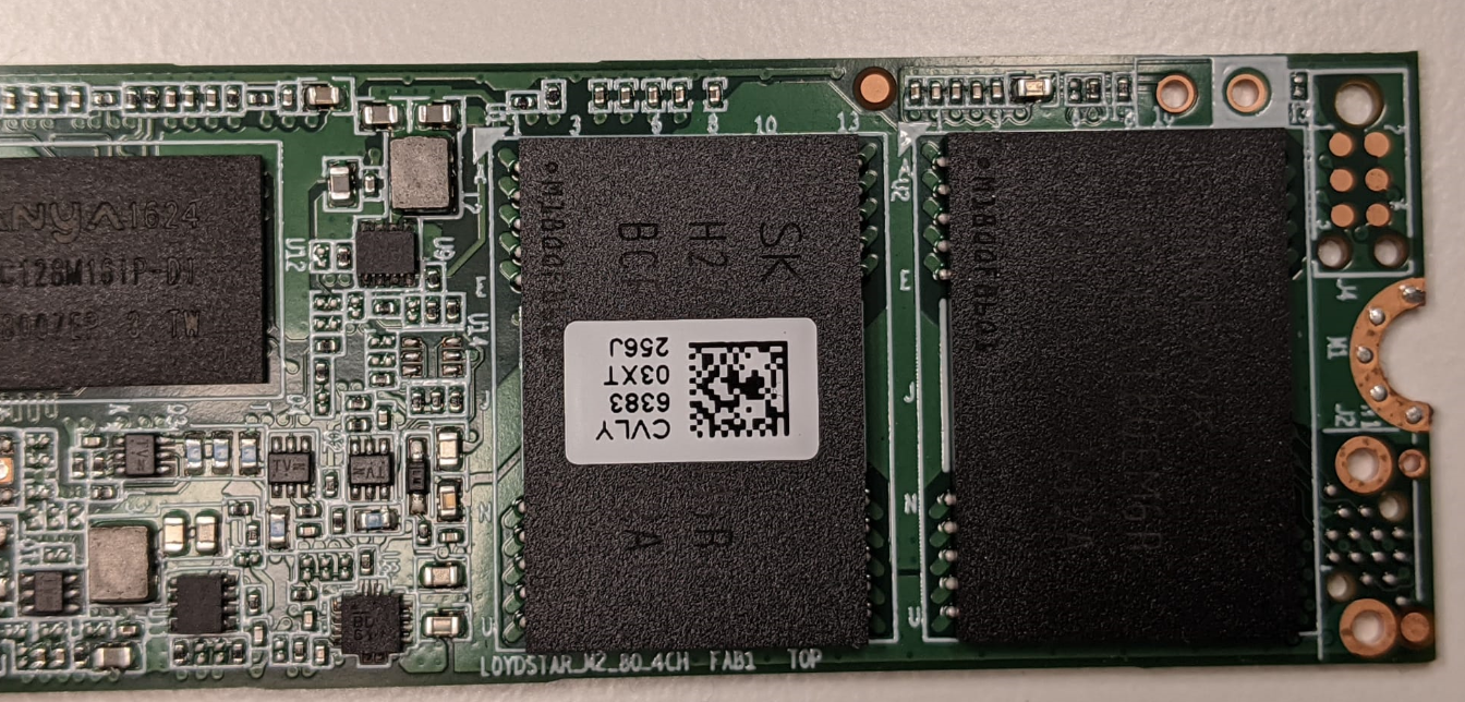

I suspect that the two test point at the top right corner of the first photo may be for "ROM mode". The left pad appears to be connected to a pullup resistor, in which case it should be safe to short it to ground. But you'll need to verify that for yourself.

Thank you for your help, that's awesome. I'll will investigate.

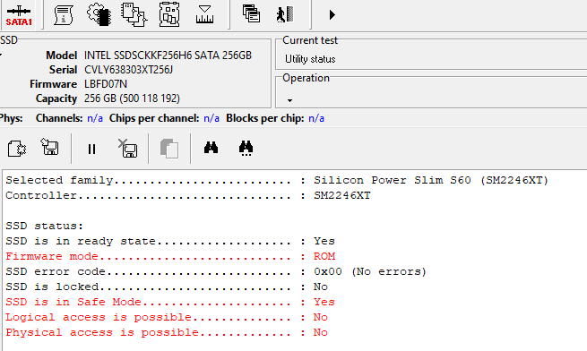

With the great help of fzabkar, I was able to access the data using PC3K terminal and DE. Happy end, case closed

Adding pics as I got some request.

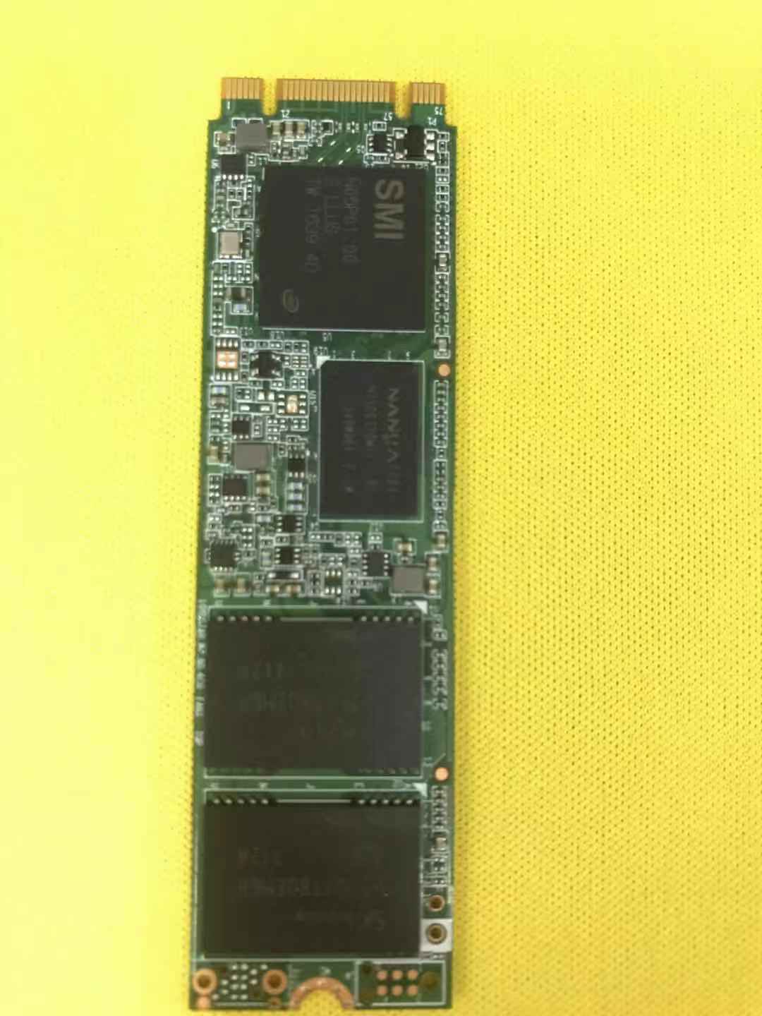

I have a same model SSD, but terminal can't access.

I have a same issues intel 2258 SSD, how to access terminal?

If you can't reach ROM mode, then look for electronic faults.

Thank you Fzabkar. I can reach ROM mode, is there any way to access termimal?

AFAICT, "technical" access is via SATA.
https://blog.acelaboratory.com/pc-3000-ssd-silicon-motion-sm-utility.html
