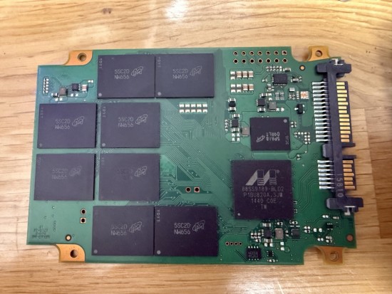

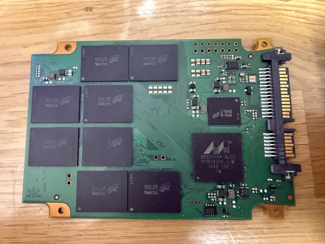

i got a Micron M600 - and get's ready fast, but no data access possible - ID correct, size correct, chips connection looks fine.
tried to create translator, but not possible (of course it's not supported - but trying is always good)
tried heating up, cooling down - nothing helps, when try to ready via utility, i get sectors, but useless of course without translator.
any ideas? when try to open with universal utility it tells me something about SMART error.

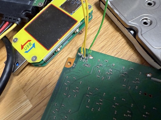

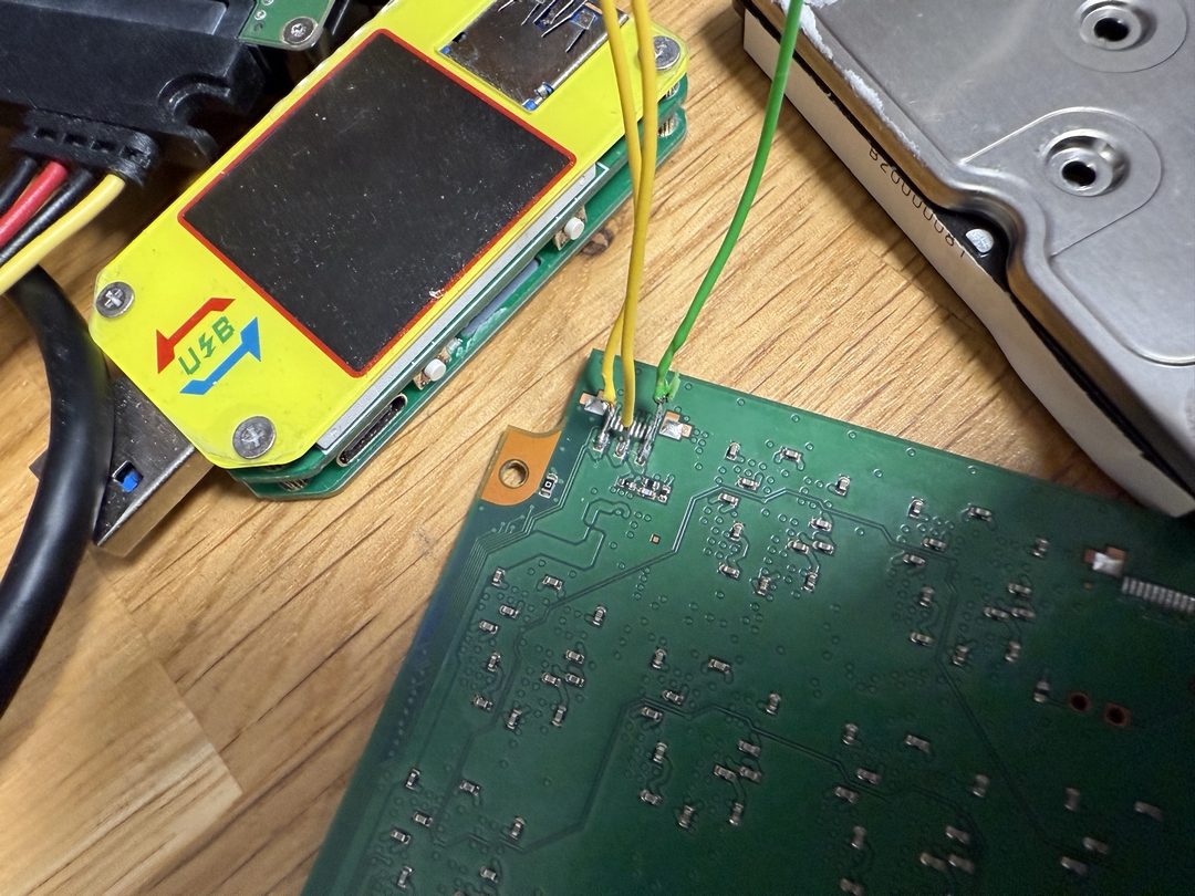

On the other side of the SSD, there are three contacts, the middle one being ground
Re: Micron M600 SMART
October 22nd, 2024, 14:49
so you mean those 2(3) correct? - the middle one is ground, RX TX on the others, tried both directions (3,3V)
Nothing happens there on terminal :(

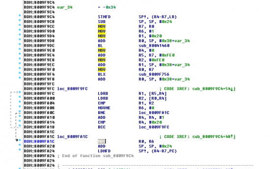

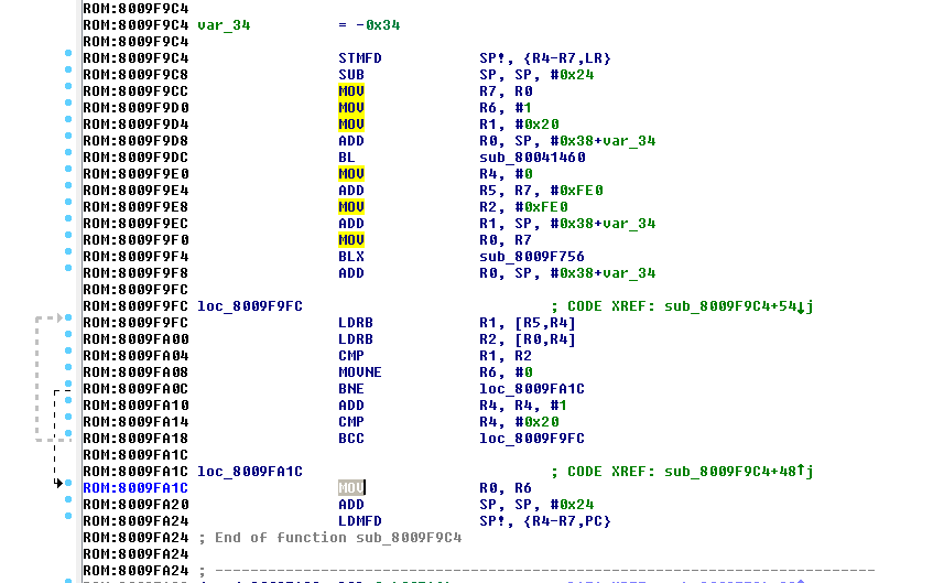

JTAG connection was straightforward. even openocd auto detected ID which later found in dragonite target
there are several sections in NAND and one of them is firmware, which is working, otherwise there would be no boot or possibility to access commands from UART as all these commands are in NAND fw, not in bootcode that resides in NOR flash
i think i should try to download fw from NAND, not sure yet how. maybe the fw loaded into memory is 1:1 copy of the NAND and hasn't been modified in any place. that would make it easy
looking for strings in several downloaded fw updates there is Write Protect, Status and also SED error (this message is stored in NOR log with code 10C). first should load fw from NAND into disassembler then look around these messages
in UART outputs noticed there are several 'pending rebuild' tasks, might be worth to try trigger these rebuilds somehow to see if they can reassemble lookup tables
February 22nd, 2025, 13:57
westcoast wrote:maybe the fw loaded into memory is 1:1 copy of the NAND
of course this wasnt the case. it appears is executed at the load address and some other parts split it, so it ends up at larger offset than its length+load addr
load addr is 0x80002600
M603 seems almost identical to MU05
the code has changed in place where old bug needed to be patched to reset the drive to factory settings, but if it is still a problem it seems it can be easily patched even in new firmwares
not important at this point
when booted after failure idiot reset all important parameters, like metainfo. this could be DSSR data or section in NOR at 0x100000

the failing block is the first one with IsSLC:0 in the log
RBIT command with multiple DUAL COPY FAIL messages
who knows how to flash fw on these drives? first the NAND part (aka fwa) then bootloader and msp (aka fwb and fwc) is it the right order?
