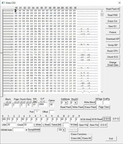

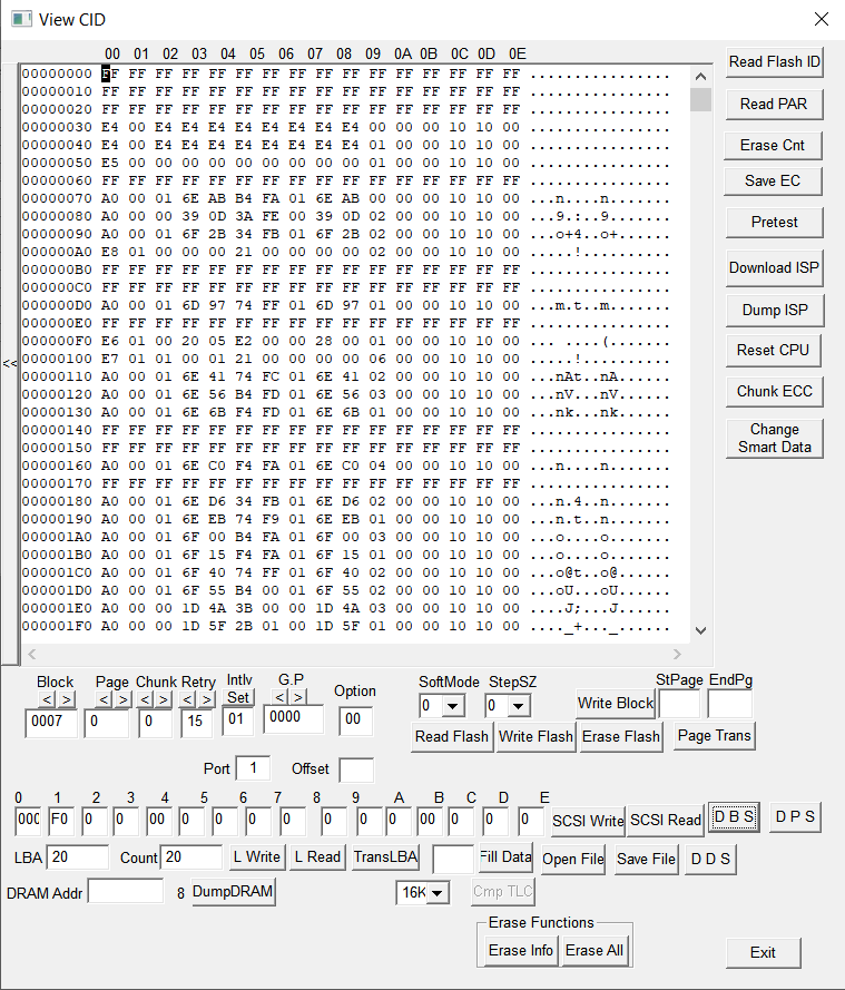

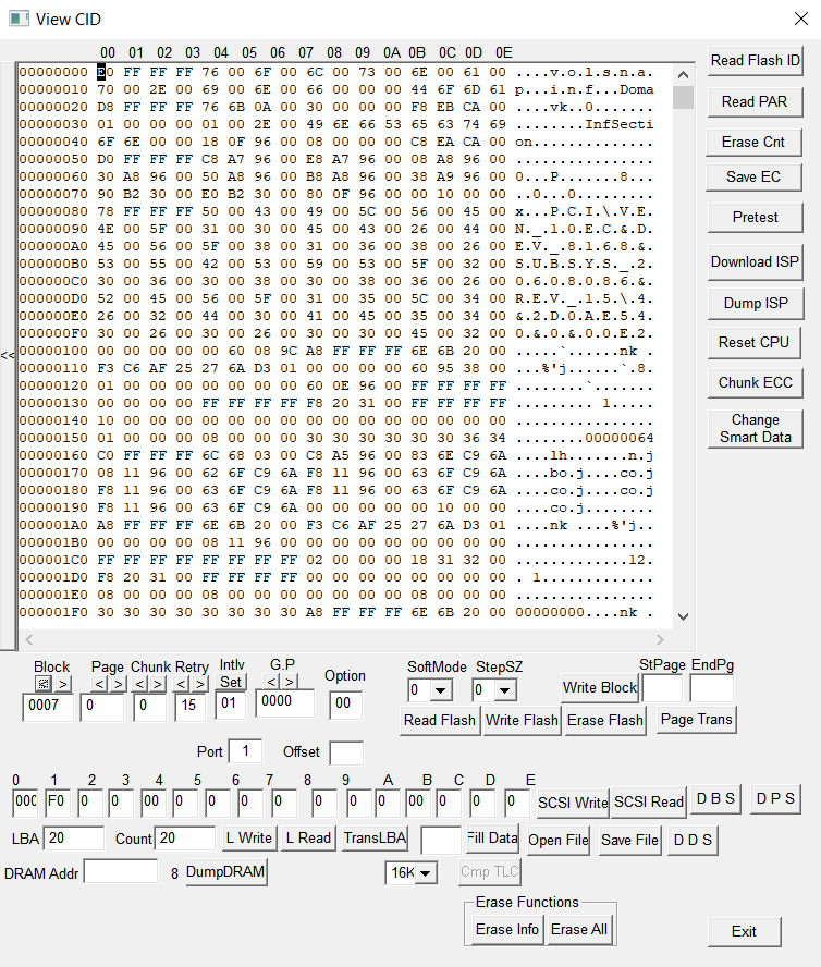

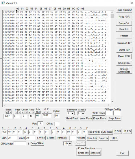

I get some kind of success with SMI Mass production tool. It has "debug mode", allowed me to load MPISP and get a kind of physical access to the NANDs.
But i got stuck here. Does anybody know how to figure out where the translator is?
This tool has some buttons like DBS, DPS, DDS. I saw that abbreviations in the EasyTools as well, but don't know what this stands for.
It probably shows some infos about the Block and page type, but again what are the types of particular pages?
For example there are:
Pages with 0xA0 type, looks like user data (visible NTFS strings)
Pages with 0xE4 type, looks like firmware
Pages with 0xE5 type with header 'SmiIndex'
Pages with 0xE8 type with visible strings like 'AC70202' or so.
What im planning to do is to write some app to read the pages out of the device and try to rebuild the drive image.
But don't know how to find the translator.
Is there someone who can shed some light on this?

The translator is located in pages with codes 0x64, 0x66, 0x68. But you should know that the translator is made up of many pieces, each with a version. And to assemble a translator that was up-to-date at the time of the death of the drive is still a hell of a job.
But even assembling the translator itself is only half the work. Still need to read the data. And here there is a problem, the solution of which, if known, is to a very small circle of people. MPISP for this controller can only read pages written in the pSLC format. And this is only 20-30% of all data (SLC cache). Garbage is read instead of other user data (MLC or TLC format).
If you find a solution, write. It will be interesting to read.

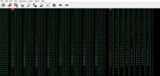

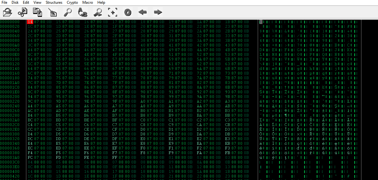

Thanks a lot. I can find many pages with 0x64 and 0x68 ID.
After loading MPISP the program reports that drive has 1000215216 of total LBA. It makes sense, because it's 512GB drive.
In the dumped page of the 0x64 type i see a lot of 32bit LE-organized blocks of data. But how to translate them from LBA to Physical Block->page->channel and so on?
Is the 4-byte number an LBA number? The incrementation is 1 unit of something, so it probably makes no sense to be an LBA number, since page size is 0x4000 bytes and LBA is only 512 bytes.
So each page can contain 32 LBA-512 sectors. Can you tell something more about that pieces and it's versions? Is there any documentation of this stuff?

 Post subject: Re: Plextor S2C with SM2258G controller
PostPosted: February 7th, 2022, 5:17
Joined: May 12th, 2015, 5:37
Posts: 35
Location: Russia
There is no documentation and it is unlikely to be. I can’t give a lot of advice, because it's kind of a trade secret. Therefore, you will have to deal with most things on your own. Although sometimes I exchange information. But only in exchange for other information of interest to me...
The SSD does not operate directly with channel, chip, block, and page addresses. There are superblocks, which consist of pages of one or more blocks of one or more channels. These superblocks are composed according to a certain law.
The translator addresses the space within these superblocks. The addressing unit is not a page or a sector, but an area, 0x1000 bytes in size. Thus, one 4-byte record in the translator addresses 8 LBA sectors.
Perhaps that's all. Further yourself.
