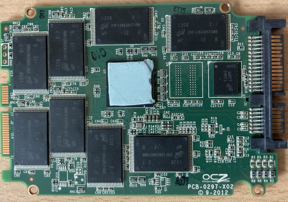

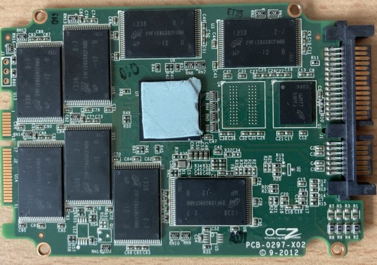

Hi All !

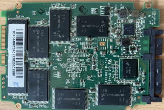

My ancient SSD burned out. I want to restore information. I found a capacitor that is heating up a lot, but I don't know what to replace it with. C105. Thanks in advance for your suggestions.
 Post subject: Re: OCZ Vertex 450 schematic
PostPosted: May 3rd, 2024, 11:53
Posts: 17230
Remove it and run the SSD without it.

Do you think it is just filter, 1uF ?
PostPosted: May 3rd, 2024, 13:26
Posts: 17230
There doesn't appear to be any DC-DC converter on the other side of the PCB, so I think it's probably a filter.

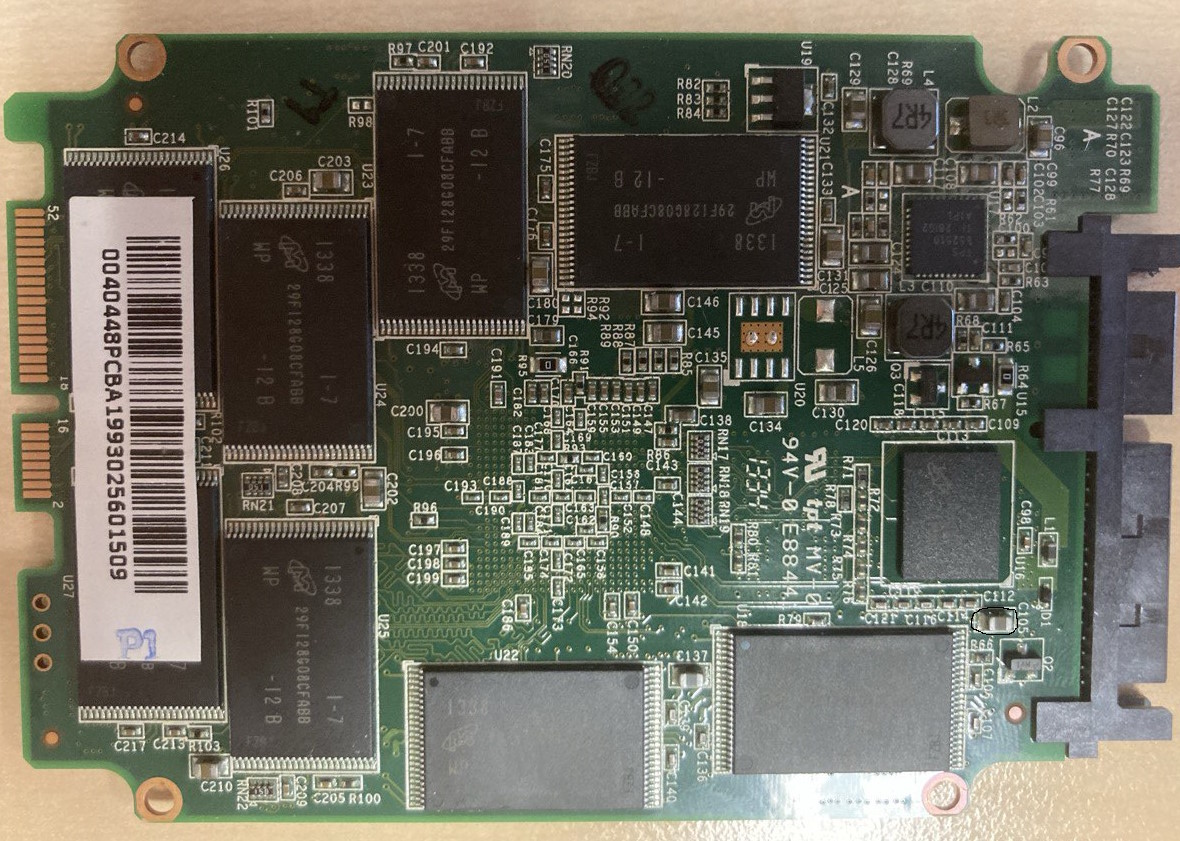

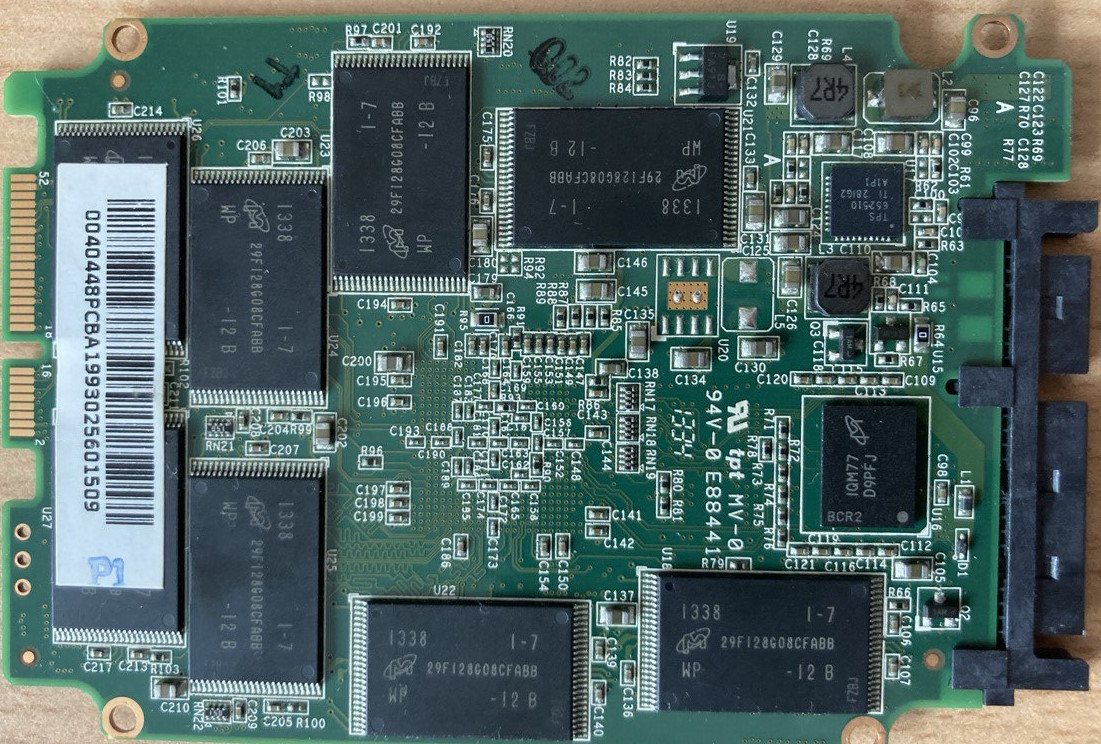

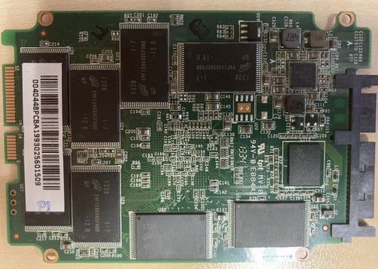

How to understand where to measure DC ? Do you think inductors like L1 and so on can be good points ?
PostPosted: May 4th, 2024, 14:03
Posts: 17230
Measure the voltages at L2, L3, L4 adjacent to U17 (TPS652510).
https://www.ti.com/lit/ds/symlink/tps652510.pdf
I can't identify the markings on U19, but I suspect that this is an LDO regulator.

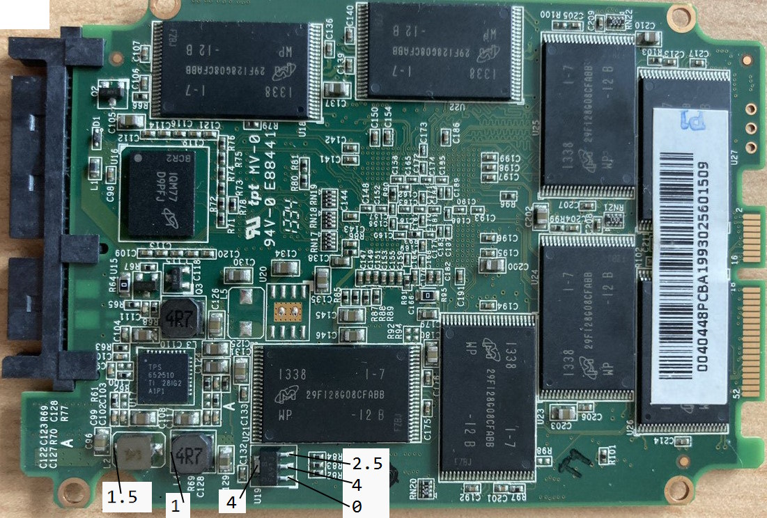

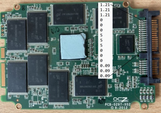

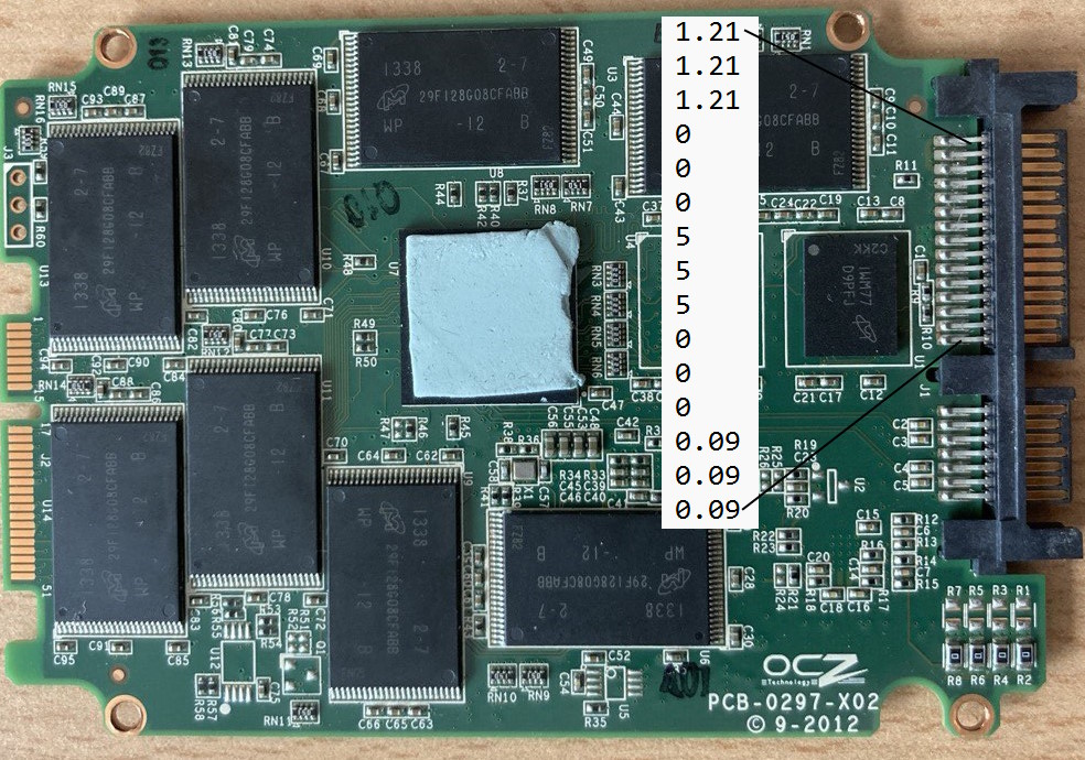

L3 - 0
and see pictures. I have tried to find more as 5V, but not.
PostPosted: May 6th, 2024, 15:54
Posts: 17230
Measure the resistance between L3 and ground (any screw hole). If this is shorted, then hopefully it will be due to a shorted capacitor. The missing voltage at this point appears to be ~3V, which is the Vcc for the NAND flash array.
BTW, I don't understand why you are seeing 4V instead of 5V at those test points. :-??

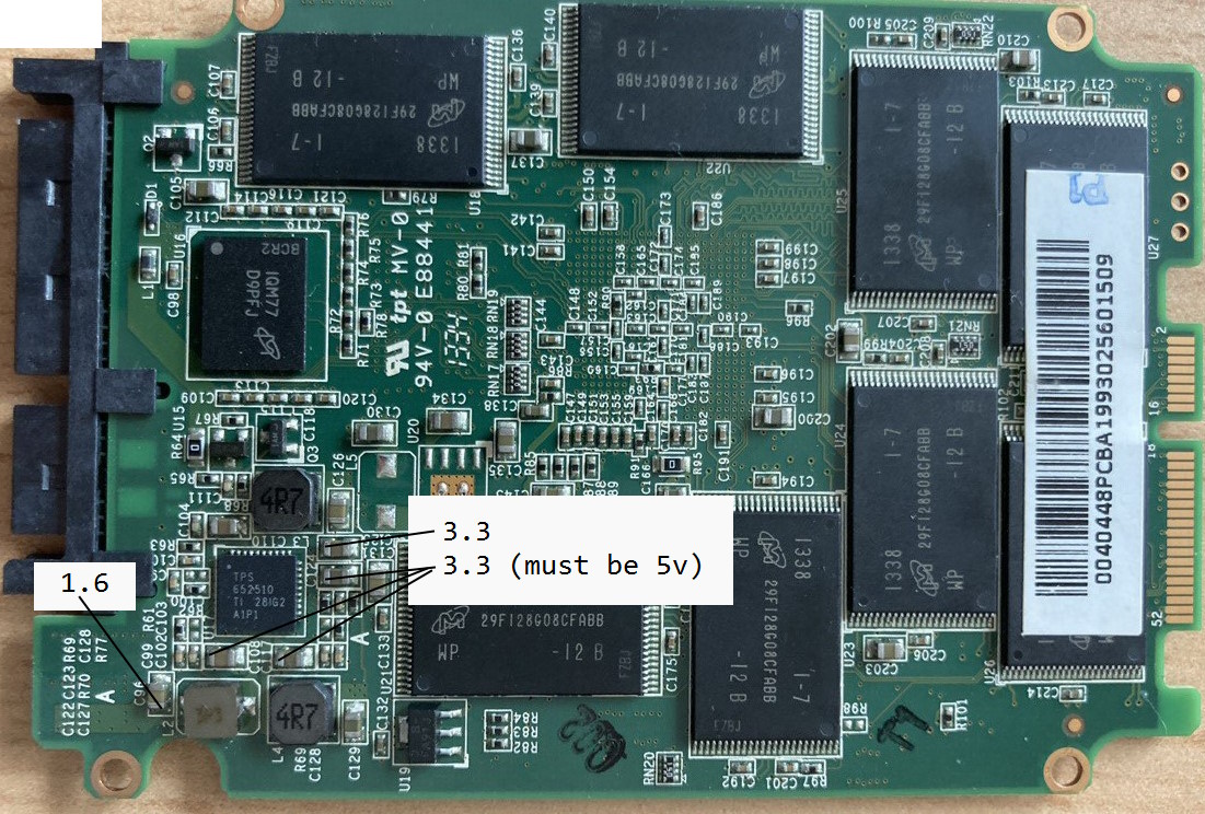

As you see input is 5V, but on LDO is 4V. Seems some element is draining 1V.
According PDF :
Buck1 = 1.2 V Buck2 = 1.8 V Buck3 = 3.3 V
PostPosted: May 6th, 2024, 16:37
Joined: May 3rd, 2024, 6:14
Posts: 11
Location: Germany

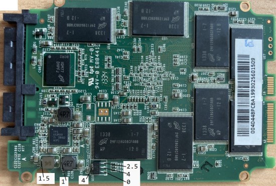

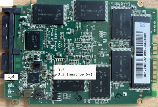

have not found 0R on L and capacitors. But voltage is less as expected in many points.
See pic.
PostPosted: May 6th, 2024, 17:40
Posts: 17230
Check R64 (near L3).

I tested very carefully all capacitors. Except this list all of them as expected:
C55 - 75 Ohm
C129, C184, C155, C146 - around 90 Ohm.
PostPosted: May 6th, 2024, 18:38
Posts: 17230
Maybe I was wrong about the screw holes. Instead, I would use SATA power ground as the 0V reference.
There is a small inductor, L1, in series with the 5V supply.
A resistance of ~100 ohms is normal for the Vcore supply for the flash controller.
What is the resistance between the Vin pins of the LDO regular, DC-DC converter and SATA 5V?
Check the ENable pin for the 3.3V converter.

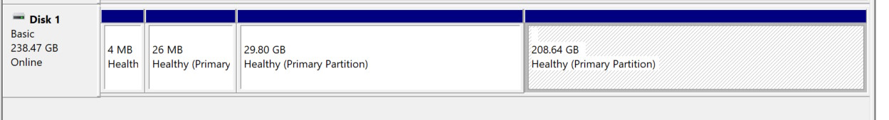

Thanks a lot. You are wizard :) Resistance was higher as expected to have on L1, I replaced it to any I have and just see picture.
Now all measures are 5V, where before were 4V.

It appears that the failure of C105 may have stressed L1.
