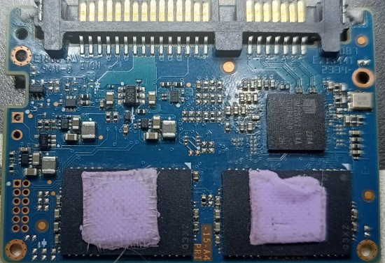

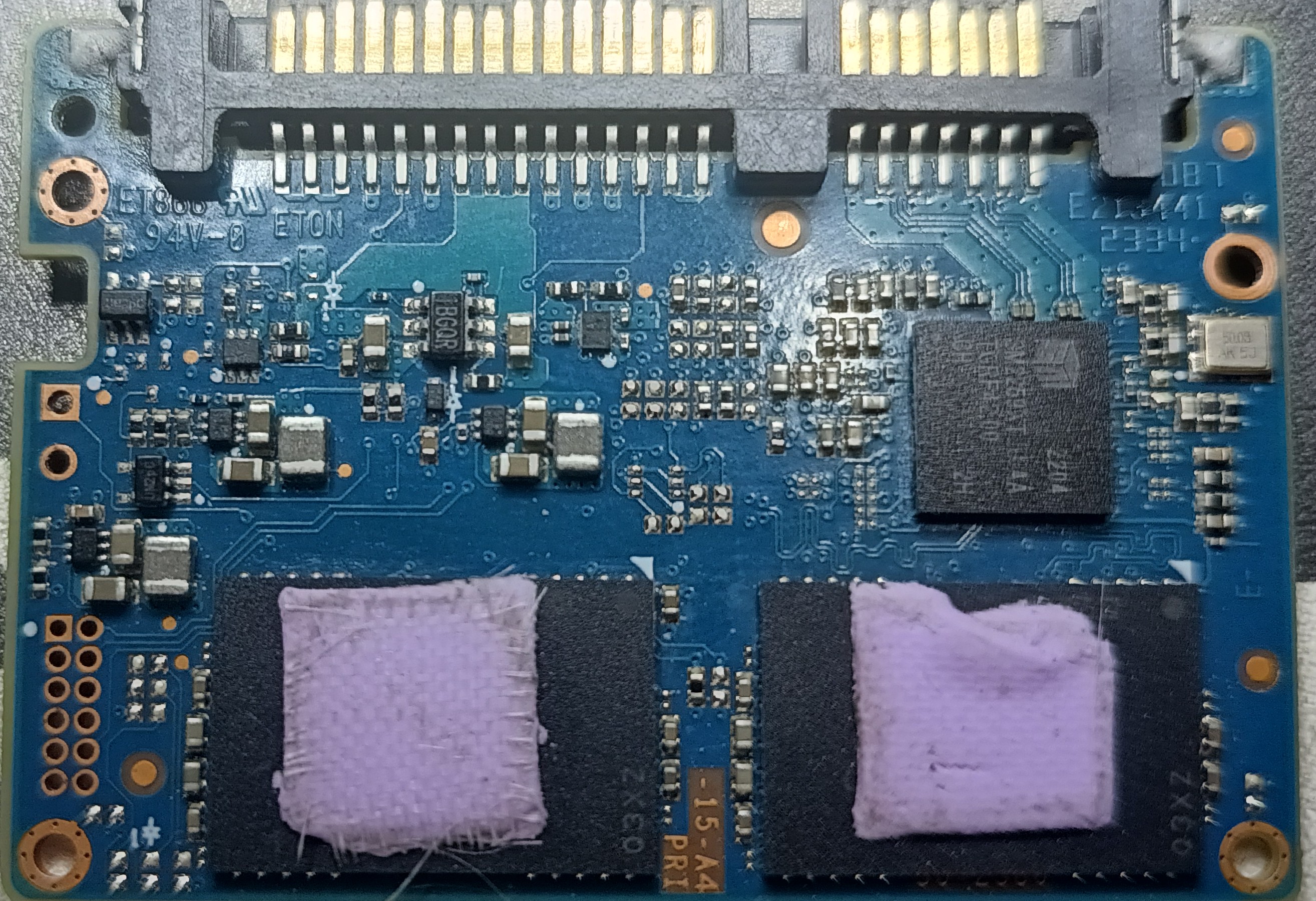

 Post subject: Crucial bx500 1tb no power
PostPosted: May 19th, 2025, 12:52
Joined: November 11th, 2023, 5:16
Posts: 26
Need help with this case
In pc3k utility no power at all
After making fast diagnosis ( no short to ground )
I need to know which component to measure to fix this problem
 Post subject: Re: Crucial bx500 1tb no power
PostPosted: May 19th, 2025, 13:21
Posts: 17256
Check the input and output of the e-fuse (Current Limit Switch):
https://www.monolithicpower.com/en/documentview/productdocument/index/version/2/document_type/Datasheet/lang/en/sku/MP5036A/
Then measure the voltages at each of the 3 inductors.

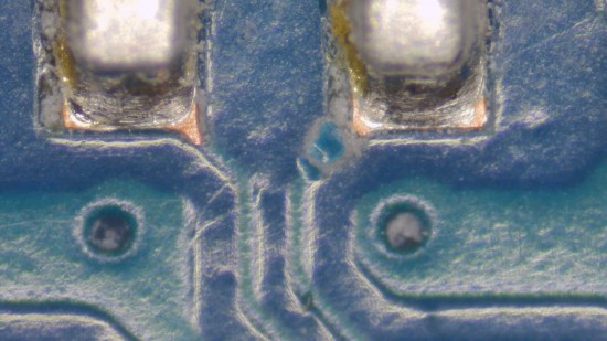

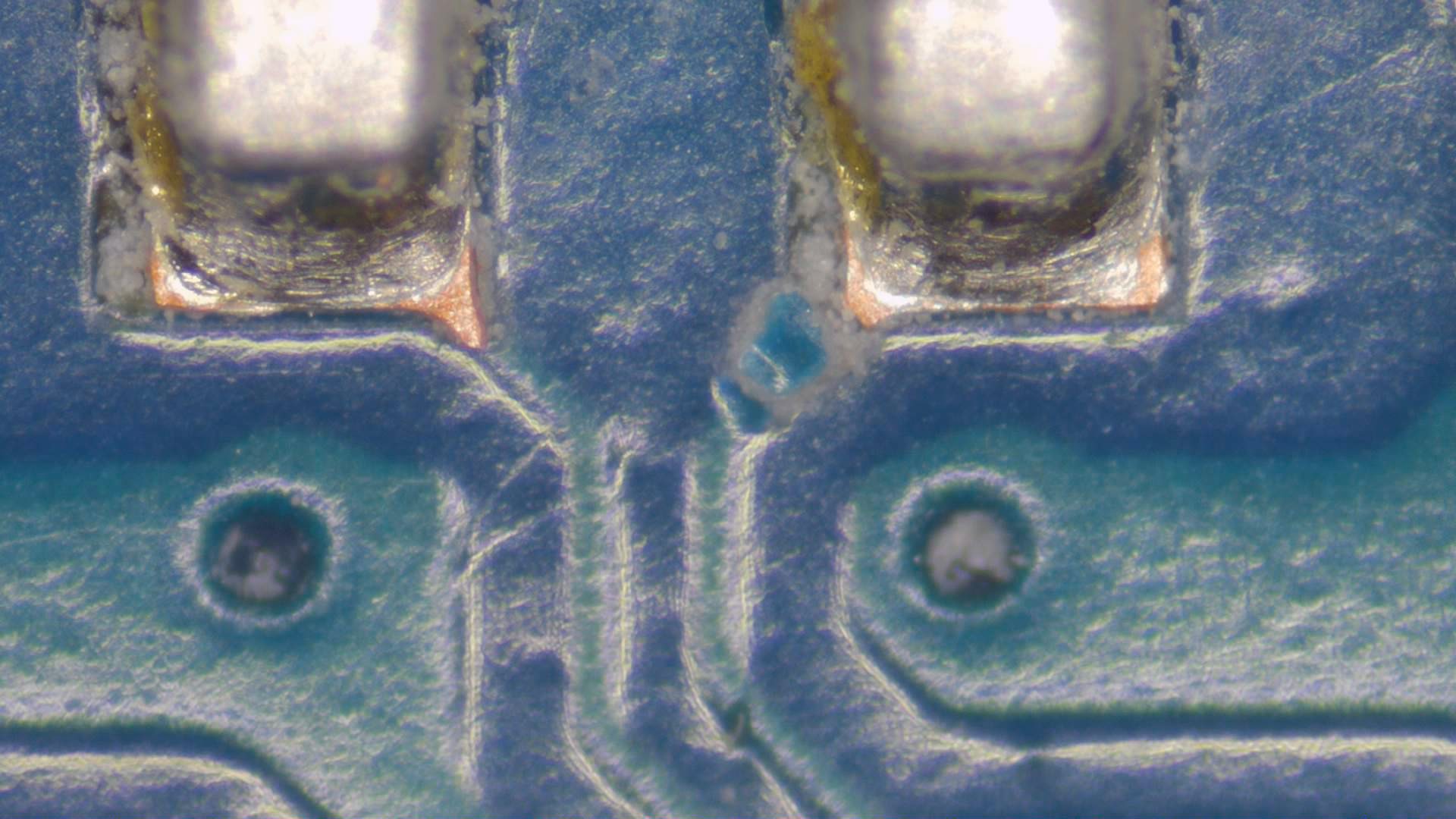

Lardman wrote:
KiTHardWare wrote:
Both indectors = 5v
I think you may want to check those again, all 3 of them not just 2.
Thx i already check the third one on the top all work fine
I figured out the problem the 4 sata lines is damage
PostPosted: May 19th, 2025, 14:34
Posts: 26
Thx bro for resources case solve
