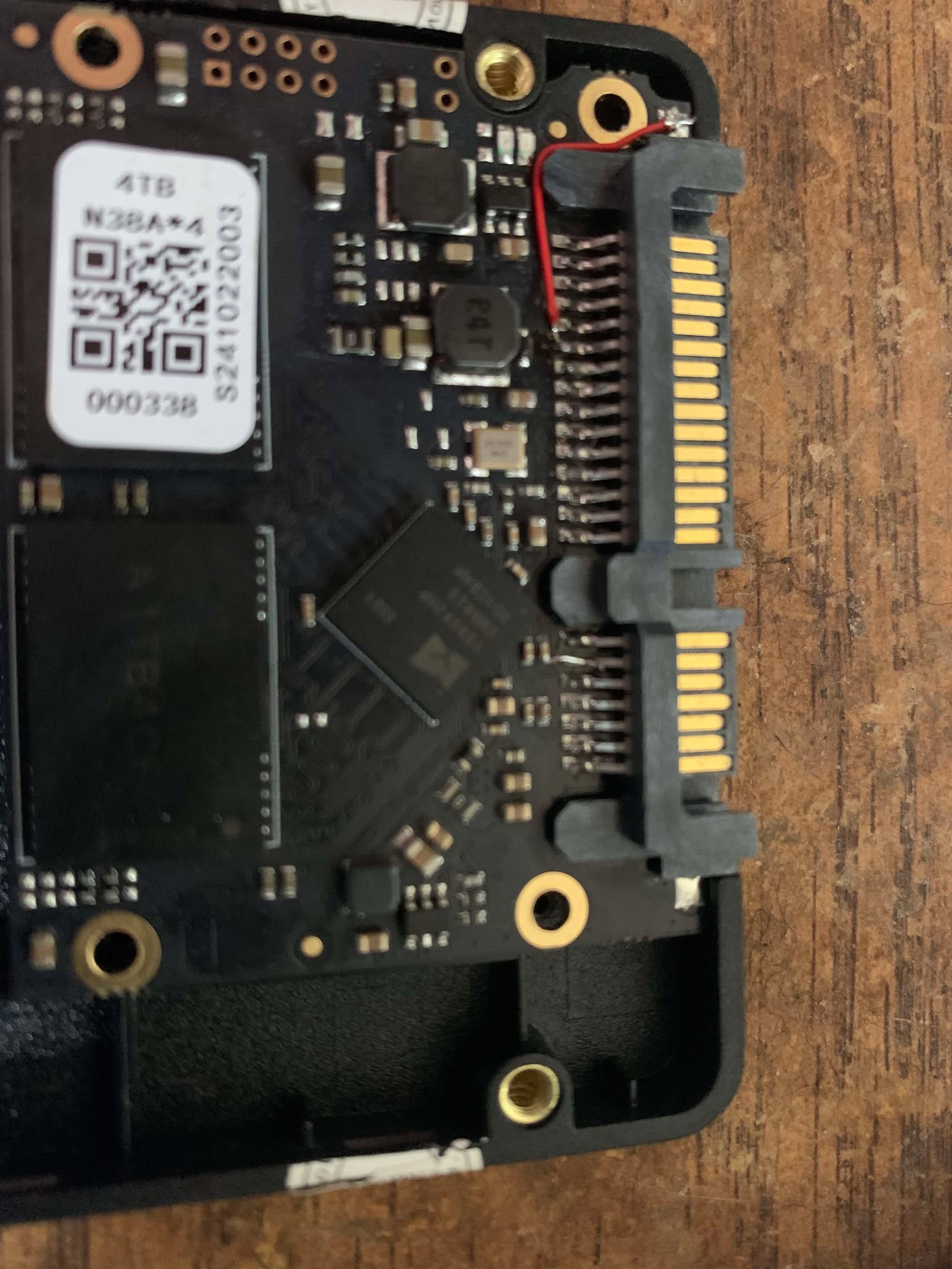

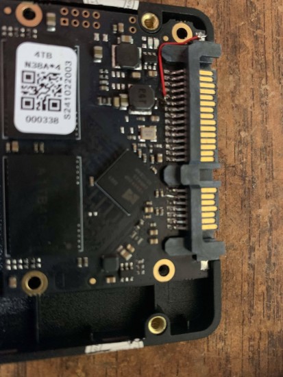

Hello. I have a fanxiang 4Tb HHD that I broke the connector for the data port while installing it in my son's new PC. I am pretty OK with soldering so I thought I will just replace the pcb connector and it will be fine.... sadly I feel my soldering skills and failing eyesight might have let me down. I somehow damaged a trace on the power port side (for Ground) and completely tore a pad off on one of the data lines. I repaired both of those, the internal LED's on the drive light up, The data pad was jumpered with wire to the side of a cap, and Ohm out, BUT the PC will not detect the drive. I am throwing in the towel before I make things worse....... A simple repair that was going great... till it was not has left me with a dead 200.00 drive. Anyone out there in the USA with a microscope and better skills than me willing to give it a shot?
I have already made an offer on another drive so my son can at least get his PC finally. But if I can get this repaired he can have another 4Tb Drive in his system.

Here you go. You can see the 2 repairs I made in both the photos.

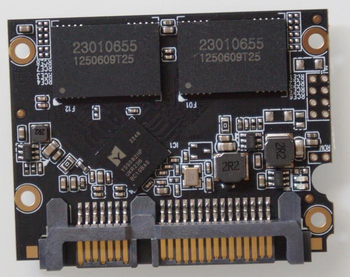

See the "ROM" shorting pads above the two LEDs. Short them with tweezers before and after power-on, and then release the short after a few seconds. Is the SSD now detected, albeit it with a factory alias and reduced capacity?

https://i.postimg.cc/FzgHv3f8/Fanxiang-SSD-PCB.jpg

So IF I do this will it adversely effect the Drive?? I don't want to mess it up and end up with a 4Tb Drive that sees only 20 meg or something
 Post subject: Re: Need a GURU to attempt to repair my 4Tb HHD
PostPosted: June 12th, 2025, 4:05
Posts: 1324
It puts the controller into safe mode - it wont do anything permanent to the drive but forces it into as simple an operating state as possible - ie to check for ripped traces and the state of your soldering. If you get nothing from it like that then there are problems, if you do then there a problems with the firmware / nand. If you remove the short and then repower the drive it will return to it's normal state.
