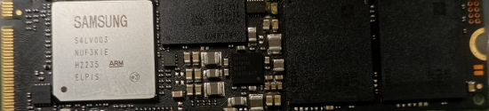

Guys
Has anyone been able to crack this MCU , portable doesn't support it.
SSD is detected with lower capacity .
Model No -Samsung MZ-VL25120

Have you considered reflowing the chips, especially the NAND ones?
No considering delicate electronics & pcb , actually SSD is getting detected as 1 GB.Do you think Heating Nand with hot air might work?
Thanks for suggestion.

higgsboson wrote:
Might. As it isn't able to load firmware from NAND (the 1 GB capacity is typical), one option is that NAND is 'detached'. But can also be simply firmware corrupt, same symptom, and without PC3000 support not a lot you can do.

IMHO reflow/reballing make things only worse. 99% cases not help.
Thanks arvika
your words are like Digital masters final judgements
I was sure this might not be issue related to electronics.Your post has came at right time :good:
