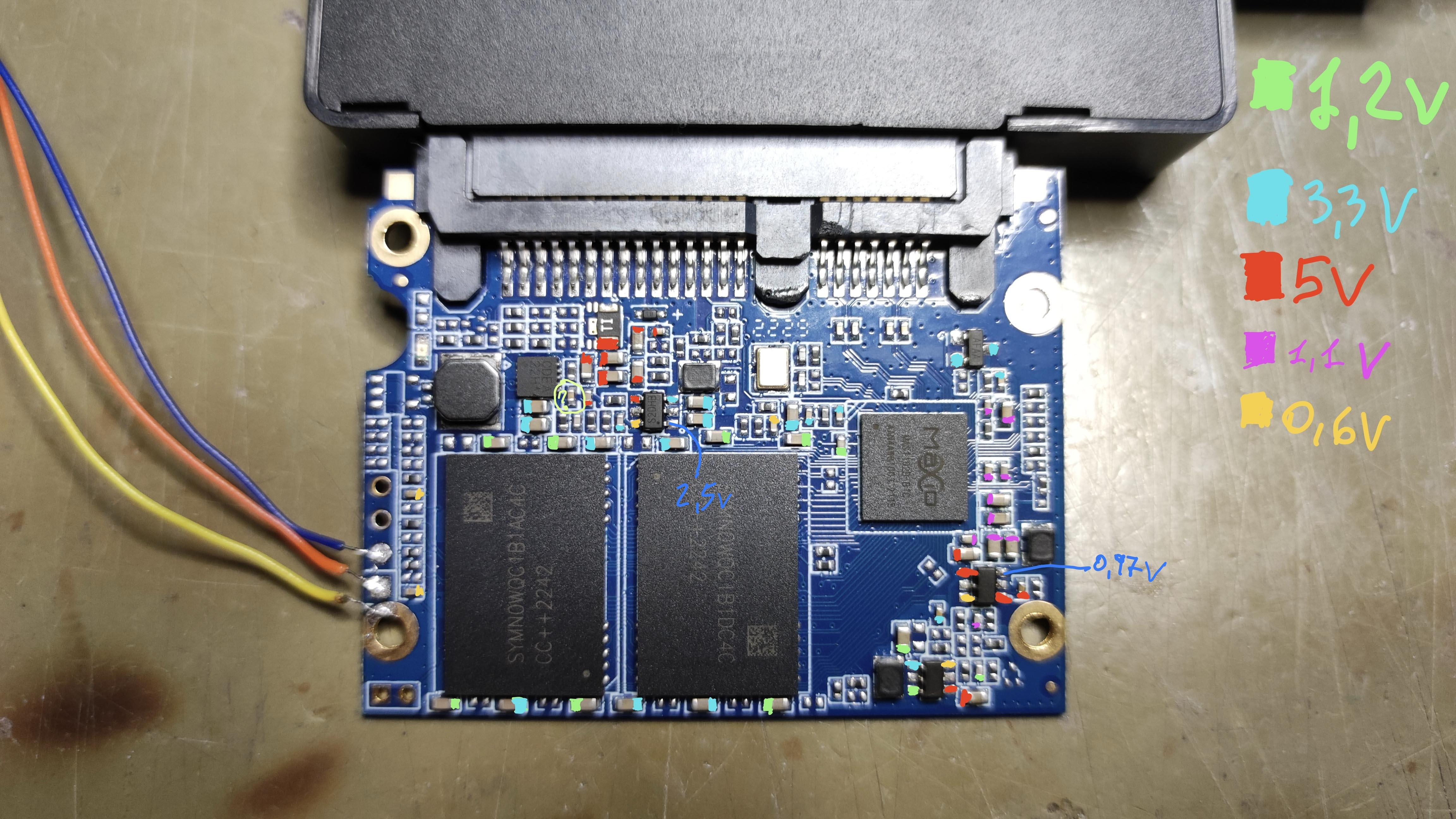

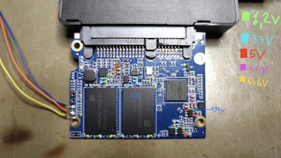

Hi all, I have an SP A55 SSD with MAS1102B-B1C controller and two SYMN0WQC1B1DC4C NANDs where I need to recover data.
The disk is formatted in HFS+ and I need to use R-Studio to extract data since I'm on Windows.
Initially the disk was recognized, but after some little time (~10-20sec), now most of the time isn't recognized anymore or rarely after a long led blinking.
I tried to replace the crystal (hoped it was dropped and it caused the issue) but nothing.
I taken a picture of the board and drawed all the voltages on it. They all looks good except one (feedback or dataline(?)) or two. Also I connected it to a serial port and extracted the entire log where I ca see many warning and or fail.
I don't have PC3000 so I would ask if someone could suggest anything that could be helpful.
Thanks.

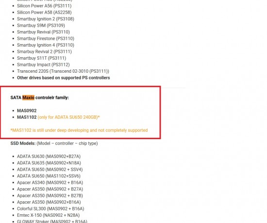

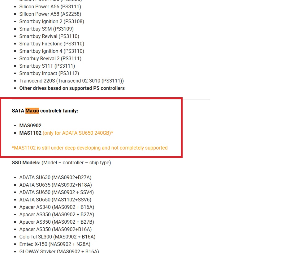

Sarà molto probabilmente un problema di blocchi danneggiati, serve PC3000 per generare i translator virtuali in modo da poter recuperare i dati.
Attualmente però PC3000 NON SUPPORTA il tuo specifico modello di ssd, ma ci stanno lavorando...
https://blog.acelab.eu.com/pc-3000-ssd- ... #more-1378
quindi è inutile che ti rivolgi ad una ditta di recupero dati finchè non uscirà l'aggiornamento che supporterà a pieno quel tipo di controller.
Dovrai attendere, non c'è altro modo.

Pin #6 of CDEA is the feedback pin. My searches tell me that it should be 0.6V when regulating properly.
Is there any datasheet or example schematic? However there's a stable voltage on the output coil...

If the feedback voltage is 0.6V, then the output voltage must be correct.
HX3430, Hxk Technology, Synchronous Step-Down Converter, 1.1 MHz, 3A, 2.5V - 6.0Vin, marking CDCO, DFN2X2-6:
https://hxkic.com/data/product/20201210_164711_71005.pdf
