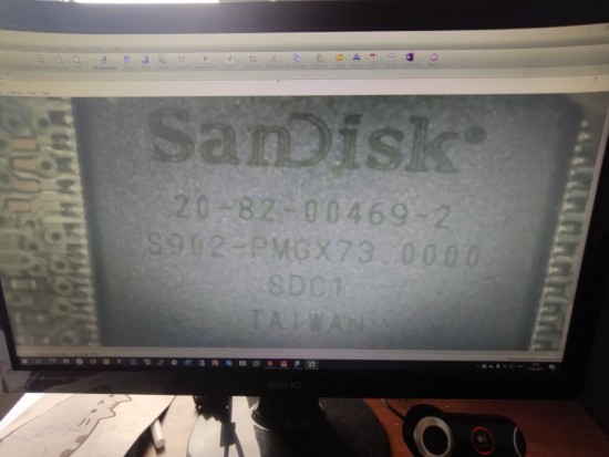

For future reference, is it possible to unlock the WDS480G20B somehow? Only 16k (32 sectors) are visible.
When you try to subtract smart, you immediately get an error.
The passport reads, but the volume is small.

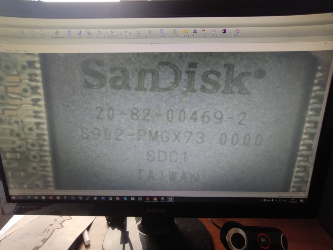

The defines the model as SanDisk Milpitas
Firware - none
Marking of the S902-PMGX73 controller
Any chances?

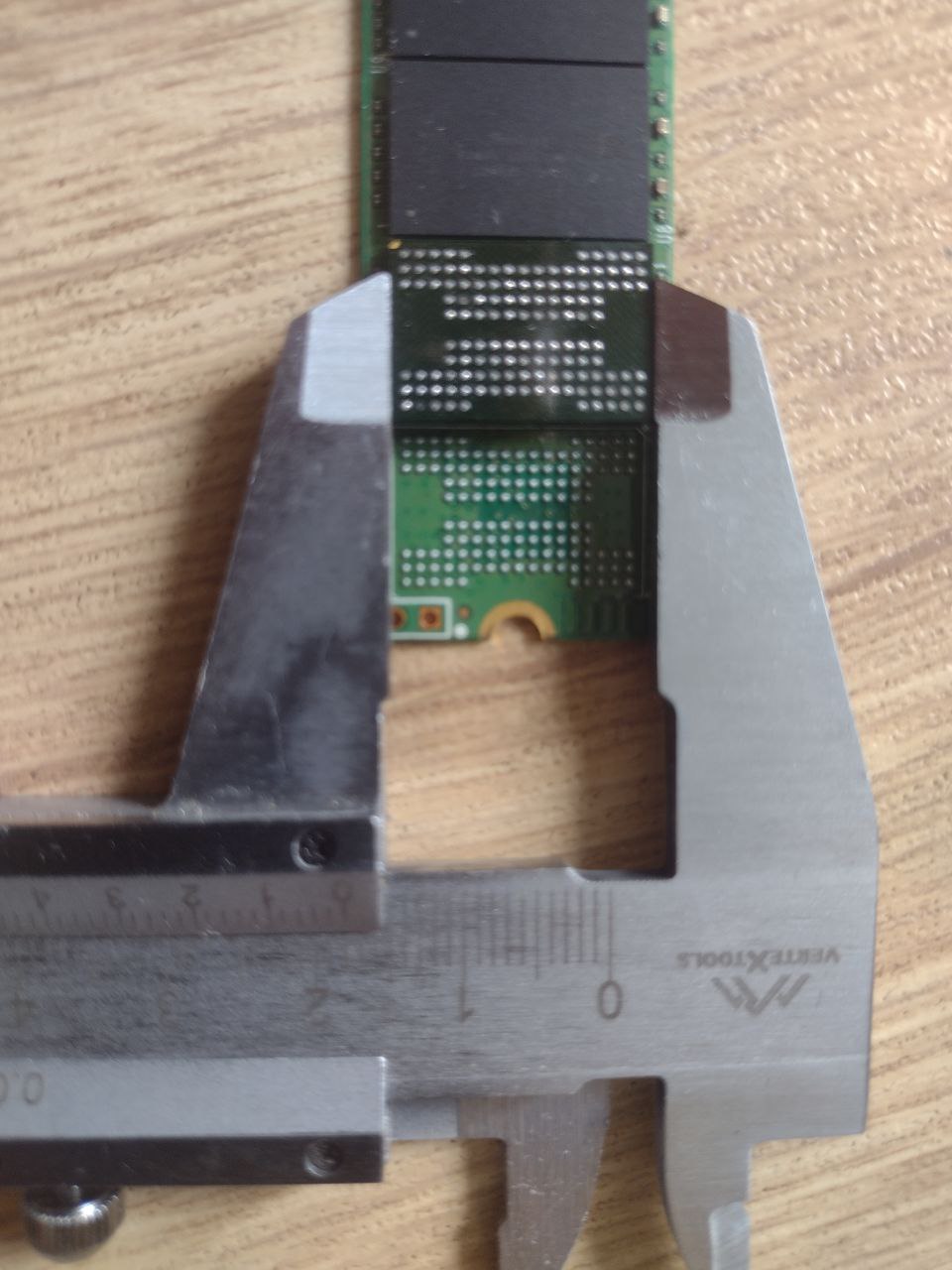

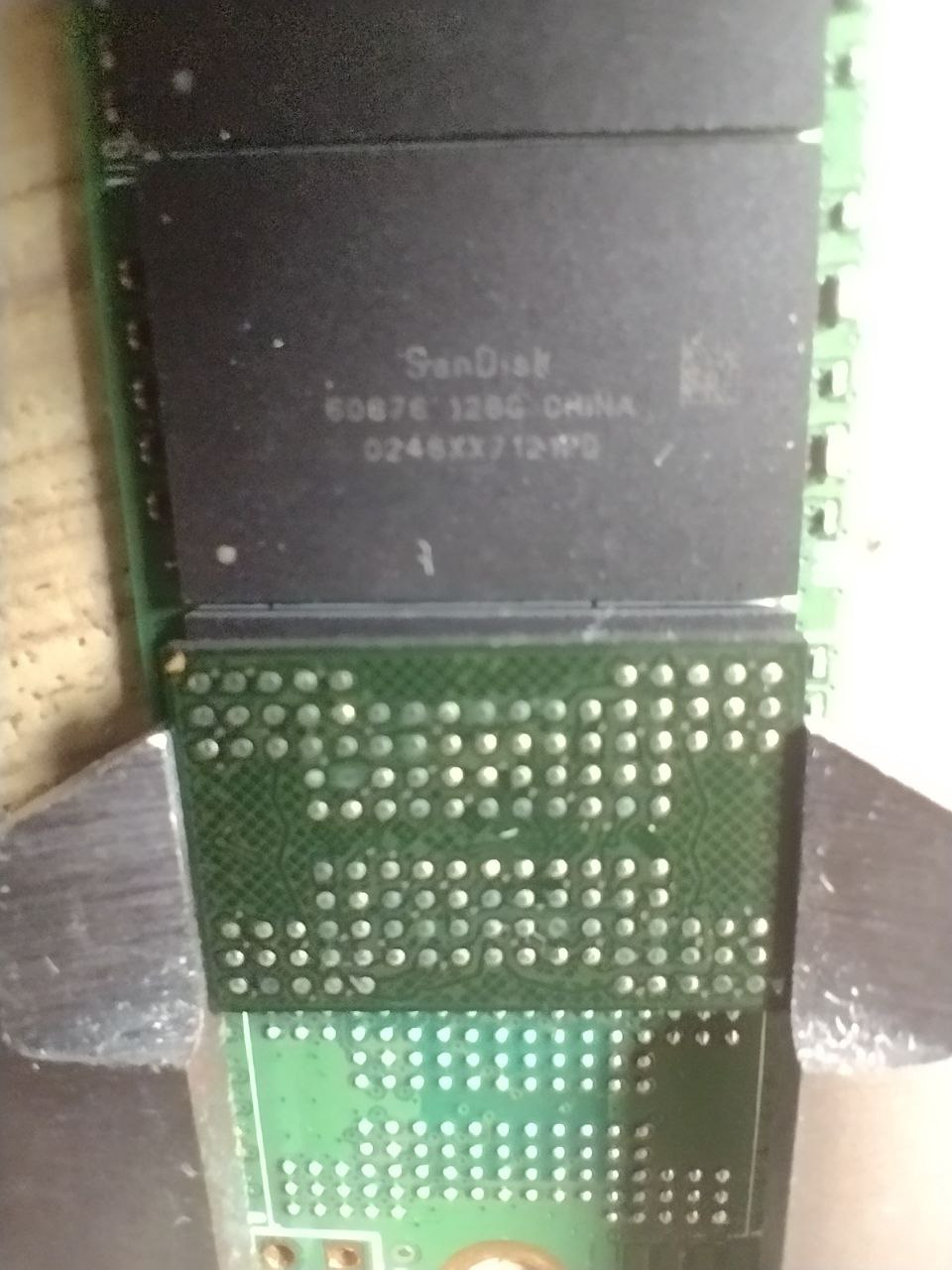

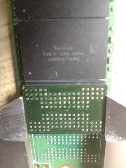

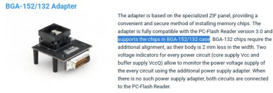

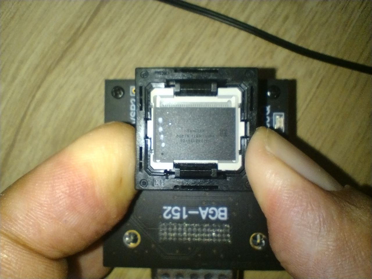

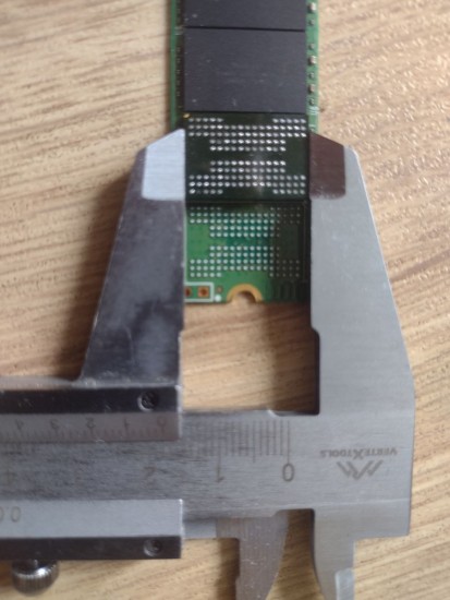

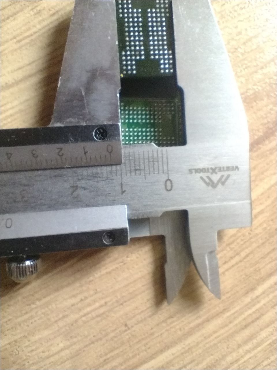

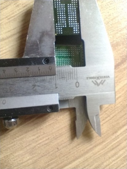

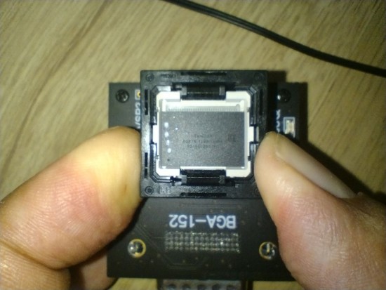

hi2* I made a chip-off, but I can't read it through the PC3000 Flash. Can anyone tell me what the error is? or is the BGA-152/132 Adapter not suitable?
Can you recommend a programmer who can help?
Re: WDS480G20B (WD green) does not detect the full volume.
July 12th, 2025, 12:36
I placed it in the center and managed to read the ID, but the data doesn't seem to be available in the chip database(
July 12th, 2025, 16:02
One person already stated it isn't supported by PC3K and another stated it is by VNR.
