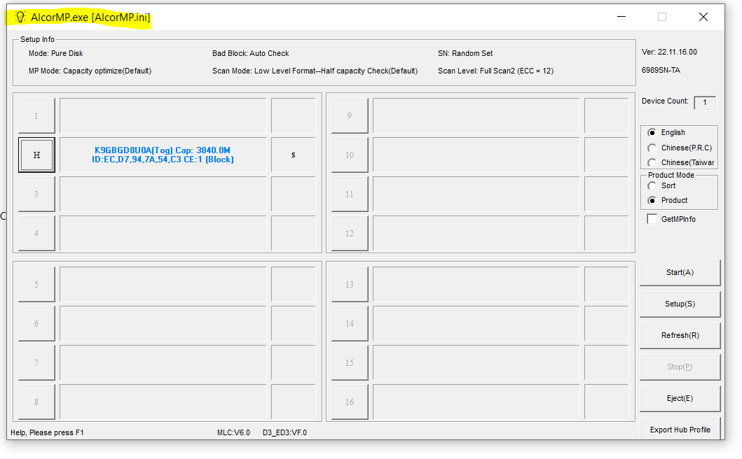

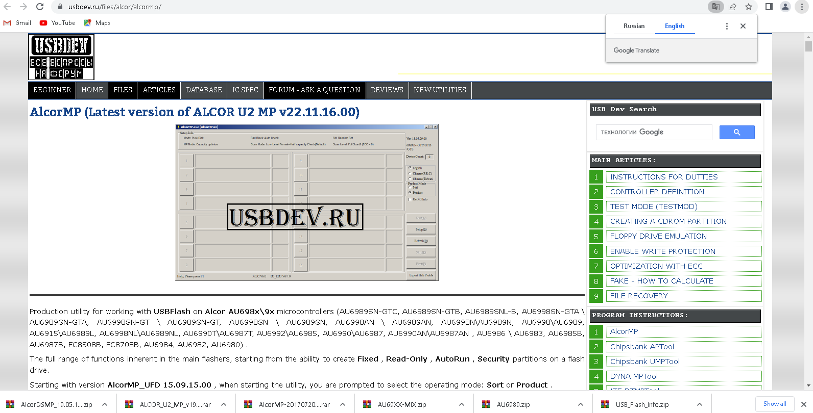

I have got a 4gb usb 2.0 pen drive from customer to reduce size to 2GB and clone with his master 2gb pen drive. Order is aprox. 100 units per month .
I have got mcu details using chipgenius and usbflash info
pen drive has alcor mcu.
While there are several tools available on usbdev.ru site , I don't know which tools will be having function to reduce size.
Someone familiar with alcor might be know more about speciifc tool

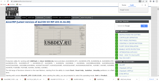

Controller: Alcor 0xFA00
Possible AU6989SNCS-TA
We enter the setup - leave the password blank - click OK.
On the Bad Blocks tab, select FIX CAPACITY or BIN and set the desired size.
https://www.usbdev.ru/articles/a_alcor/alcor-optimize/
On the Information tab in Vendor String, type terminator2 . 8)

Thanks SWM , I have been successful to reduce size of the pen drive and grab this order. Appreciate your efforts and help
This is the power of hddguru forum's single post. :good: :-D

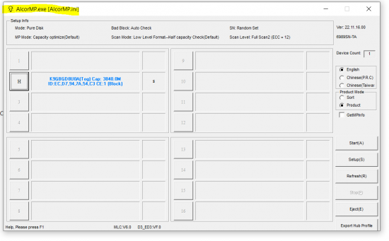

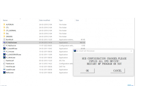

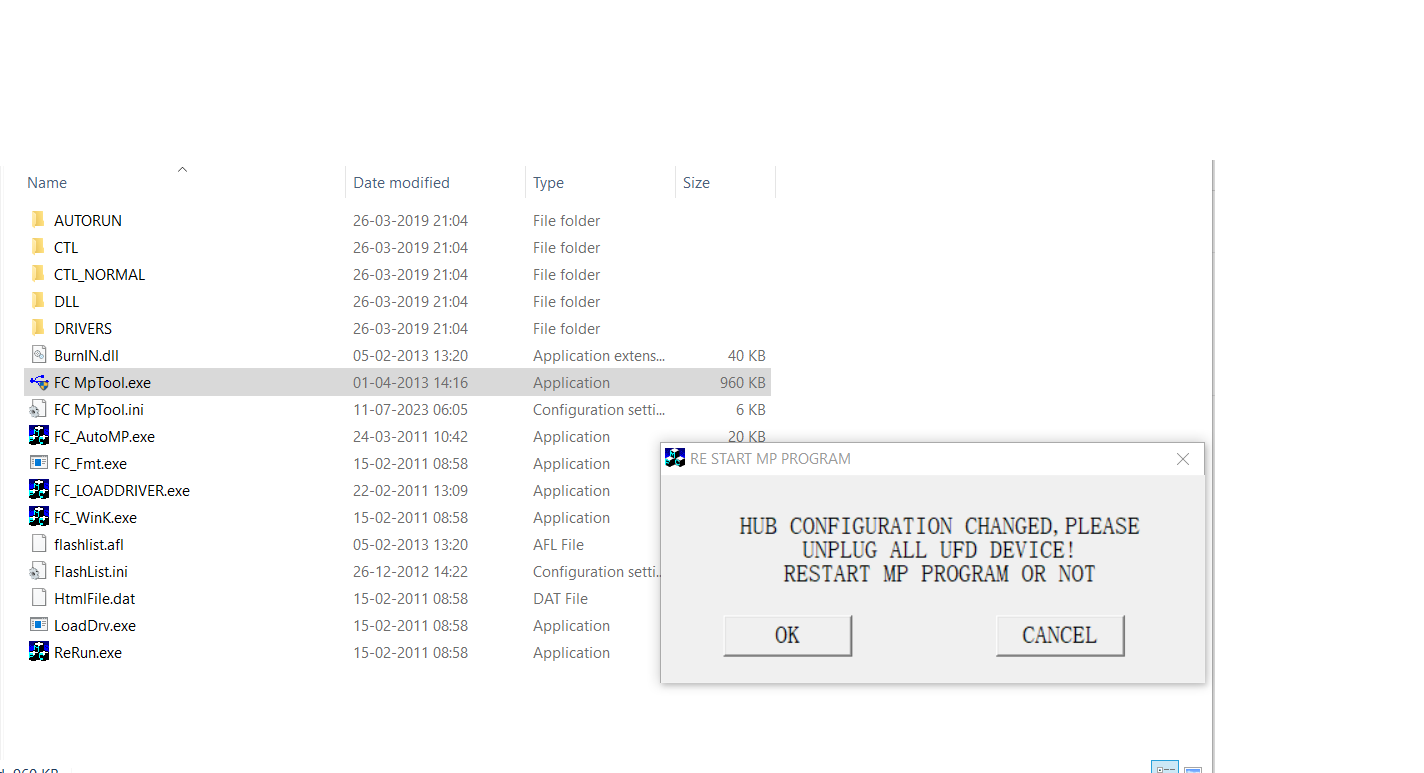

Hi SWM
I am trying to use your instructions to reduce size of pen drives for a customer . I have tried v22.11.16 which is last available on usbdev.ru site.
Customer wants to use in his automation equipment & due to limitations of stack memory his processor can detect pen drives of upto 2GB with sector size of 512 bytes.
While one pen drive was successful and got approved by customer one didn't . I will have to check availability of pen drives here in India first as customer has very low budget ( $5 per pen drive including pen drive and size reduction) .
I want to know where can I get clean original versions of the softwares for different microcontrollers ? I want to know detailed instructions as well how to use these tools as my knowledge is very basic and limited.
Appreciate any help.

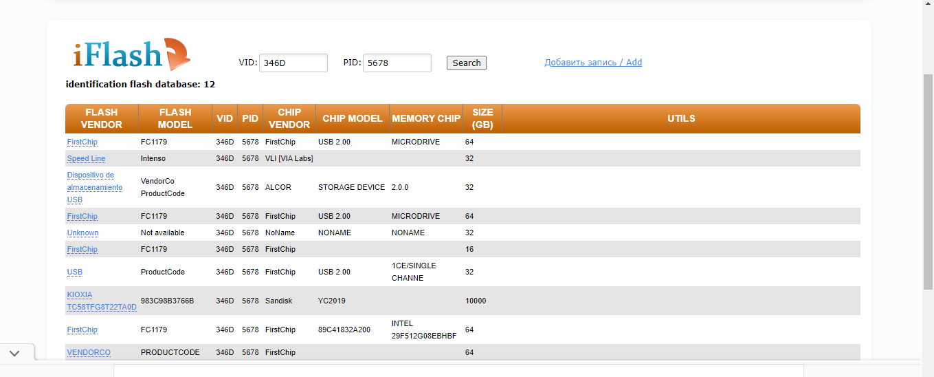

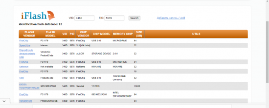

I have remotely checked customers 8GB pen drives and have found following details -

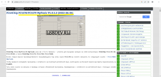

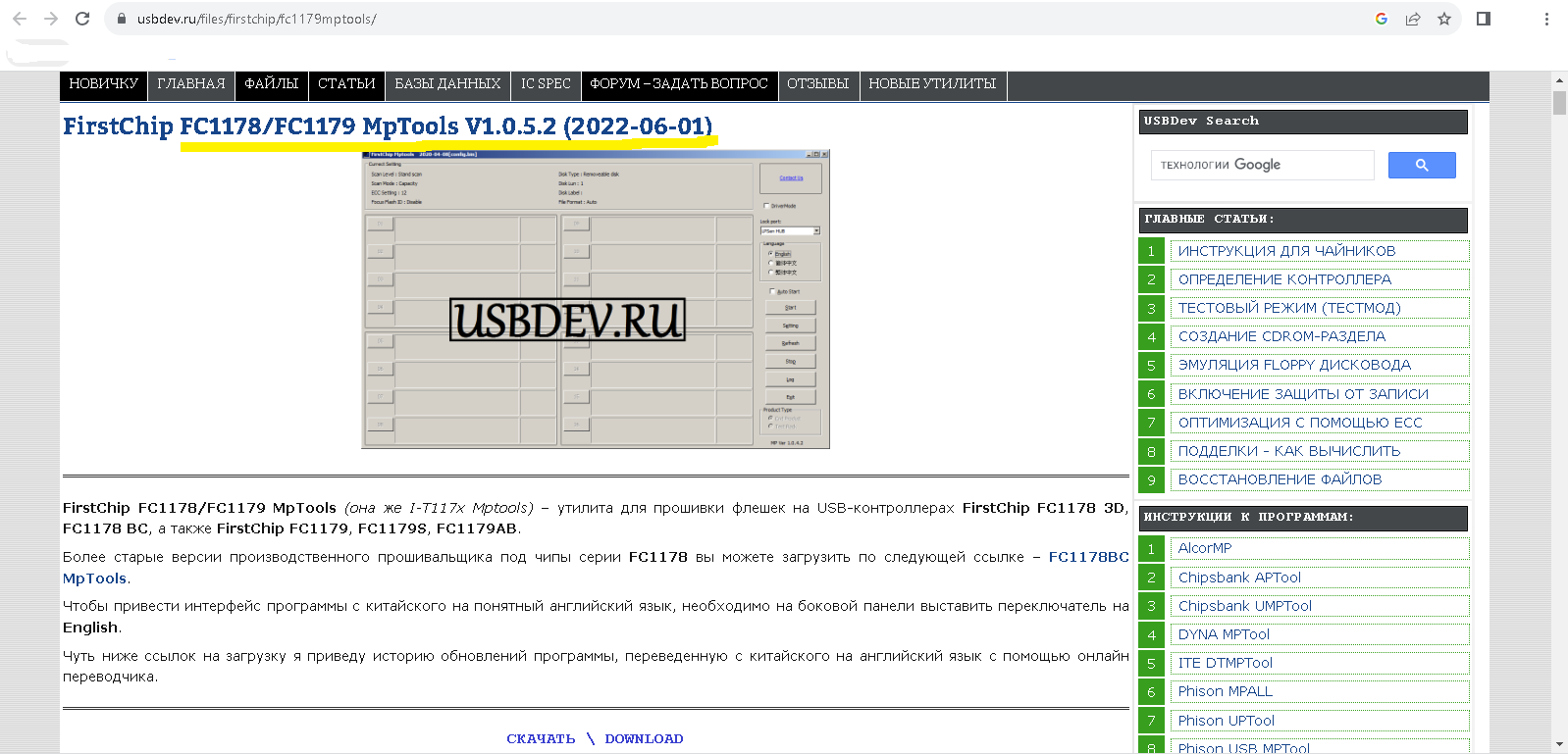

Flash ID code: 989476042020 - KIOXIA - 1CE/Single Channel [MLC]
Tools on web: http://dl.mydigit.net/search/?type=all&q=FC212T

http://www.antspec.com/usbflashinfo/
Program Version: 9.4.0.645
I am unable to identify which is mcu and tool I can try.
Hi controller is firstchip .Try FirstChip FC1178/FC1179 MpTools V1.0.5.2 (2022-06-01) .I don't know whether it supports this controller
I tried this software and unfortunately 2 out of 4 pen drives client sent were damaged .They are showing no media present. I a utterly disappointed and have given up further efforts due to following -
1) lack of knowledge
2) lack of proper tools -- so many variants and tools origin of which is unknown and give malware warnings
3) No official tutorials or proper literature available except russian /chinese forums
This is not my cup of tea
Thank you

Don't get discouraged so quickly . Mistakes are big steps in making success.
There is no tool available for fc212T , ask customer to send different make pen drives check alcor which is having more tools.
