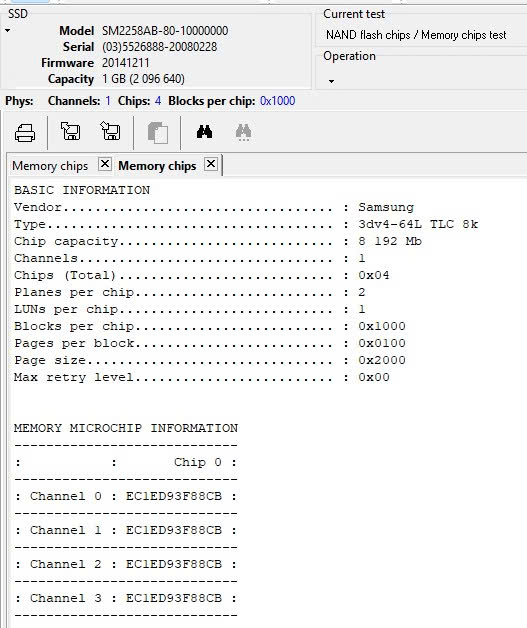

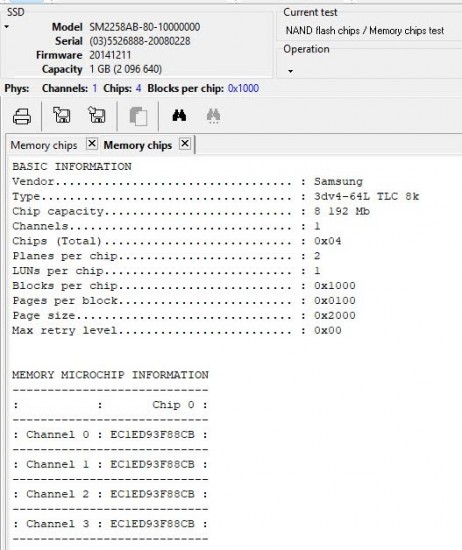

Hi all, i am trying to understand why can't i recover this drive. Is it because of the Loader, ỏ the NAND or the controller of the SSD
So i got thí Eckoo chinese branded SSD. with a SM2258XT controller
1 NAND chip
Upon loading the Loader i got this error
Model : SM2258AB-80-10000000
Serial : (03)5526888-20080228
Firmware : 20141211
Capacity : 1 GB (2 096 640)
Selected family......................... : Crucial BX500
Controller.............................. : SM2258XT
SSD status:
SSD is in ready state................... : Yes
Firmware mode........................... : ROM
SSD error code.......................... : 0x00 (No errors)
SSD is locked........................... : No
SSD is in Safe Mode..................... : Yes
Logical access is possible.............. : No
Physical access is possible............. : No
Chips id................................ : EC1ED93F88CB
Vendor.................................. : Samsung
Type.................................... : 3dv4-64L TLC 16k
Loader uploading
MPISP code name......................... : S0212B0 SSV3_00; R1211A(N)
S0212B0 SSV3_00; R1211A(N).............. : Ok
Calling executable code................. : Ok
Invalid sectors per regions value (0xFFFF0000)
Seed table reading
Page reading (channel: 0; chip: 0; block: 0x0000; page: 0x0004); ECC error
Page reading (channel: 0; chip: 1; block: 0x0000; page: 0x0004); ECC error
Page reading (channel: 0; chip: 2; block: 0x0000; page: 0x0004); ECC error
Page reading (channel: 0; chip: 3; block: 0x0000; page: 0x0004); ECC error
Table not found

So what can the error be? How can i recover this SSD?
Many Thanks!
Here is the Chip ID

ECC errors are most likely due to the incorrect configuration of the memory modules used.

There are problems with those AB versions. Try different loader. Every one for SM2258XT.

That loader (and other loaders) may not be compatible with the one from the SSD itself, hence trouble.
