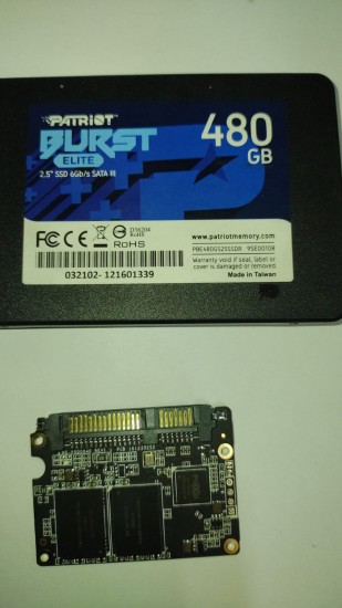

Hello guys, i have a corrupted firmware SSD with maxio controller. The disk is a SSD Patriot Burst Elite 480gb.
The controller chip is a Maxio was1102b-b1c. The memory chips are a YMC4G0W (the rest of numbers are diferents). Second line is 2146E and last line perhaps is a serial number of chip.
The disk not up in BIOS (i try 3 different computers) and only is detected in factory/restore mode using the two pin in the PCB. In fact in this mode, the software of Maxio reconize the mode and disk in emergency to flash it. But the problem is, i not have firmware for this disk.
I search in google and found this link with information about some models and version of firmware:
https://smarthdd.com/database/Patriot-B ... ite-480GB/
My disk is model PBE480GS255SDR SSD SATA 3.
I need help about flash procedure without erase data (in the disk have a data not backuped) and if somebody have firmware for this model.

Any software repair/reflash will erase the data from the drive. To recover the data, you need to use appropriate tools.
I don't know if free equivalents exist, but considering the complexity of selecting the appropriate parameters and then selecting the correct translation versions, I suspect such an equivalent doesn't exist.
