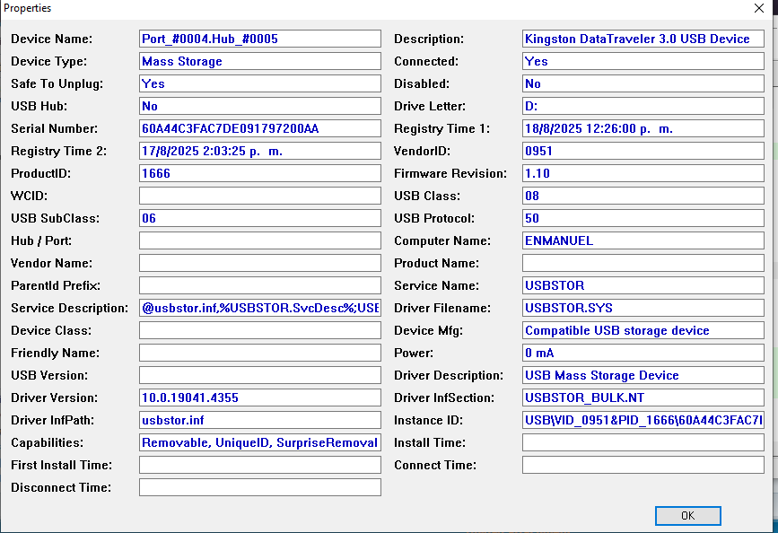

Hello, in the past 2 days i've been trying to revive a kingston usb that i found on my brothers bedroom. i have tried using ChipGenius to identify crucial parts like the controller part vendor, but it tells me that it is unknow, so i had to open the chip to see the info.
Im also having trouble trying to get to know the burner file and the firmware, i do not know which one to use.
i tried using Phison-MPALL_v5.13.0C tool, but because im new at this it seems very complex to me.
If you can help me, (i do not care about the things inside the usb, i just need it working again) look at these details below:
Controller
Phison PS2251-07 (PS2307)
VID / PID
0951 / 1666
NAND
Toshiba/SanDisk, 32GB, code: U0 1509C / SQYSF 2CF
File comment: more info

1. ,Try format or restore with this...https://filebin.net/0b1fb41ift4hwhqf
2. IF not work try this https://filebin.net/plr5jpphj15y4zbt
