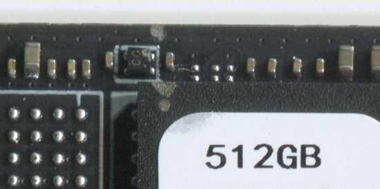

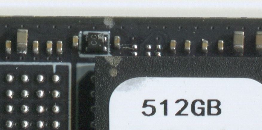

 Post subject: Anyone ID this for me?
PostPosted: October 7th, 2025, 17:30
Posts: 1312
I can't find it. More importantly where can I pinch one from. The donor same make / model I bought is a completely different design and that isn't present, you have to love these generic nvme's. It does have a CK thought but as far as I can make out that's CC .
 Post subject: Re: Anyone ID this for me?
PostPosted: October 7th, 2025, 23:40
Posts: 17215
The two capacitors, on input and output, suggest that it could be an LDO regulator or load switch.
https://www.ti.com/packaging/en/docs/partlookup.tsp?partmarking=cc
Many more possibilities here:
http://markingcodes.com/search/c/cc
