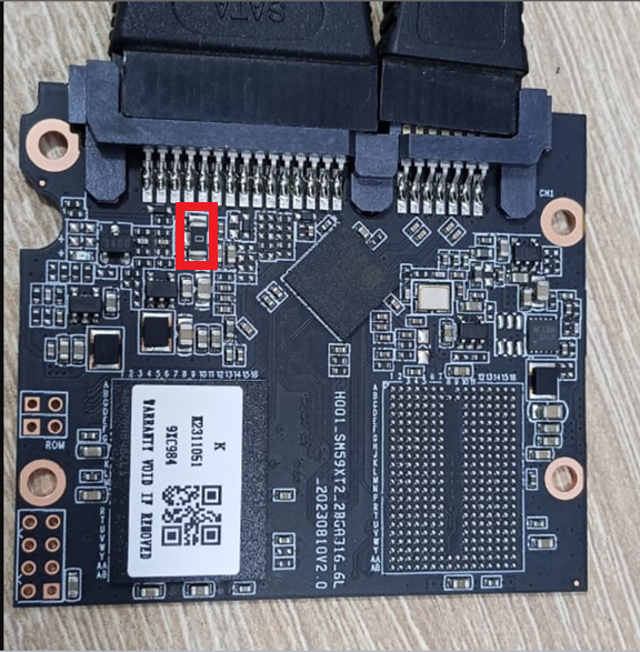

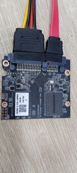

I'm receiving a growing number of TeamGroup SSD drives that fail to power on completely:
    - No power-on response with or without PCB shorting
    - No behavior change when applying controlled heating
    - No visible signs of burning or physical damage on the board
    - The drives remain entirely unresponsive under all standard diagnostic procedures
Could you please advise on known causes for this issue or recommended next steps for diagnosis and recovery?

 Post subject: Re: TeamGroup SSD Power Failure – No Visible Damage
PostPosted: December 11th, 2025, 6:43
Posts: 4854
check the 0 ohm resistor (fuse)

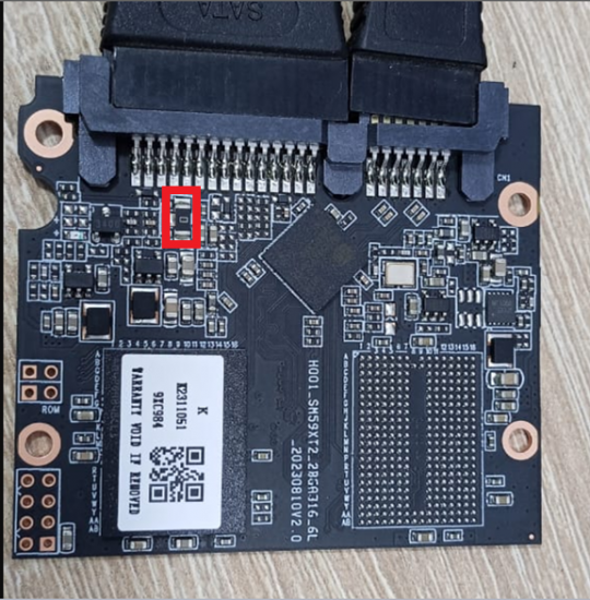

Dear @pepe
Thank you for your reply.
Are you talking about this one?
Kind regards
Lamine
PostPosted: December 11th, 2025, 10:08
Posts: 17335
Measure the voltages at the 3 inductors.
PostPosted: December 11th, 2025, 11:06
Posts: 17335
https://www.google.com/search?imgtype=photo&q=inductor%20smd&tbs=isz%3Am&udm=2
Posts: 4854
yes, that one.
Check if it is open, if so, check if the 'bottom' end is shorted to gnd.
PostPosted: December 21st, 2025, 11:19
Joined: September 7th, 2012, 16:37
Posts: 198
pepe wrote:
yes, that one.
This resistor shows 0.5 Ohm
The 3 inductors also show about 0.4 Ohm - 0.5 Ohm
Where could the problem be?
Thank you for your help
Lamine
