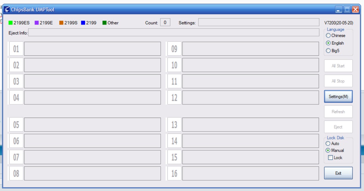

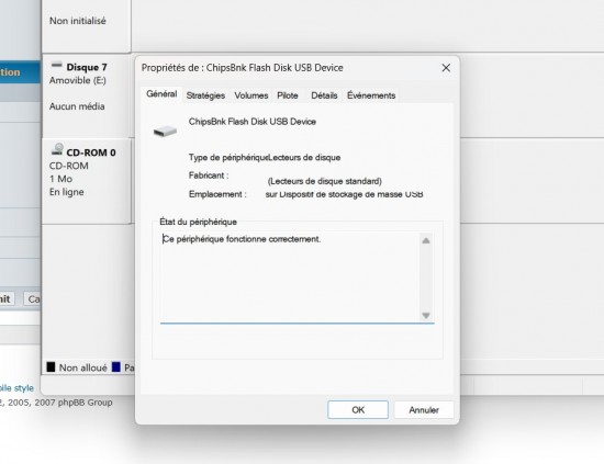

I have this drive not recognised as CHIPSBNK FLASH DRIVE USB DEVICE.
Is it even possible to recover data ? what tool do i need? I have stuff for microsoldering...
I made some search found "UmpToolV6A", try several version but it does not detecting flash drive. (.usbdev.ru links are dead but you can get the file with waybackmachine...)
Thank you for your help !

xMPTool will destroy all data. It's only for drive repair.
