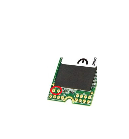

Hi everyone!
I have this mSATA SSD that got a dead short
After measuring, probing around i found the shorted component and swapped out the shorted component with a doner.
However when plugging into PC3000. PC3000 Still lights up like a christmas tree.
Having 0.2A on 5V on the patient
The donor have 0.3 on 5V
Can anyone help with the measurements
I will include better pictures later today
Many thanks!
1786002690857_9179048423253314249_9179048423253314249_3016a44971085e34c1267569fa4da2b7.jpg
1786002690857_9179048423253314249_9179048423253314249_3016a44971085e34c1267569fa4da2b7.jpg [ 294.98 KiB | Viewed 3844 times ]
Shorted component
749301116_27724165510512991_3378618385443867718_n.jpg [ 310.98 KiB | Viewed 3844 times ]

Lukas wrote:
The rule for SSDs is as follows:
Proper operation of indicators (BSY, DRY, ability to enter ROM/technology mode, etc.) - communication exists, problems most often stem from firmware.
Indicators not working despite electronic components functioning - most often a controller failure.
What exactly did you do? Which components did you replace or move?
I moved the red circled component from donor to patient. That capacitor was having a dead short
