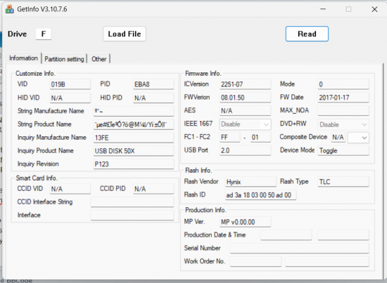

which i wanted to un-write protect to use it as my own pendrive
i tried using the mpall software but it never got detected there i tried multiple of them
after looking into some forums i found the phison restore tool and the person there told to use the Restore v3.21 and it actually worked and i was able to use it a normal pendrive without write protection but i dont know why but i used the latest version of the phison restore tool which is v3.26 and i pressed restore and it gave me some error message and windows gave me a notification that the usb device is malfunctioning (the pendrive was plugged into a usb 3.0 port) when i plugged the pendrive in usb 2.0 port, chipgenius gave me this info
Description: [F:]USB Mass Storage Device(13FE USB DISK 50X)
Device Type: Mass Storage Device
Protocal Version: USB 2.10 <- Hint: This device can run faster when plugged to a USB3.0 port
Current Speed: High Speed
Max Current: 498mA
USB Device ID: VID = 13FE PID = 5100
Device Vendor: Phison
Device Name: USB DISK 53X
Device Revision: 0110
Manufacturer: 13FE
Product Model: USB DISK 50X
Product Revision: PMAP
Controller Vendor: Phison
but getinfo tool inside the mpall tool shows different information (picture attached below)
i tried to use restore v3.21 again to fix things but it says the device is not found when press restore
i tried using different versions of mpall and now its showing up in mpall (tried 2-3 version all of them show it) but it shows CT-jump isp fail 0x1105 when ever i try to flash the burner and firmware file
how to fix this i really need the pendrive to work
File comment: mpall tool shows this after flashing the burner and fw file specific for this controller and flash
File comment: getinfo tool in phison mpall tool

https://forum.hddguru.com/viewtopic.php?f=10&t=45832
"For PS2307 and Nynix TLC, the only online queries are for MPTool resources. I haven't found a solution."
