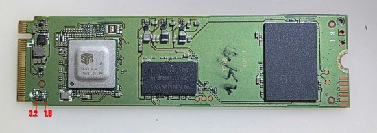

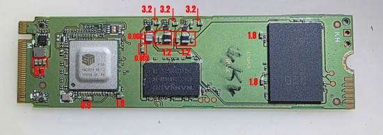

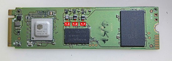

Need help diagnosing SM2265G AB NVME drive!
So i have this drive that is not recognizable on PC, Gives a short in PC3000 Portable Pro, in ROM mode the drive does not recognize the controller. upon plugging in the drive draws 0.27amps
I found out the line that goes to the RAM of the drive shows 0.002V.
What could be the problem?
Can anyone help out! Many Thanks!

 Post subject: Re: Need help diagnosing SM2265G AB NVME drive!
PostPosted: January 20th, 2026, 12:45
Posts: 17335
Which chip is generating 1.8V?
Why are there two 1.2V regulators?
What is the resistance between ground and the output of the "faulty" regulator?

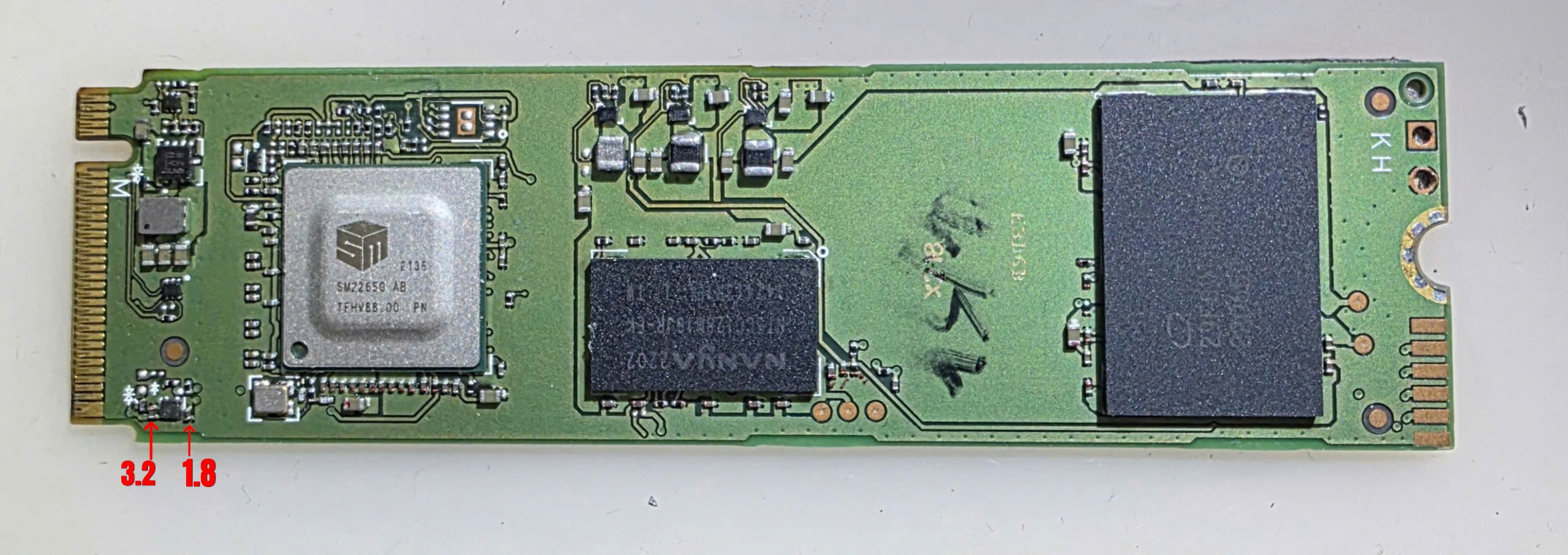

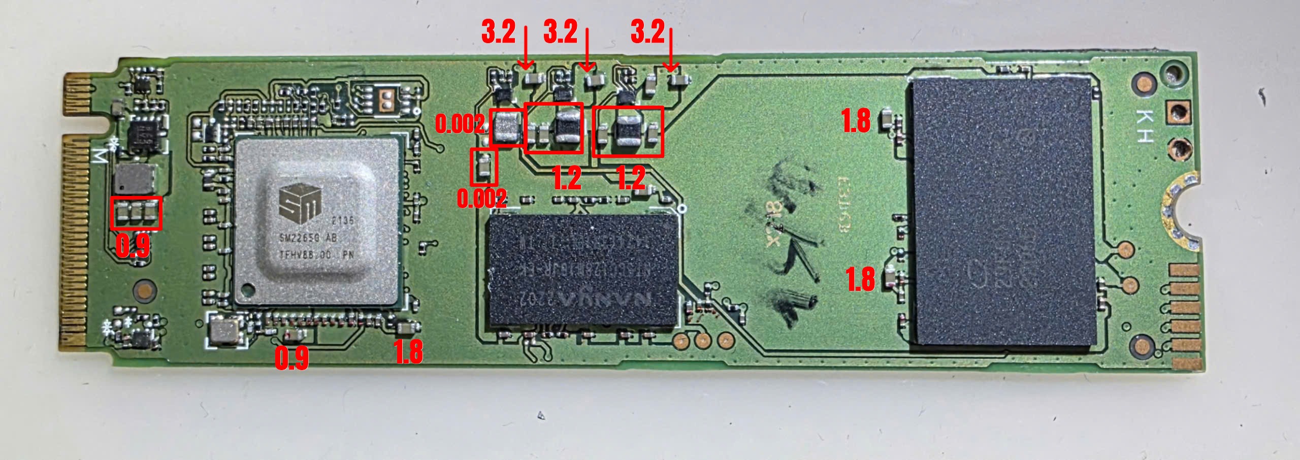

Here is the 3.2 and 1.8V So i guess that little chip is generating 1.8
I have no idea why there is two 1.2 Regulators
Resistance between GND and Output of the "Faulty" Regulator is 0.002
PostPosted: January 20th, 2026, 13:40
Posts: 17335
Look for a shorted MLCC (capacitor).

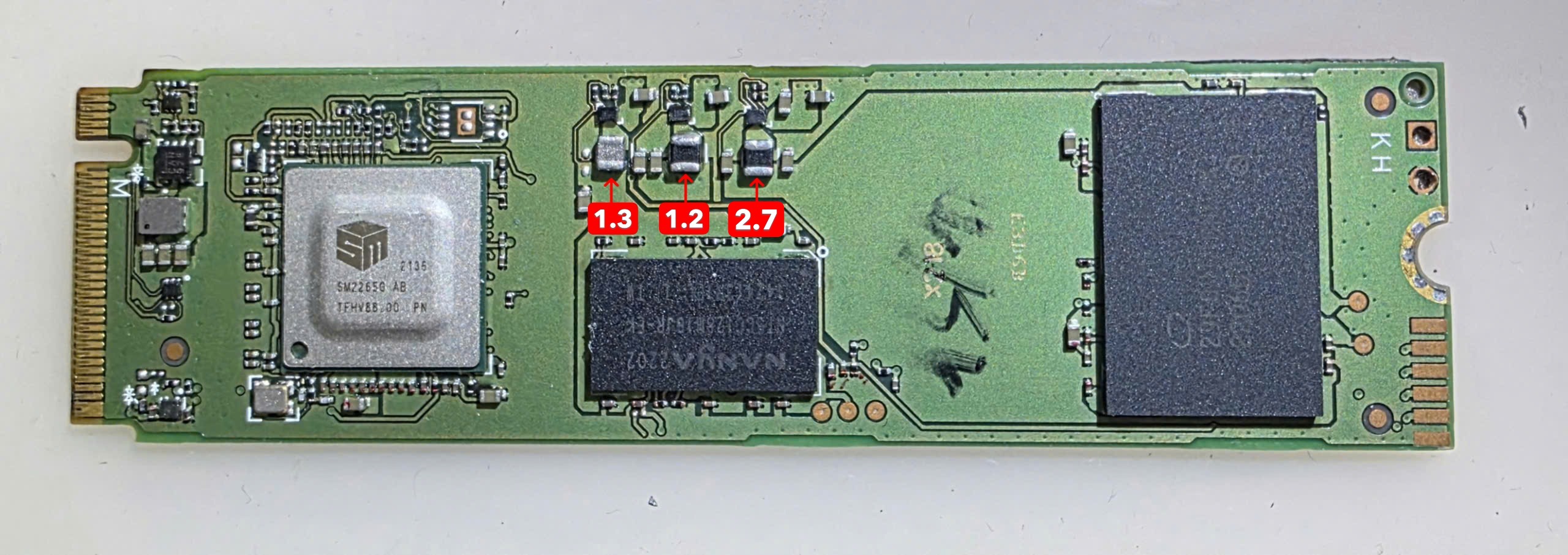

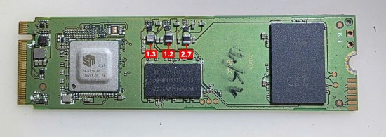

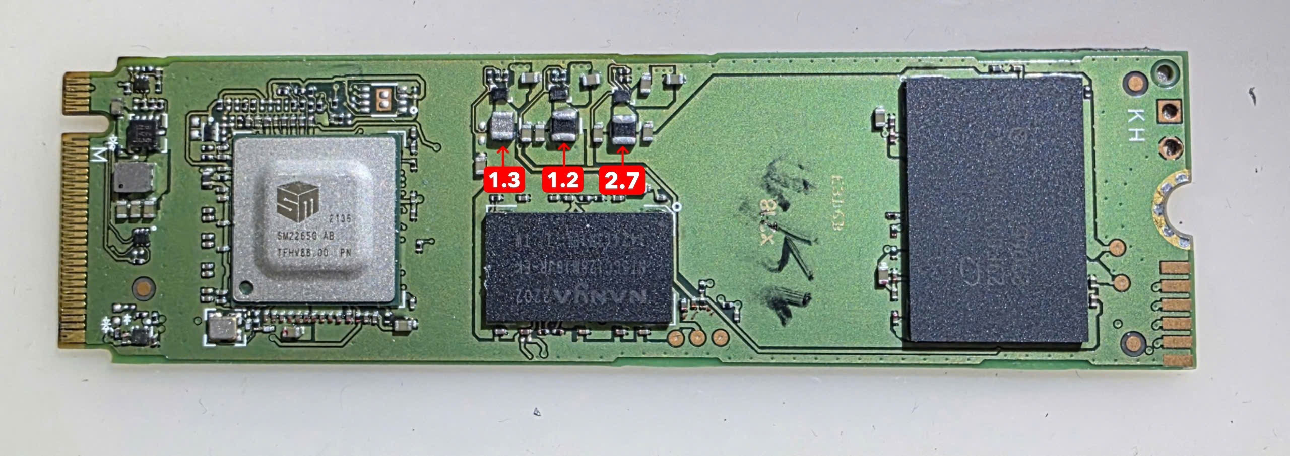

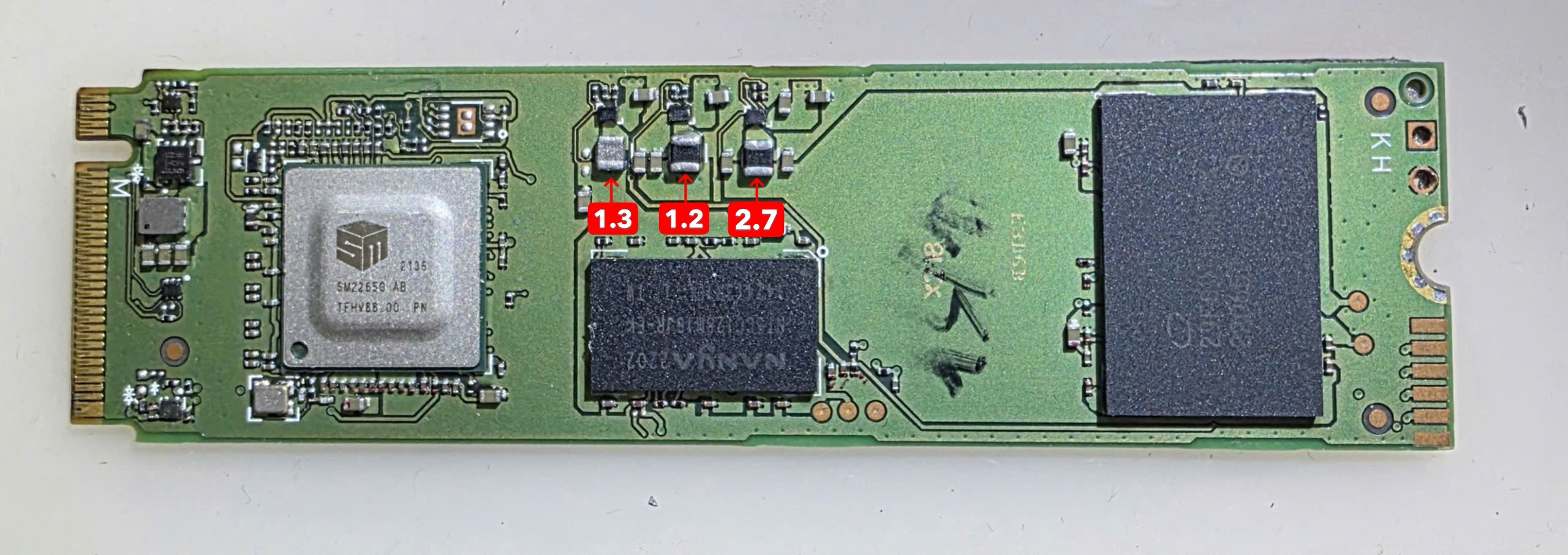

So i did not manage to find any shorted MLCC capactitors
But i did get hands on with another working donor. These are the voltages im getting.

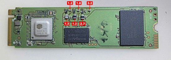

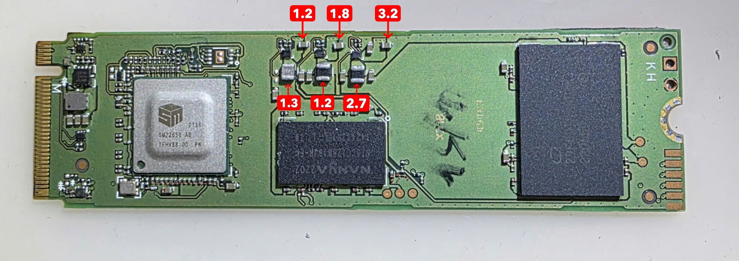

1.3 1.2 2.7
Sorry. was editing my pictures. couldn't delete old ones

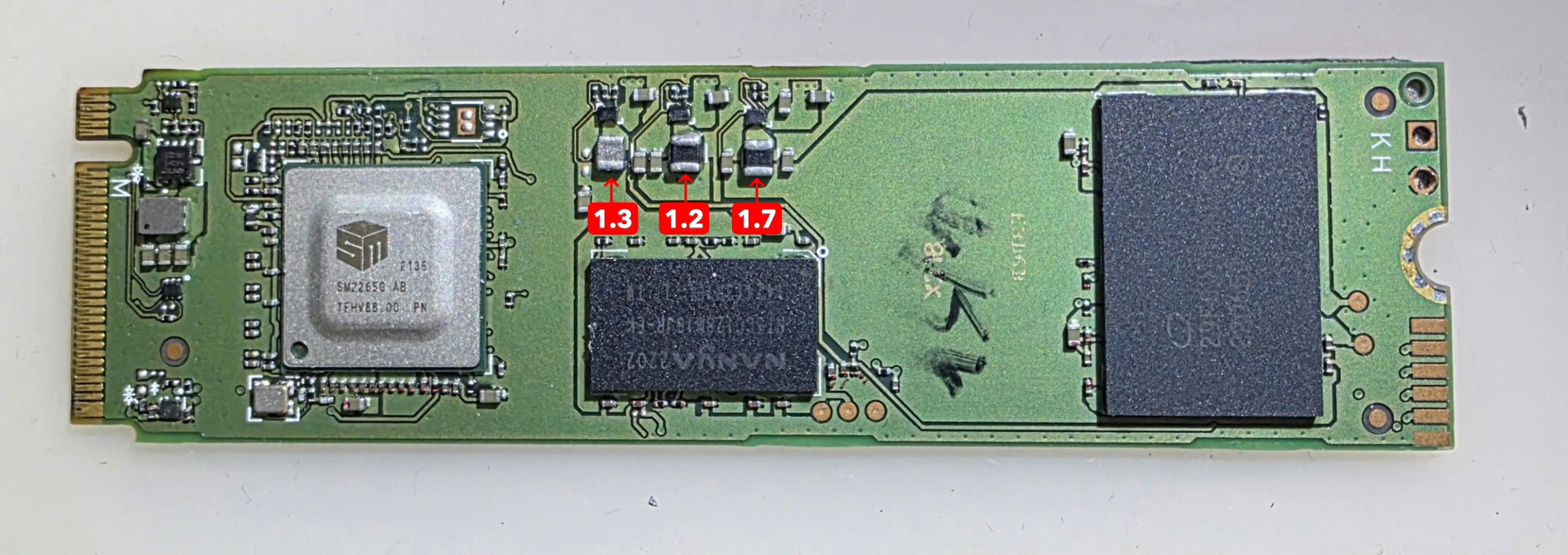

Here is from a good one
PostPosted: January 25th, 2026, 11:32
Posts: 17335
Your donor measurements make no sense. On your patient PCB you have 3.2V at the inputs of each of your buck converters. On your donor PCB you have 1.2V, 1.8V and 3.2V. The first two must be wrong.
What are the part markings on all the small ICs?
