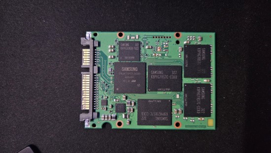

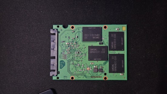

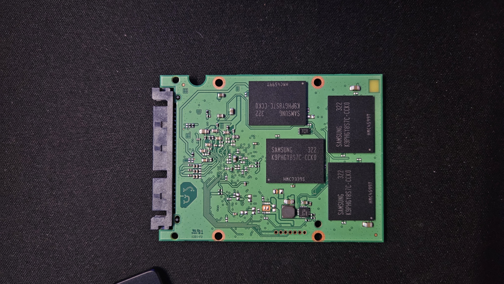

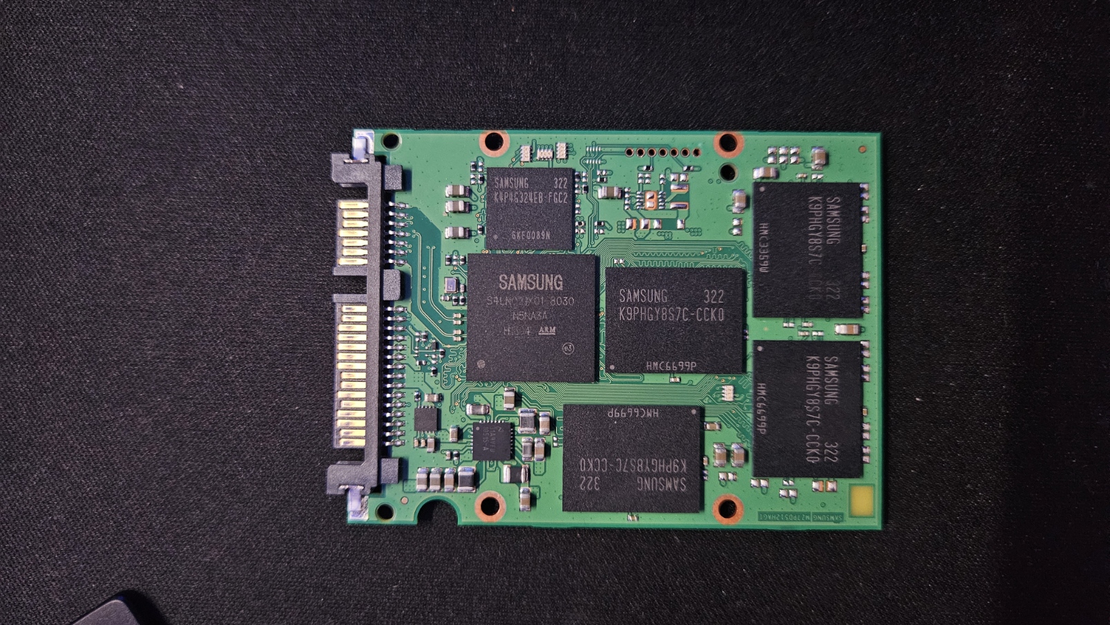

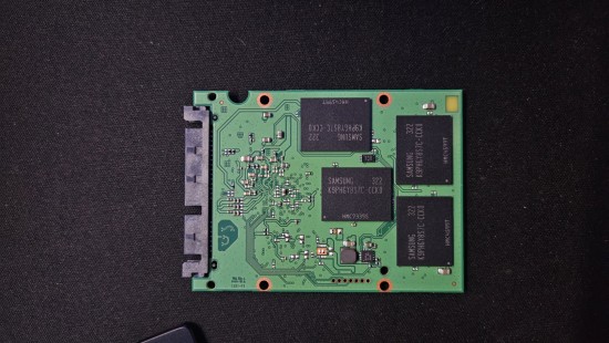

That's a very good idea with the pictures. I attached the front and back side of the drive (I hope it worked). Maybe someone could point out spots to measure voltages. From what I measured the drive pulls about 0.8 - 1W when powered on.

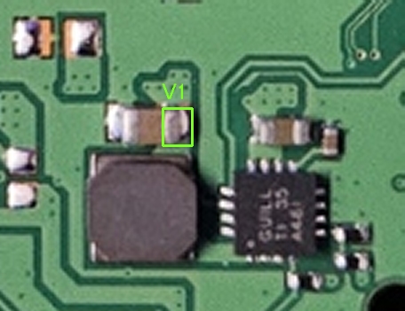

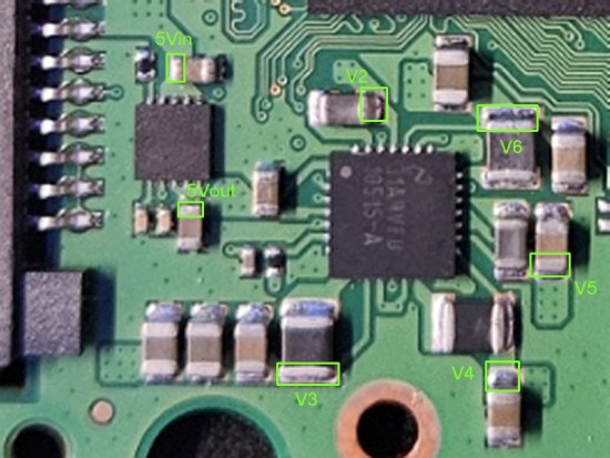

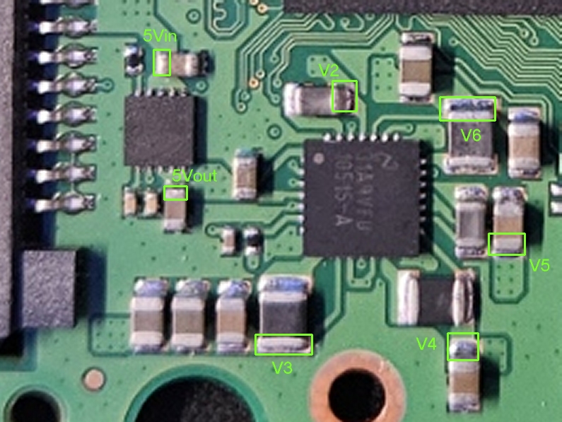

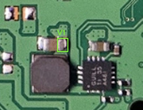

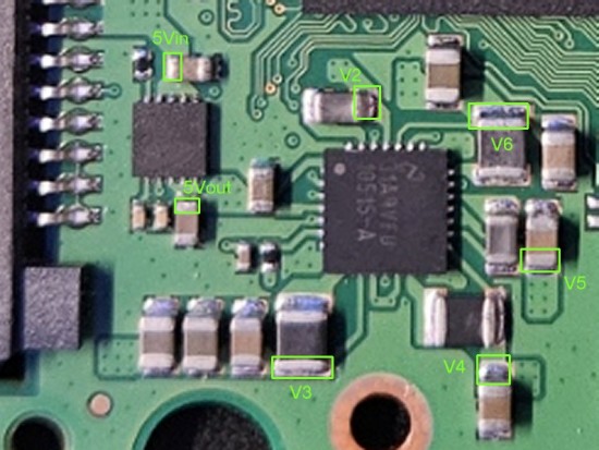

Sorry, I goofed. You can measure the voltages at the following test points.

oh my!!! i am so terribly sorry. i didn't see your reply as it was very soon after my message and then probably didn't send a notification e-mail...
thank you for the help @fzabkar ! it's much appreciated.
so here's what i measured:
- 5V in & out: 4.78V
- V1: 2.93V steary
- V2: 1.8V but occasionally short dip to 1.75V then recovers to 1.8V over the span of about 1 second
--> after measuring everything a second time a minute later it is now stable at 1.8V
- V3: 1.9V steady
- V4: 1.05V steady
- V5: 1.15V steady
- V6: 1.254V steady

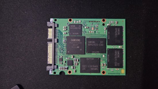

i then opened my known good 840 Pro and measured the same spots just to compare it to a working drive. same voltages. just the 5V rail a little higher as it was plugged into a Sata power plug that was closer to the PSU. the rest is identical.
then, i tried to read the PDF you sent me earlier in order to figure out whether something is wrong with the voltages, however, since they are identical to the working drive, i figured those couldn't be the issue and didn't invest too much time into getting into every detail of said PDF.
